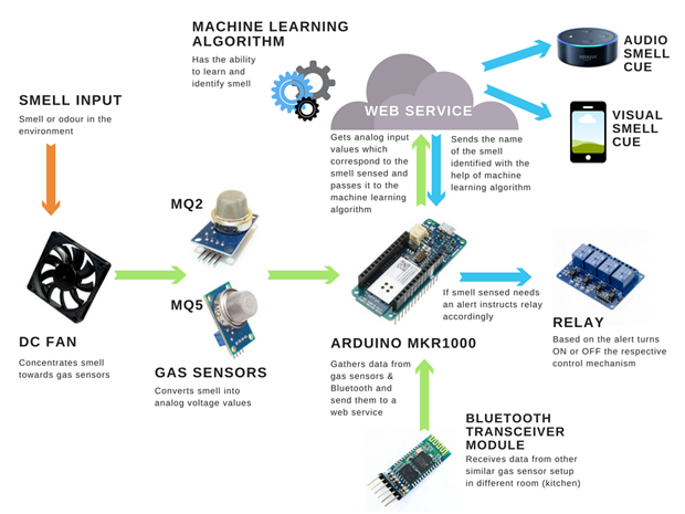

1. Audio & Visual Cue System for Anosmia
    This system will help the people who are suffering from Anosmia. It will be able to give an audio & video cue about the smell identified. Also, based on the smell if an alert is required to be given to the person in the room, it triggers the relay to either turn ON or OFF the control mechanism. A sketch or flow of how the system will be is given below and it is self-explanatory.

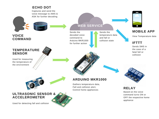

2. Smart Wheel Chair
    This system will be able to provide smart features to a person in a wheelchair. The person will be able to get updates on the real-time temperature of the room in a mobile app. Also, using voice commands the home appliances can be turned ON or OFF. Next, if the person has collided and encountered a fatal fall along with the wheelchair, an SMS will be triggered to a pre-configured number for help! A sketch or flow of how the system will be is given below and it is self-explanatory.
