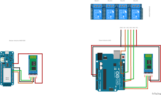

     The ‘Home Appliance Control’ section of the Smart Wheelchair will provide the ability to voice control the power to home appliances like TV, mobile chargers etc. Alexa will listen to the voice command, then process it and pass on the desired action to be taken, to the Arduino MKR1000. The main smell sensing unit will have the Arduino MKR1000 whereas the extra unit will have the Arduino UNO connected to the four channel relay module. The instruction will be communicated through Bluetooth between the master Arduino MKR1000 (main unit) and the slave Arduino UNO (extra unit). In correspondence with the instruction, the respective relay will be turned ON or OFF. For instance, if you command, Alexa, charge my phone, then the relay associated with the phone charger will turn ON and will start charging your phone.

Circuit Connection Diagram
     Below is the circuit connection diagram for the 'Home Appliance Control' section of the smart wheelchair. There are two subsections, the Arduino MKR1000 connected with Bluetooth module acting as master and the Arduino UNO connected with Bluetooth module acting as the slave and four channel relay module. This relay is in turn connected to an extension box with four outlets to plug in the home appliances. Out of the four only three are connected in a way that it can be controlled. The remaining one is for the DC fan of the main smell sensing unit, which will be always ON.
     Reference for: Configuring Master Slave Bluetooth - video
