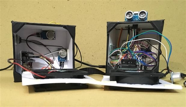

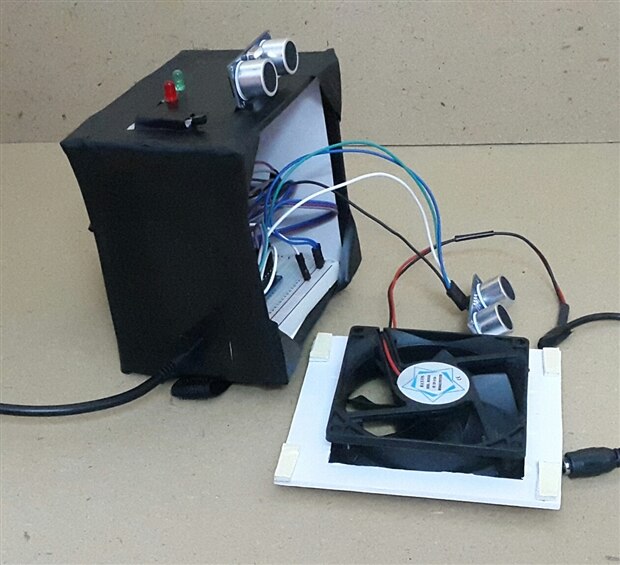

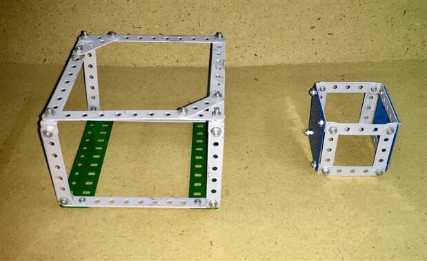

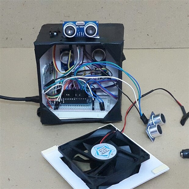

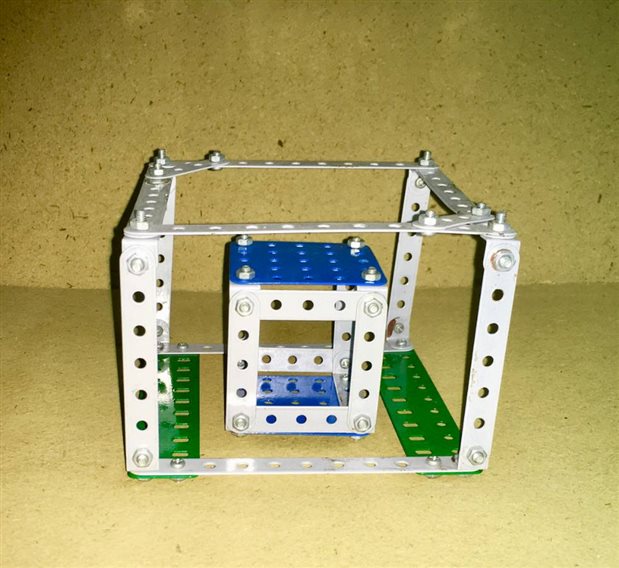

     The Case is made using foam sheets and glued together using Ana bond and Hot glue. Exercise Caution while using Ana bond which is a strong adhesive and you might end up sticking your hands (as I did image and then you have to use hot water and struggle to release your hands for a while). If you have a hot glue gun, I recommend to use it compared to Ana bond in terms of safety. I then wrapped the whole case with insulation tape (black) for a more cleaner look. I generally use Metal Mechanix set to build a case (Previously built cases - Traffic Predictor #5 - Machine Learning and Building a case for the kit and DIY LED Ferris Wheel ) but this time I gave this a try. A 3D printed case will be costlier compared to the cases built using foam sheets or Metal Mechanix and it also takes time to build. However, the end result of a 3D printer will be better in looks and strength. (Another reason for not using a 3D printer is that I don't own one to play around).
     Below are the photos of the case made from Metal Mechanix set for the extra and main smell sensing units of my project initially. Then I switched to use the case made using foam sheets for my project.
{gallery} Mechanix case
Photo #1: Cases made from Metal Mechanix set
Photo #2: Cases made from Metal Mechanix set

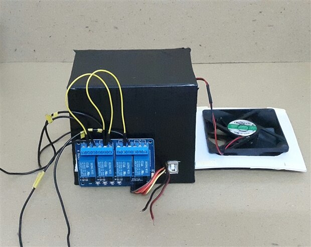

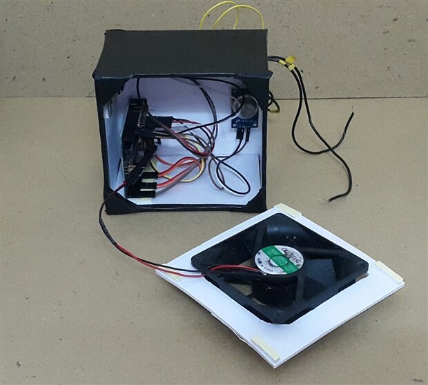

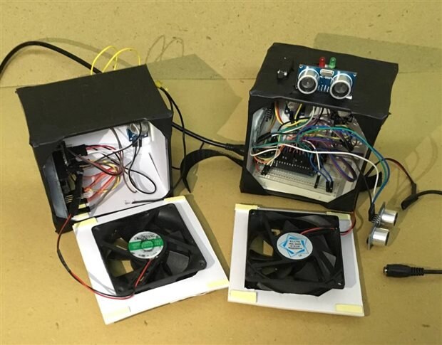

     Below are the photos of the case made with foam sheets for the extra and main smell sensing units of my project,
{gallery} Cue-based System for Anosmia and Smart WheelChair - Hardware
Case Pic #1: Photo of the main and extra smell sensing unit (Semi Top View)
Case Pic #2: Photo of the main and extra smell sensing unit (Front View)
Case Pic #3: Photo of the main smell sensing unit with Smarts for wheelChair (Front View)
Case Pic #4: Photo of the main smell sensing unit with Smarts for wheelChair (Side View)
Case Pic #5: Photo of the extra smell sensing unit (Front View)
Case Pic #6: Photo of the extra smell sensing unit (Rear View)
