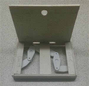

Hans and the woodcutter assembled the planks to form support frame for Matilda's mechanics. The woodcutter liked the minimalism of the wooden design, "everything should be made as simple as possible, but not simpler" he said before returning to the forest.
Hans and Matilda cleaned up the parts from the Blacksmith and polished the axles before putting them together with the screws. They checked that everything ran smoothly, some minor changes would be needed but the mechanism provided the motion that was desired.

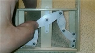

After their lunch Hans and Matilda decided to test the servos. They had a large servo with a long horn and a very small servo with a small horn. Hans wanted to know the current consumption and Matilda wanted to know if they had enough torque to move the mechanism. Before starting their test they downloaded the latest Arduino IDE.
To make the testing easier Matilda mounted the servos on a simple wooden test platform. Following the woodcutter's hint she connected these up to the test mechanism using bendy connecting rods.

    mcb1 over 11 years ago
    It's coming together.
    I see with the new servo library that you cannot interrupt it.
    So limit switches would need to cut the power to protect the servo ...
  • Workshopshed
    Workshopshed over 11 years ago in reply to mcb1
    I plan to have the range of motion well within the limits of the servo, probably only using 90° movement. However, I will also likely have a power kill option for the servo so I can maximise battery life.
    I'm not adverse to customising a library if needed, it would not be difficult to add a Stop method, and I need to review what happens on powerup.
