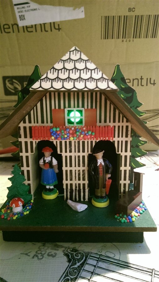

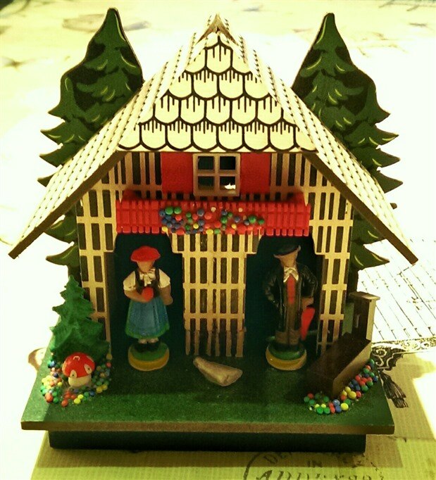

Enchanted Cottage: Before it was taken apart.

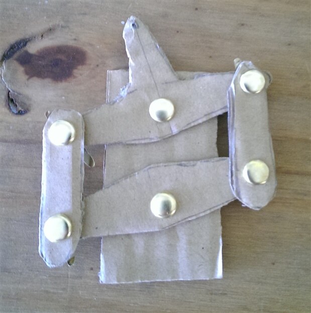

Mechanical Prototype: Cardboard and brass tacks

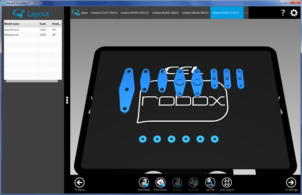

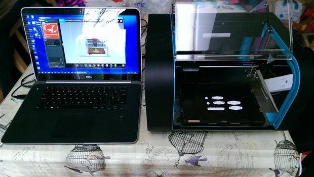

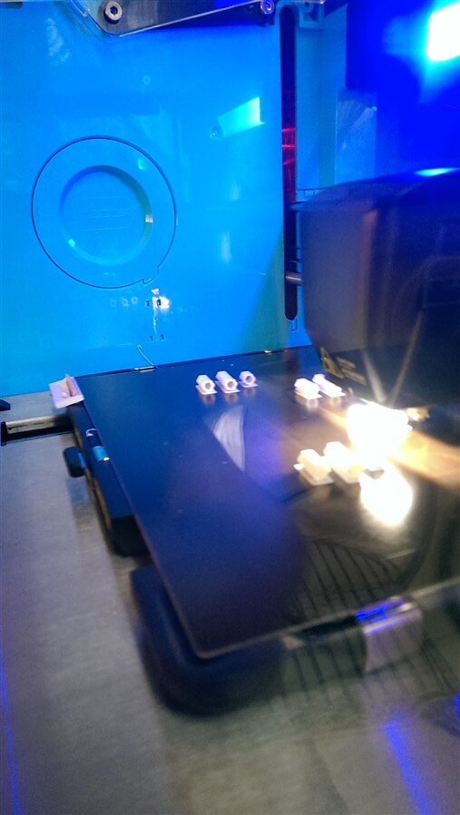

Multiprint: Printing lots of parts for the mechanism

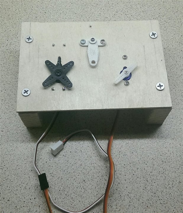

Test Jig: For testing servos

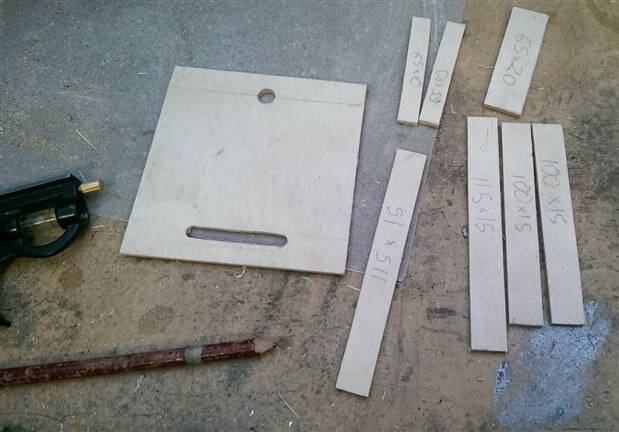

Planks: Initial pass at the frame parts
Printing: Printign the mechanism

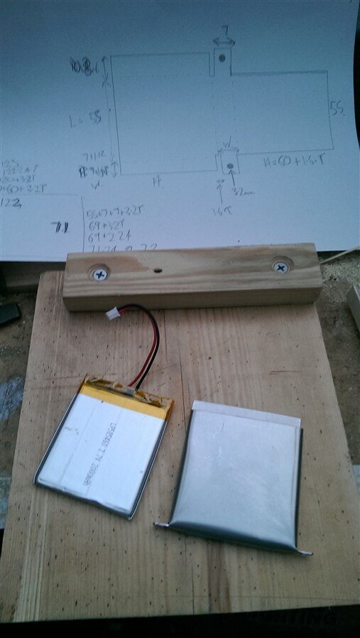

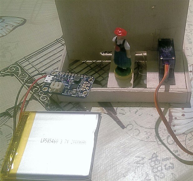

Battery Delivery: Matilda checks out the new battery

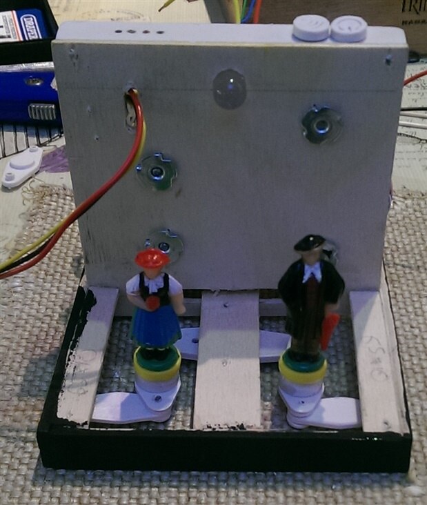

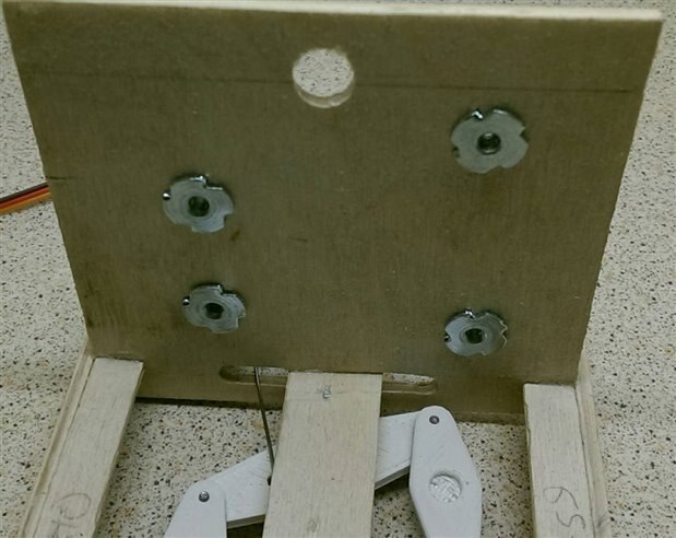

Captive Nuts: Nuts to support rods to support PCBs

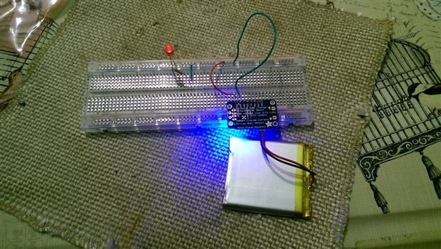

Battery Test: Testing the battery

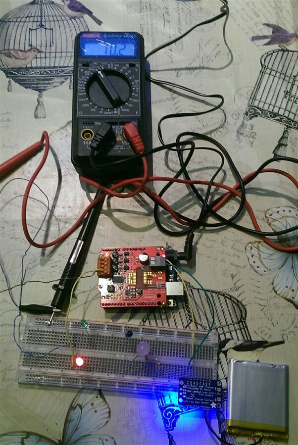

Infineon Low Power: Testing low current options with the Infineon RGB Shield

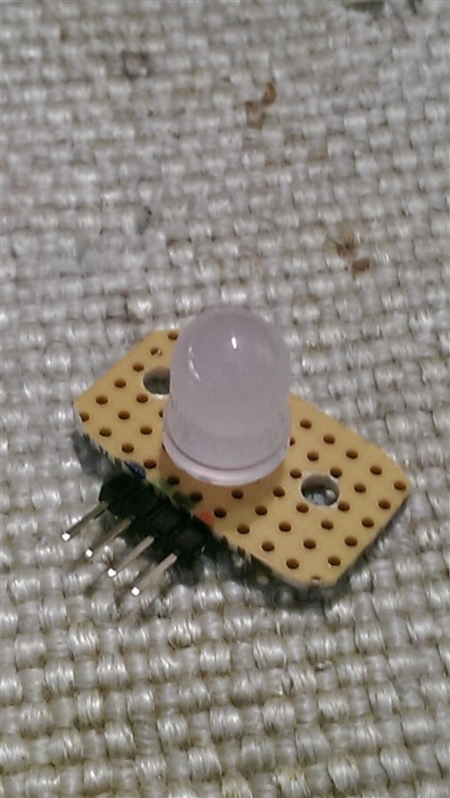

LED: A mini PCB

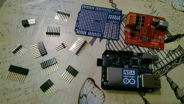

Pins: Pins and Headers

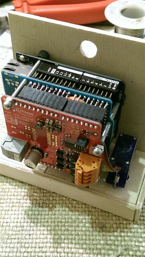

PCB Stack: Test Fitting

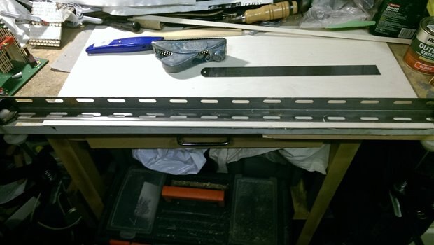

Battery Box: Folded stainless steel

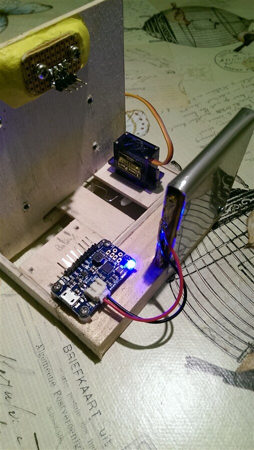

Battery Board: Testing the board

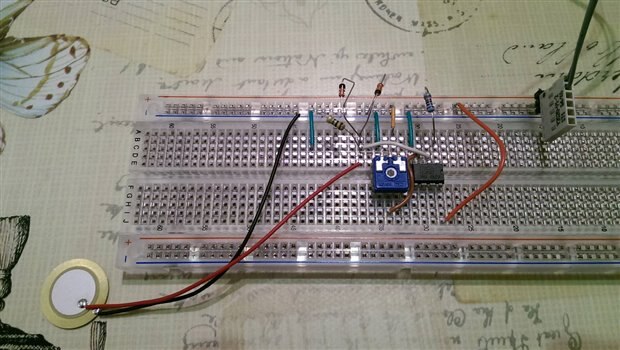

Knock Knock: Testing the sensor circuit

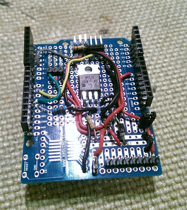

Protoshield: Surely I can fit more on it than this...

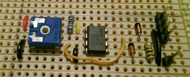

Knock Knock: Now on stripboard

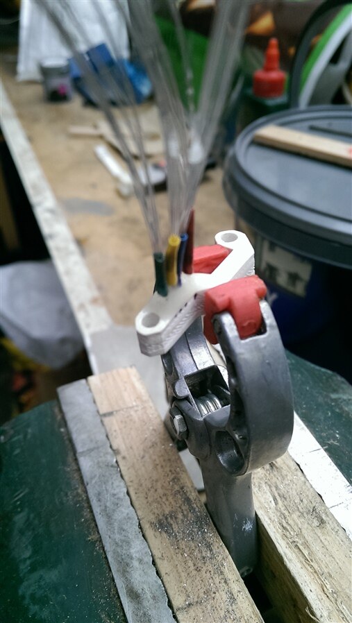

Fibre Housing: With fibres

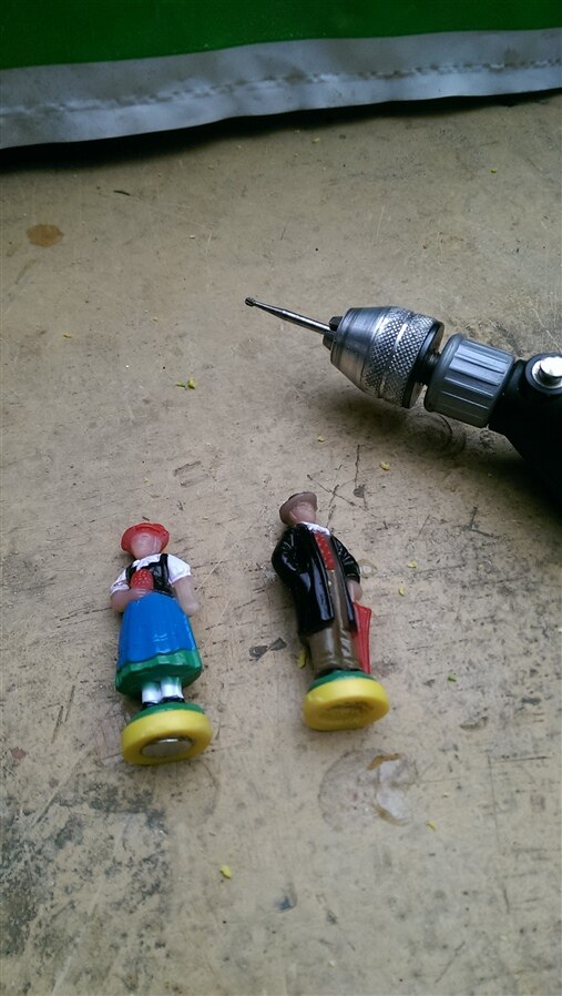

Just add magnets: Hans and Matilda get an upgrade

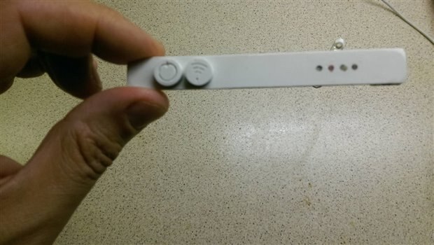

Top Panel: Buttons and lights

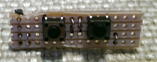

Buttons: Circuit board for the top panel

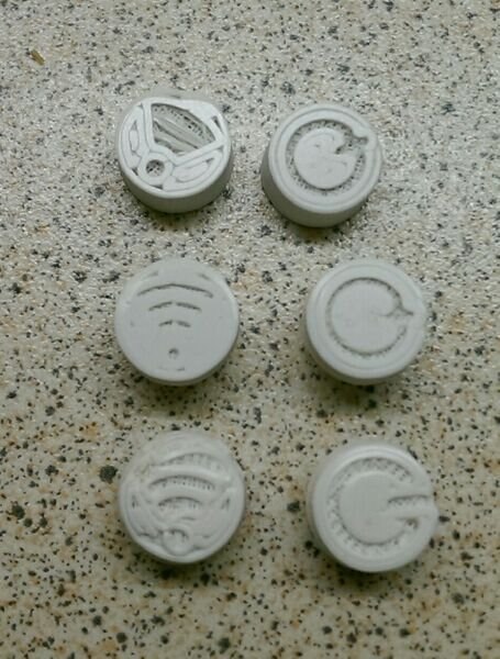

Fail: When buttons go bad

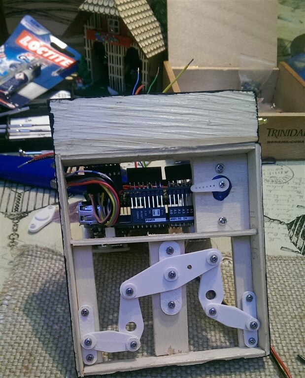

Magnet Carriers: The new mechanism

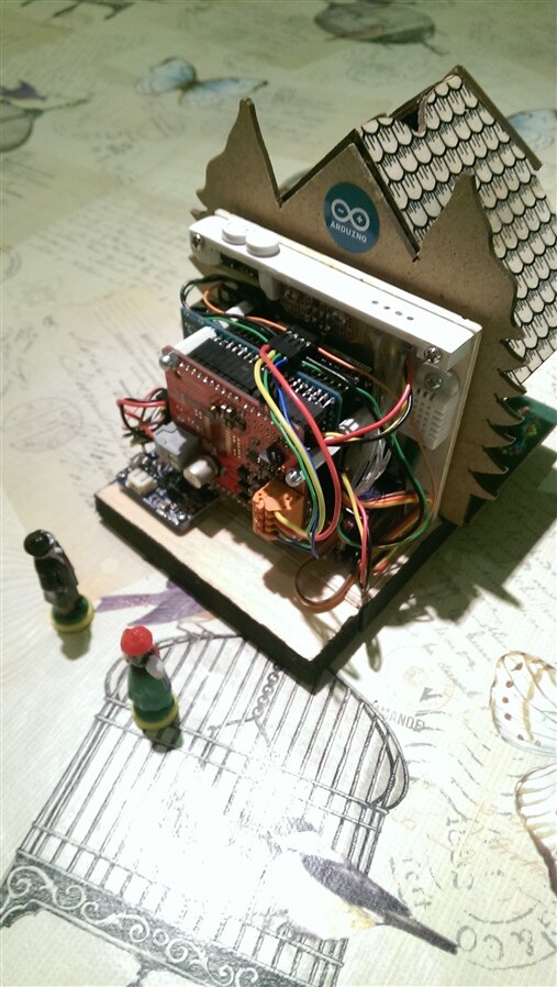

Electronics: Hans and Matilda admire the finished electronics

    Thank you Andy, as I have no idea of what the name is I wasn't able to search for them. It is the first time I see them. Enrico
  • Workshopshed
    Workshopshed over 11 years ago in reply to mcb1 +1
    Yes, I have used those, I like how they thread in using an Allen key. Actually thinking back it was those I used for the grinder, not captive nuts.
    balearicdynamics over 11 years ago in reply to Workshopshed +1
    Maybe this sounds strange to you but now I have clear what you meant. Thank you. I have used this stuff but no idea that there was also something in a smaller scale. Enrico
    Enrico
  • Workshopshed
    Workshopshed over 11 years ago in reply to balearicdynamics
    These are a bigger version if you are building full sized houses
    Joynerbolt
  • Workshopshed
    mcb1 over 11 years ago in reply to Workshopshed
    Have you seen this range of thread inserts for wood.
    http://www.edlfast.co.nz/products/index.php/nuts.html?cat=3427
    They come on various size threads from M4 to M8.
    The unflanged have not lip so can be wound down below the surface.
  • Workshopshed
    I also used some larger ones to clamp my grinder to the bench with some large bolts, it avoids the need to get a spanner into tight spaces and they can be thinner than regular nuts.
