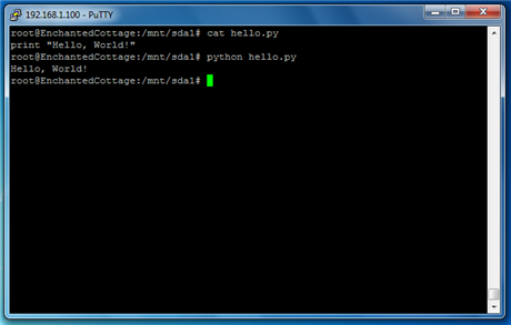

When Hans tried to install this, the Yun ran out of space. "No space left on device". So he followed the instructions for mounting the file system onto an SD card. http://www.arduino.cc/en/Tutorial/ExpandingYunDiskSpace. After making space for the tools used to expand the disks he succeeded expanding the disks and returned to installing pip.
To prove his concept would work he created a simple demo.
import requests, json
print 'Getting Weather'
weather_url = "https://query.yahooapis.com/v1/public/yql?q=select%20item.condition.text%20from%20weather.forecast%20where%20woeid%20in%20(select%20woeid%20from%20geo.places(1)%20where%20text%3D%22Chicago%20IL%22)&format=json&env=store%3A%2F%2Fdatatables.org%2Falltableswithkeys"
r = requests.get(weather_url)
print r.status_code
j = json.loads(r.content)
print j['query']['results']['channel']['item']['condition']['text']

root@EnchantedCottage:/mnt/sda1/Python# python GetWeather.py
Getting Weather
/usr/lib/python2.7/site-packages/requests/packages/urllib3/util/ssl_.py:79: InsecurePlatformWarning: A true SSLContext object is not available. This prevents urllib3 from configuring SSL appropriately and may cause certain SSL connections to fail. For more information, see https://urllib3.readthedocs.org/en/latest/security.html#insecureplatformwarning.
200
Rain
