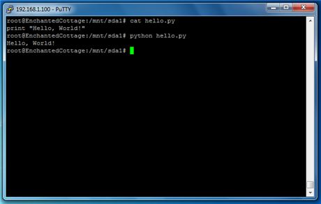

The next morning Hans was working on the Arduino Yun, he realised that both the parsing of the weather data and also security checks could be handled in Python on the OpenWRT side of the Yun.
Hans thought that the Python script could return a simple string representing the weather, either success or an error with precipitation and temperature as additional parameters.
Message formats:
OK!,Cloudy,4,12.5
ERR,Timeout,0,0.0
He also confirmed that python already installed on the Yun.
Hans looked at the different options for reading an API and the requests library looks to be a good solution. It was straight forward to install this on the development machine.
pip install requests
To install it onto the Yun required a little more effort as PIP is not installed.
opkg update
opkg install distribute
opkg install python-openssl
easy_install pip
When Hans tried to install this, the Yun ran out of space. "No space left on device". So he followed the instructions for mounting the file system onto an SD card. http://www.arduino.cc/en/Tutorial/ExpandingYunDiskSpace. After making space for the tools used to expand the disks he succeeded expanding the disks and returned to installing pip.
To prove his concept would work he created a simple demo.
import requests, json
print 'Getting Weather'
weather_url = "https://query.yahooapis.com/v1/public/yql?q=select%20item.condition.text%20from%20weather.forecast%20where%20woeid%20in%20(select%20woeid%20from%20geo.places(1)%20where%20text%3D%22Chicago%20IL%22)&format=json&env=store%3A%2F%2Fdatatables.org%2Falltableswithkeys"
r = requests.get(weather_url)
print r.status_code
j = json.loads(r.content)
print j['query']['results']['channel']['item']['condition']['text']
Not a perfect result but definitely a few steps in the right direction.
root@EnchantedCottage:/mnt/sda1/Python# python GetWeather.py
Getting Weather
/usr/lib/python2.7/site-packages/requests/packages/urllib3/util/ssl_.py:79: InsecurePlatformWarning: A true SSLContext object is not available. This prevents urllib3 from configuring SSL appropriately and may cause certain SSL connections to fail. For more information, see https://urllib3.readthedocs.org/en/latest/security.html#insecureplatformwarning.
200
Rain
Now it was just a case of dealing with the InsecurePlatformWarning, handling timeouts and network errors, parsing the JSON and passing in the correct location code.
