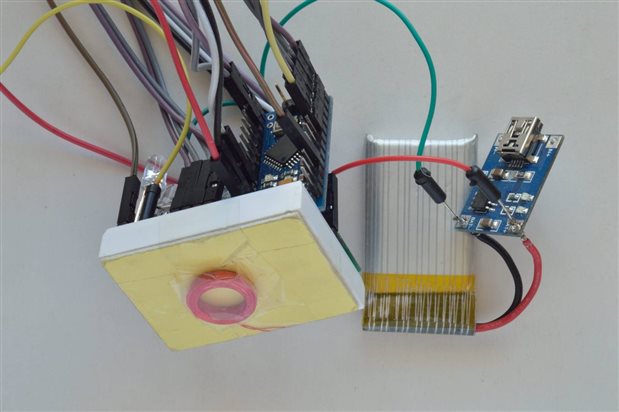

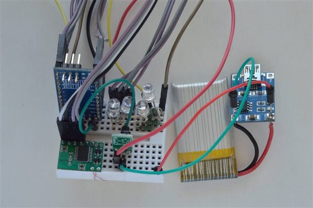

Many readers require 5v, and for our project to assist the elderly, we used a boost converter to raise the LiPo 3.7v upto 5v.
     photo source 3 minions (me, myself and I)
In this image the reader is in the lower left, while the 5v out boost module is to the right.
The USB charger for the LiPo is on the right side, and an Arduino Nano is standing vertically.
This image shows the antenna attached to the bottom.
This unit was used to determine the read distance of the card and tag against various surfaces.

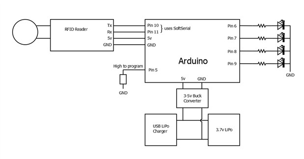

The block diagram shows the interconnection, and I've attached the sketch at the end.
The credit for putting it together along with the sketch goes to Morgan, who was also mentoring the students.
How does it work.? image
When the reader detects a card, it sends the information out the Tx pin.
The Arduino uses SoftSerial ( Arduino - SoftwareSerial ) to read Pin10 and process it.
In this case it matches the card number against 4 stored cards in the EEProm, and lights the appropriate LED.
If the card is not one of the 4 stored card numbers, then it cycles through each LED to indicate it did something.
Is that it.? image
Well yes it is that simple.
The rest of the circuitry simply provides a charging solution for the battery, and a booster to bring it up to 5v.
The design was a portable handheld reader, so the final production would be a single board and could be smaller.
