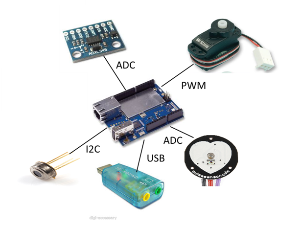

The magic hat will be made up the following components
1. a Arduino Yun board: the core of the magic hat
2. a USB sound interface
3. a servo control to make the hat bend
4. a IR thermal sensor, like the MLX90614. Melexis' MLX90614ESF-BAA is an infrared thermometer designed for non-contact temperature sensing. An internal 17-bit ADC and a powerful DSP contribute to the MLX90614’s high accuracy and resolution. It has a huge number of applications including body temperature measurment and movement detection.
5. a blood pressure sensor. This is something experimental I'd like to try... I will start from a photoplethysmographic sensor and build an apparatus for measuring blood pressure using a finger cuff
6. an accelerometer: the accelerometer will detect if magic hat is being carried
7. a LED bar to simulate the mouth movements
8. a battery pack to power everything up. Since the Arduino Yun is powered through a micro USB, I will likely use a smartphone powerpack
Here is how the components will be connected

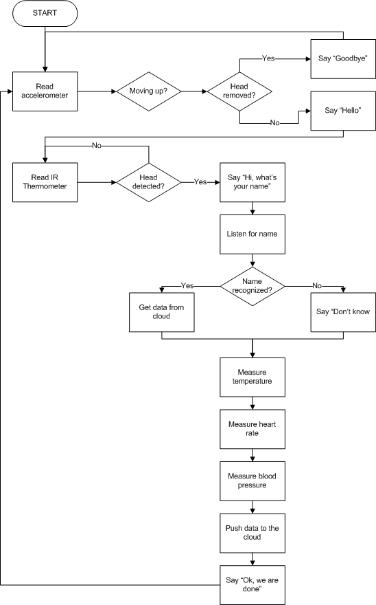

The flow of the whole application is shown in this flowchart

    amgalbu over 11 years ago in reply to shabaz +2
    Hi shabaz I was going to use the melexis temperature sensor because it allows a measure with no need to put it in contact with the skin. However the accuracy is not that good (0.164 °C, which is not good…

    shabaz over 11 years ago in reply to amgalbu
    Hi Ambrogio,
    What a fantastic sensor in your post. I didn't realise such accuracy was possible without calibration. Nice that this IST part comes already calibrated.
    I guess two sensors could be possible too, i.e. a high accuracy one, and the non-contact one if it is impractical to use the accurate one.
