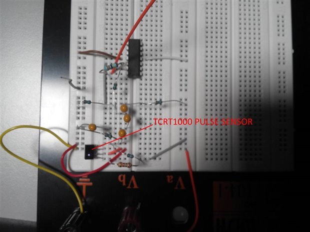

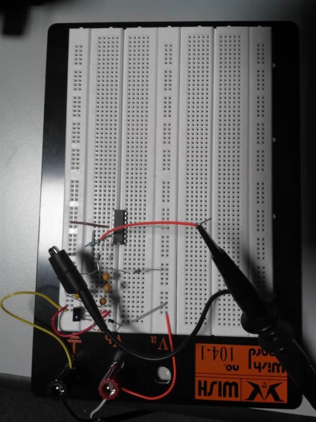

I made some modifications to the original circuit I talked about in my previous post and made it on a bread board. Here is the resulting circuit

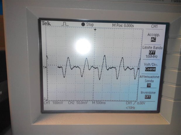

I placed my finger on the sensor, and I got a quite clean signal
The signal is 200 mV peak-to-peak. Since the ADC has a 10 bits resolution over a 5V range, the signal will be read as 80 ADC steps, which should be enough to make heart beat detection easy

    amgalbu over 11 years ago in reply to Workshopshed +1
    Hi Clark Thanks for your comments!! Actually mi idea was to use the Arduino Yun to detect heart-beat (both IBI and BPM). I think there is enough power in the Atmel328 for that task! My only doubt is wthether…

    I was watching the EEV blog the other day and Dave was looking a.t an old speach recognition circuit. That used a comparator to turn audio into a square wave and the frequency was read directly via a digital pin on the microcontroller. Obviously if you are using the SAM to analyse the signal you might do that in software.
    Hi Clark
    My only doubt is wthether to increase gain or not... during my tests I saw that noise increases too, so I think what you see on the scope I the best tradeoff I can currently get. Probably a two-stages amplifier would perform much better
