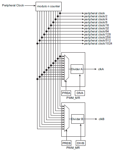

Some of you might have recognized that I omitted one significant detail in the C code in my last post "Use WS2812B on the SAMA5D4 Xplained":
How is the correct PWM clock frequency of 2.4 MHz configured?
Clocks, Clocks and more Clocks
The peripherals of the SAMA5D44 (no, this is not a typo, that's the name of the SOC on the SAMA5D4 Xplainded board) all receive their own clock signal. Relevant for PWM is the peripheral clock as shown in the diagram from the datasheet (page 1448):
Most clocks in the SOC are controlled by the Power Management Controller. Contrary to the name this component does not (only) turn the power of integrated devices on and off, it mainly controls the distribution of clock signals. (By not providing a clock signal to a specific component it is turned off.) The programmer can individually request those peripheral clocks to be turned on or off and can select a division factor to be applied to the boards master clock MCK. The factor can be 1, 2, 4 or 8 and is applied to the master clock.
The frequency of the peripheral clock can be calculated by BOARD_MCK / divider. The divider can be read / set through the PMC_PCR register and BOARD_MCK is defined in board.h. This would be nice and easy to use but would work only in a bare metal environment where the clock can not be influenced by other processes. But since I do not intend to dump the Linux running on the board I have to consider these values as variables. Back to the datasheet. It turns out that the relevant values for master clock are the PMC Master Clock Register:

Generating the desired frequencies
Back to the original problem, calculate the divisors for the PWM clock:
Now that we know the input to the above diagram we can go ahead and do some basic math. To calculate the parameters PREA and DIVA in order to get the desired frequency we have to calculate and factorize the required divider.
divider = peripheral_clock / desired_frequency
split divider in the form  2^prea×diva
Example:
divider = 260
factors of 260: 2^2×5×13
=> prea = 2 and  diva = 5×13 = 65
How is factorization done? The answer is astonishingly simple: do a trial division! Since we only need to know the factor which is a power of two this is further simplified to this:
int calculate_PWM_dividers(int frequency, int *div, int *pre)
    uint32_t mck_div, f;
    int n;
    frequency = abs(frequency);             // no negative frequency
    f = get_periphal_clock_frequency(ID_PWM);
    *div = f / frequency;                    // required divisor
    // split div into pre and div
    // facorization of divider
    // pre -> power of 2
    // div = all other facors
    for(n=1; n <= 10; n++)
        if(*div % ((int) pow(2, n)) != 0) // if not a multiple of 2^n
            *pre = n - 1;         // then it was a multiple of 2^n-1
    *div = *div / ((int) pow(2, *pre));     // new divisor is the rest
Wrap this code nicely in some error handling code and that's it.
