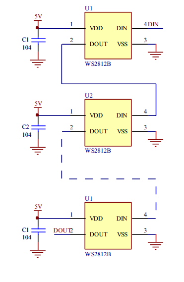

The mysterious signal from my previous post was for a WS2812B LED. It was shown in Fairy Dust has arrived!. It is a RGB LED with integrated controller. The LEDs can be easily chained together:
If you are really crazy you can build something like this with those:
With an estimated power draw of 3 KW image and 10.000 WS2812 LEDs this is really insane.
But back to the lab:

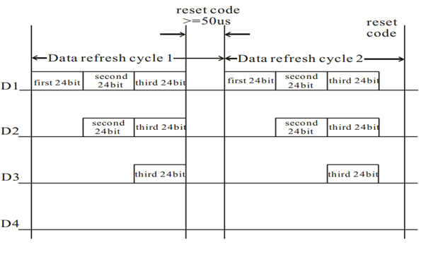

Besides of the power supply the LEDs use only a single pin for data transfer. The data is transmitted bit-wise by the "mysterious signall" with 8 bit per RGB but in GRB order (for whatever reason). After the last LED a reset signal is sent to start all over again. This is shown in the graph from the datasheet:
mcb1 pointed me to a link which gives valuable insight into the timing constraints of the protocol. Bottom line: The timing does not matter much as long as you can make sure that around the middle of the period the DIN line has the correct signal applied. No fancy assembly code needed and no high clock frequencies.

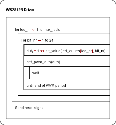

The Basic flow is straight forward:
PWM on the SAMA5D4 Xplained
There are several options to programm the board. Those I evaluated are (form highest abstraction to lowest):
  • Linux driver and API
  • Atmel Software Framework (ASF)
  • Low level GPL API by Atmel
The Linux driver does not support any kind of signaling the end of the period. More capable and less abstract is ASF but AFAIK SAMA5 series is not (yet) supported. So back to the ground level and (allmost) manually programm the registers using the GPL API. The following part of the C-code is heavily commented with information from (mainly) the datasheet. It is not yet ready and definitely not tested. But as it has taken me so long to find all this information it is time to publish it anyway:

This is only the setup part, I have still to find out how to calculate the clock frequency / how to programm prescaler and divider to produce a 2.4 MHz PWM signal.
For the beginning I will poll the WRDY signal to find the end of the period an update the CDTY (duty) register manually. For better (multi-tasking) performance I want to update CDTY in the PWM_IrqHandler (interupt handler).
