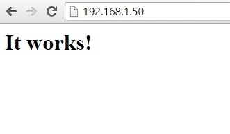

This time I connected the board to my home network.
That wasn't difficult at all.
At first I plugged the network cable from router to board while it had already booted.
The network was detected:

A simple reboot with the cable connected gave me an ip address

I was also able to ping other computers in  my network:
root@sama5d4-xplained:~# ping 192.168.1.27
PING 192.168.1.27 (192.168.1.27) 56(84) bytes of data.
64 bytes from 192.168.1.27: icmp_seq=1 ttl=128 time=91.3 ms
64 bytes from 192.168.1.27: icmp_seq=2 ttl=128 time=4.80 ms
64 bytes from 192.168.1.27: icmp_seq=3 ttl=128 time=2.83 ms
and the board shows up on my router's status page
I was able to connect to the board via a browser from another pc. It shows an "It works!" message (see the first picture).
