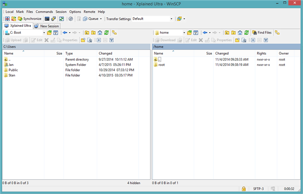

I've been able to connect to the SAMA5D4 with SSH and SCP. This post describes the steps I took to get there.
They are a redo of what Robert Peter Oakes shows in his SAMA5D4 Xplained Ultra - Tips and Tricks #1 - Getting Displays up and Running video,
mixed in with moral support and a nodge in the right direction from clem57.
I've blogged about my first steps with the kit, Review 1: Unboxing and First Steps.
The second review was on cross compilation on a Windows machine: Review 2: Building the Libraries from Source
My third article was to get the board connected to my network: Review 5: TCP/IP running
I downloaded and extracted linux4sam-poky-sama5d4_xplained_hdmi-4.6.
Then I plugged an USB cable in the USB A Device input.
I placed JP7 (BOOT_DIS) and plugged the board in one of my computer's USB connectors.
I opened the device manager and changed the driver for the device to the AT91 USB Serial . On my pc it comes up with a different driver bu default.
I removed JP7.
I edited demo_linux_nandflash_hdmi.bat to set my com port (\USBserial\COM27), and executed it.

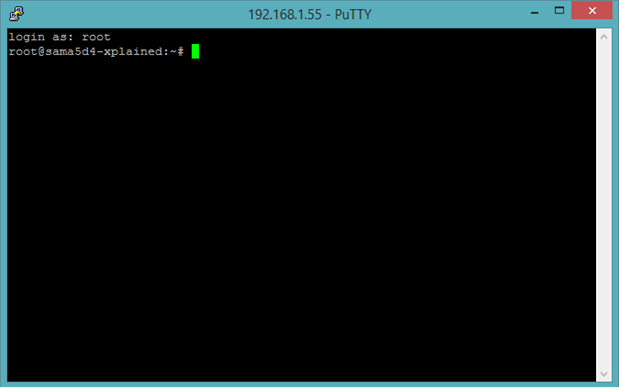

That's it. After rebooting I got this version info:
Linux version 3.10.0+ (josh@melon) (gcc version 4.7.3 (Ubuntu/Linaro 4.7.3-12ubuntu1) ) #1 Wed Nov 5 17:30:56 CST 2014
I can use Putty to SSH into linux, and WinSCP to transfer files.
You just have to accept the server signature the first time you log on, and you're done.
And that's it. Another step to getting executable code on the board.
