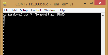

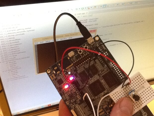

I have my first C++ linux program running that samples the an ADC pin on the SAMA4D4 Xplained Ultra Board.
In the mid 90's, I was a C++ software developer. Around that same time, the standard template library (STL) came into fashion.
It's great to use it once again.
Getting the ADC values
Once again, this is inspired by Robert Peter Oakes's work on this board, SAMA5D4 Xplained Ultra - Tips and Tricks #2 - Using the built in IO and external devices.
I'm using a very similar setup as Peter, but instead of using the Linux command line to read the sample results, I've written a C++ program.
But we're both triggering a sample and reading results by accessing /sys/bus/iio/devices/iio:device0/in_voltage0_raw.
The schematic is very simple: a potentiometer with both ends connected to ground and 3.3V of the Xplained board. The wiper goes to A1.
To make things funny, A1 is analog port 0 in the linux mapping. (I don't know yet what A0 is, but it has a digital signal on it when I sample it with my scope.)
The program is cross-compiled using the GNU toolchain on a windows machine, loaded to the linux root user's home folder, and executed.
It shows a sample result in the terminal window every second.
I haven't used any of the Atmel libraries. All is done via standard file access.

That's the whole program. After compilation, linking, uploading and setting the executable flag, here's what it looks like in the terminal:
The value changes when moving the potentiometer wiper.
