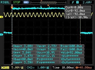

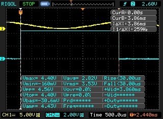

The Organ uses Fast Fourier Transforms to turn the sampled audio signal into buckets of audio frequency spectrum. In this design, 128 samples are turned into 64 buckets, from the low side to the high side.
Bright minds may be able to do the full calculation of the covered bandwidth based on my scope's screen capture.
The high part of the blue signal indicates how long one sample burst takes. And I take 128 samples each time. Post the calculations in the comments, please.
SAMA5D4  92ms / 129 samplesimage
ARDUINO 3.86ms / 128 samples
I made a mistake here and measured* the inner time between two samples instead of the time to take 128 samples. Below is the old capture that shows the wrong info.
This changes the picture a bit, because the sample time is now longer than on Arduino, and I'll have to optimize code instead of adding _nops.

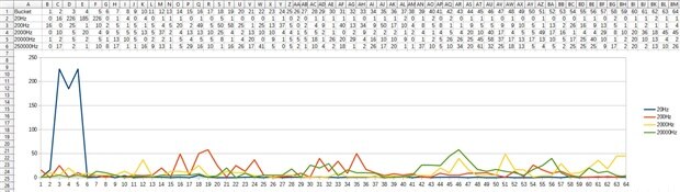

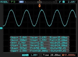

I've recorded the FFT result of a 20Hz, 200Hz, 2kHz a,d 20 kHz signal. My program printed the resulting spectrum array on the linux console.

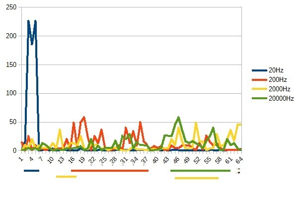

Here's a chart of the results. It's not yet a very good outcome. 20Hz and 20 kHZ give an outcome as expected, at the low and high side of the spectrum.
But I'm not yet satisfied with how the 200Hz and 2kHz signals are calculated. The 2kHz has peaks lower in spectrum than the 200Hz signal.
Since I used a clean sinus wave as input, this shouldn't happen.
The plot below, based upon the four tests, shows that the situation is rather fuzzy in the middle part. You can also see a huge peak of the 20kHz signal.
The skew in my results may be based (is very likely based) on the sample speed. In particular the 2kHz signal behaves badly.
I'll try to slow it down* speed it up and get to the same sample speed as the Arduino. That'll give better results.

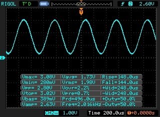

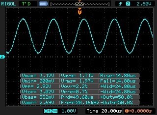

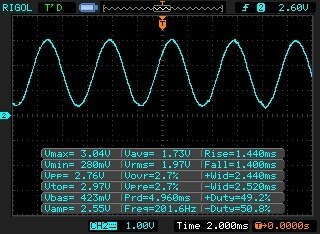

These are the captures of the four input signals, taken while doing the exercise:

* I made a mistake in my time measurement for sampling. On the Arduino I measured the time to take 128 samples, on the SAMA5D I measured the time to take one sample.I've corrected the post, but left the original info in place for reference.
