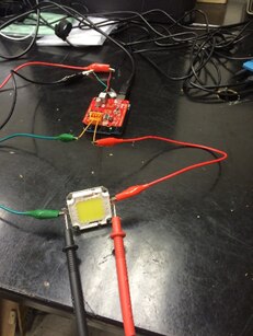

The week was full of rain and clouds for the poor genie all week. Unable to leave his house and make any progress on the things that needed to get done, due to the unfortunate consequences of doing your electrical work in the rain, but today the sun peeked out from behind the clouds and shone with the brightness of 2000-2500 lumen. It was magnificent! However, shortly after its arrival, the clouds took over again . But while the sun was out the genie made headway on his electrical wiring of his sweet new crib. He set the power supply to roughly thirty volts and tested out his lights to see if they worked.
And it worked! How excited the genie was! This was a huge step in the right direction with the build of his new pad. Now all that was needed to be done was wire it all up to his sweet new dimmer and you could call him Xzibit Jr.
WAIT! There is no light!!!! What in the world is going on? No explosions, check. No fire or smoke, check. Then what? The genie checked the voltage coming out and the light intensity and found:
But that doesn’t make sense! 30 Volts in and only a 100th of that out? How could this be? The genie has yet to figure this out, but he will be working diligently over the weekend to figure out a solution!

    RParkerE over 11 years ago in reply to mcb1 +3
    I found the culprit and it was much simpler than assumed. I had a poor connection, after I soldered the pins it worked perfectly fine. I am working on my next update now

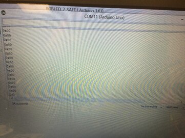

    Can you post your code?
    Please use the >> symbol and choose Syntax Highlighting then C++.
    I'll see if I can duplicate it.
  • RParkerE
    The issue is I am unable to reach the loop method. It gets stuck in the setup method and will loop over a single function in that. I assume the board is not responding because it gets stuck in the while(on != 1) loop which checks if it is responding. I am not sure how to solve this issue.
  • RParkerE
    RParkerE over 11 years ago in reply to ipv1
    So I tried your code as well as the code Infineon provides. And for some reason I am unable to enter the loop function, it will not exit out of the setup. When using your code I even attempted to comment out the entire setup method and run it and it still will not reach the loop function I am very confused.
