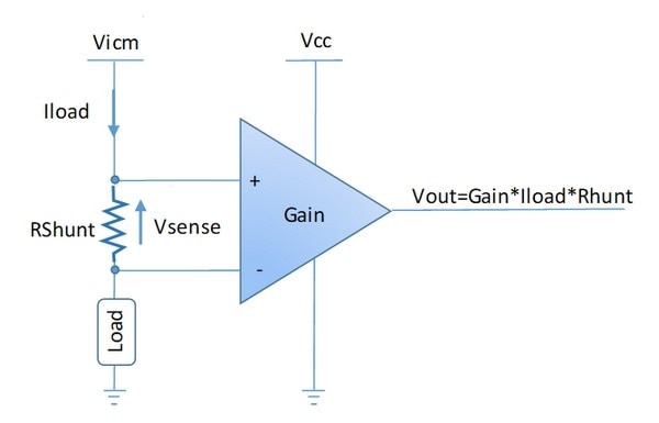

What is a Current sense amplifier?
The simplest technique for measuring current is to insert a small resistor, also called a current shunt, in series with the current to be measured. The voltage across the current sense resistor is measured, and the current is computed using Ohm’s Law based on the known value of the resistor. This method has the advantage of simplicity, low cost, and linearity. As the current measurement is based on calculating the voltage drop across shunt resistors used as current sensors the accuracy of the measurement depends on the accuracy of the resistor. So, the selection and placement of these shunts and the associated current sense amplifiers are critical to proper power distribution and efficiency.
A current sense amplifier is a special purpose integrated circuit differential amplifier that is designed to sense the voltage developed across a current shunt and output a voltage proportional to the measured current. The voltage across the current sense resistor is typically in the range of 1 to 100 millivolts, but may ride on the nominal bus voltage potential. The CSA is designed to have a high common-mode rejection ratio (CMRR) to eliminate the bus voltage from the output. These devices are designed to handle common-mode voltages in excess of their own supply voltage.
The choice of the current sense resistor must include attention to the resistor’s accuracy, temperature coefficient of resistance (TCR), and power rating. The resistance value determines the voltage drop across it for a given current value. It also determines the power dissipated by the sense resistor. Generally, the sense resistor’s value is a fraction of an ohm. Specialized resistors are available for this application. These resistors use metal elements in the form of plates, foil or film, or deposited thin or thick-film hybrid elements.
Difference between Current Sense Amplifier and Normal Amplifier
Normal amplifiers and current sense amplifiers have different specifications and they are made for specific things. There are many types of Op-Amps, you can read this article to know the popular Op-Amps IC and their applications. Normal amplifiers could not amplify a very small amount of voltage and have low CMRR. On the other hand, precision current-sense amplifiers could detect and amplify a very small amount of voltages as well as the CMRR is relatively high.
For the normal differential amplifiers or standard operational amplifiers, the power source is connected between two power supply rails (Vcc and Vee) and the amplifiers can only operate on the signals that lie behind the power rails or have common ground paths. An outside voltage of the used power rail could trigger the internal ESD protection diodes if an external voltage is applied to the input pin of the standard amplifier and could cause a large current to flow. But, current sense amplifiers are designed in a way that despite the low-voltage power rail (such as Vcc = 3.3 V and V = 0V), the amplifier can withstand a much higher pin voltage than the supplied Vcc. The amplifiers use an excellent power path protocol for their operation. Whenever the input voltage is lower than the VCC, the amplifier changes its input supply and gets powered by the input voltages.
How does a Current Sense Amplifier Work?
The working principle of a current sensing amplifier is based on Ohm's law. When load current flows through a shunt resistor (Rshunt) present on inputs, it generates a voltage drop called VSENSE. This voltage is generally small to limit power dissipation losses. VSENSE is then amplified with an internal current sense amplifier. The resulting output voltage (VOUT) is a voltage that is proportional to the Ioad current. It can then be processed with an ADC (analog-to-digital converter).
