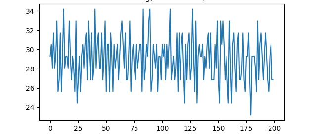

After measuring the current on the high side and low side I tried to measure the current consumption of an ESP8266-01 module. I did the experiment in different situations. First I tried to measure the current-sinking by ESP8266-01 only for powering an LED. WiFi was disabled and esp was powered from 3.3V supply. This is the circuit connection:
When GPIO 2 LED was on I got the following graph. The average current was around 29mA.

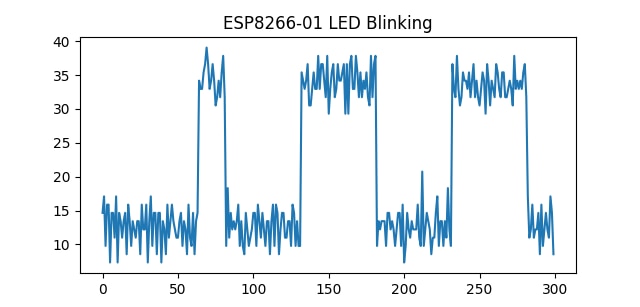

Then I program the ESP8266-01 to blink an LED every 100mS and I got the following graph. The graph is very logical and it is clear that when LED is ON the current is around 20mA higher.

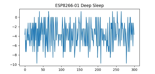

Finally, I tried to measure the deep sleep current for ESP8266-01 which is around 20 uA. But the measurement result made me frustrated. It shows a negative measurement for deep sleep.

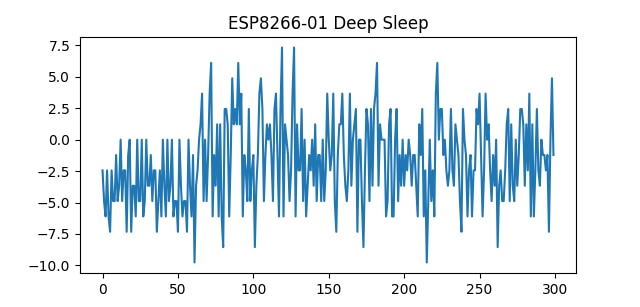

In the misaz library, the input range was set to 50mV and this is not configurable. So, I manually configure the input range to 10mV but no such improvement was observed. The result follows when the input range is 10mV.
So, the 10mohm shunt resistor is not enough for very low current measurement when the current value is less than mA. It can be tested with a higher shunt.
