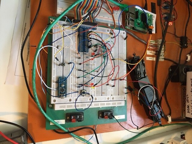

With the python library, misaz shared in his blog post, I can continue with my challenge testing.  My initial tests of the sensor are using the locomotive on the bench. I have been using 3VDC, 5VDC and 12VDC to set some expectations before moving to the rail tests.
I still try and follow the process my electronics lab college instructor tried to instill in us 40 years ago. Have some idea of what the measurement should be, before you go poking around with testing equipment making measurements. I had no success getting current measurements using my Fluke VOM so I only have what the sensor is providing.

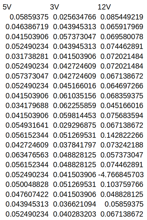

The python script generates a current & voltage reading every five seconds. The initial voltage applied to the locomotive motor is 5VDC, then changes (highlite) to 3VDC and then to 12VDC.
My question to the sharper electronic knives in the drawer than me is, do the current values look reasonable?
The current reading moves between.05 to .09, the average, throwing out the negative values in the calculation, is .06. I was expecting higher current values at the higher voltages. What I interpret from the current reading is a motor that is an active load where the resistance changes to ensure a steady current. That doesn't seem correct?

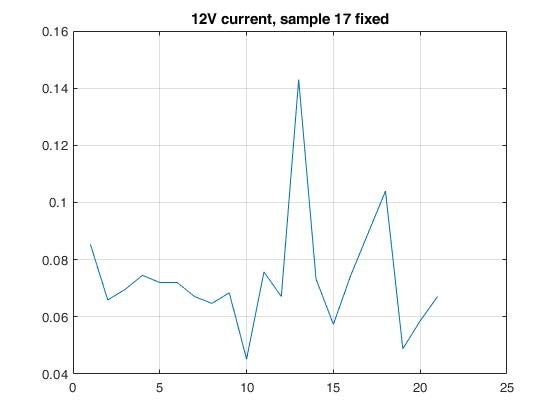

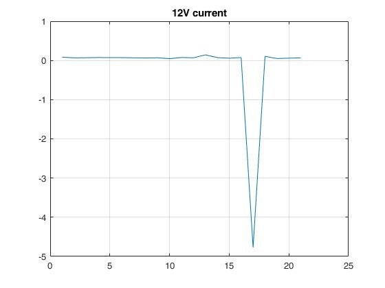

    I copied your 12V data into MATLAB and plotted it :
    Then I fixed result 17 by setting it to the mean of sample 16 and sample 18.
    The mean of the fixed data is 0.0735 and the standard deviation is 0.0204.
    In measuring science that counts as dreadful.
    The signal to noise ratio is about 11 dB.
    To put it into context - the 12 bit converter in the Maxim chip should easily give you 10 good bits, at 10% of full scale that would be a resolution of 1024/10 = 102 so we should be expecting a standard deviation of about 1% of the mean and a signal to noise ratio of about 40dB.

    (If you post any more data can you plonk it as text in the post or as a file attachment - if it's in a picture I have to copy it into MATLAB by hand.)
