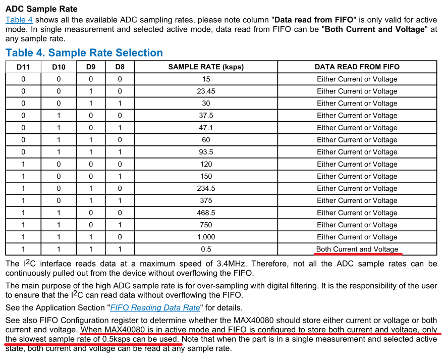

    misaz over 4 years ago in reply to michaelkellett
    Both Python anb C Library suppoort configuring digital filter. Maximum value of digital filter (128) eliminated almost whole noise in my case of sensing current flowing simple resistor on breadboard.
    In case of Python Library colporteur can try replace configure call by this one:
    max.configure(digital_filter=128, measure_current=True, measure_voltage=True)
  • misaz
    misaz over 4 years ago in reply to colporteur
    Error Sample rate must be 0.5 when measurement of both current and voltage is selected. is restriction of sensor. See this section in datsaheet:
