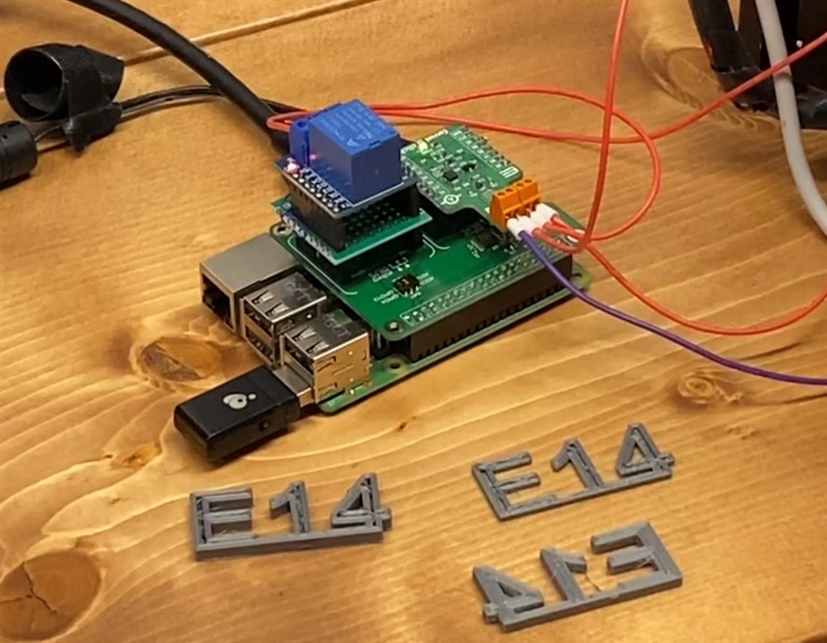

In my final post for this build, I'll share my working project and some thoughts I've had along the way.
What did I build?
imageUsing the Current6Click current monitoring board mounted on a Pi3 Click Shield, and mounted on a RaspberryPi, I was able to build something which can detect wiring faults. The Current6Click board uses a MAX40080 current sense chip and comes as a ready-to-go expansion board with shunt resistor and other supporting circuitry. The goals were to be able to detect intermittent opens in the wires going to the hot end and heated bed on a 3D printer. Opens and Shorts can also be detected.

How does it work?
The MAX40080 can measure both current and voltage at the same time. A 3D printer cycles power on and off to the hot parts to maintain a target temperature. This means that whenever there is voltage available, current should be flowing. My code first sees if there is voltage; then it reads the ADC at about 500 times/second and monitors the current. On the hot end of my printer, we should have about 12 volts and flow about 2.75 amps. If there is a fatigued or damaged wire, there would be a very intermittent open circuit where the MAX40080 can see 12V but current drops to zero. In the case of a short, the current would spike very high very quickly; still at about the 12v level. An open circuit would look the same as the intermittent, but last longer. Most printers these days come with 'thermal runaway monitoring' in software, but some don't; and some aren't turned on by default leaving it up to the user to know and enable the feature. That feature however works by monitoring the temperature feedback and the software's own output to run the heaters. If the thermocouple shows the nozzle getting colder and not heating up when the controller is trying to heat it, this causes the alarm.
However, in the case of a fatigued wire or loose connection, this would never be caught. Unfortunately, these bad connections are a potential fire risk as more current has to flow through the few remaining strands of copper or the little bit of connector that is touching a terminal. This causes excessive heat buildup which can cause lots of other issues. Short of adding a thermal camera, there really isn't a way to directly look for poor connections. Imaging a printer that's been in service for a few years and 1000's of hours. There could be certain parts of the travel that stress the wires just that little bit more and break it down.
I've had this idea rolling around in my head to detect a wiring fault on these large current-carrying wires in a printer for a while. I had originally though of doing it via discrete components - a traditional op-amp & shunt resistor; running the voltage through a comparator and AND'ing with the 12V signal. When the voltage rises above the level set in the comparator, it would open a relay to signal a fault. This MAX40080 can read very fast and still seems to do the trick just fine, and I found that it was pretty easy in software to tweak values and setpoints and add other integration like MQTT.
The latest updates to get this puppy running
My previous post showed the system nearly complete. The RaspberryPi was talking to the Click board and getting measurements. I was able to detect shorts, opens, and broken wires. I was using an external relay on an Arduino to cycle ON/OFF the 12V feeding into my project to simulate a printer cycling the hot end; plus using a DC load to pull current. I still wanted to add MQTT support and that wasn't done yet. The major issue I had run into was that about 5% of the time, when the Arduino relay clicked off, my system would detect a "fault" because the current would drop to zero somewhere around 50ms before the voltage would drop out.
In this latest post, I was able to overcome that. I put a check in the code to flag these bad readings and start a timer.
            if(myA < myMinCurrent and myV> myTurnOnVoltage):
                if (0==NCCount):
                    NCTime =time.time()
                NCCount += 1
Then, if 12V drops out within 0.05 seconds then we're OK. If 12V stays present after that, throw a fault.
            # If we've seen no current for longer than a set time, disable relay
            if(NCCount >0 and time.time() > NCTime + 0.05 and myV > myTurnOnVoltage):
                print("Yo dude - fix ya wires! I'm undercurrent")
                print("Readings during fault: V:", myV, " A:", myA, "read/s:", readCount, "NC Count:", NCCount)
                disableRelay()
                NCCount = 0
                time.sleep(.2)
                running = False

Installing on a real 3D Printer
imageAs I was working through this project, I really wasn't sure if I could get it stable enough to actually work. On single bad reading from the ADC and it would cut power to the hot end. But as I worked through the code, I got more and more confidence and finally hooked it up and ran a print job.
There were some issues when I went to hook it and and finally power it on. I found out that my printer switches the ground side of the hot end; not the positive. I was set up for doing high-side sensing, so had to stop and think for a minute to get the wiring in correctly. Then there was the cycle rate of the hot end. In watching the temperature graphs, I was anticipating in the 2-3 second cycle range for on/off cycles. It seems that the hot end is actually more on a PWM setup at something like 5-10 times/second. I'm really glad I did my troubleshooting with the relay first because it would have been a real *** to diagnose the issues at this speed. I used 2-3 second cycles in my testing with the Arduino.
When watching the video linked below, there is a little blue light that flashes showing the cycling on the hot end.
imageOne issue I found with the dev board is that the terminal strips are super tiny. I had to use my smallest ferrules to get them to go into the connectors. Pushing 5 amps through wire small enough for these ferrules would be something. I did monitor it with my thermal camera and there really wasn't any extra heat on the Current6Click board or wires at 2.75 amps. The RaspberryPi was roasting though, and my relay was also getting warm from its coils.
I probably had another hour or two of test & tune before I let an entire print run. I was dialing in all the setpoints like current - in testing I had it capped at 2Amps, and it took me like five minutes to realize that my system was cutting off power because actual (read: normal) current draw on this system was more like 2.75 amps.
I also managed to confuse myself with dialing in the MQTT settings to enable/disable the relay 'at will' - I would re-enable it and my program would find low current and cut the relay right back off. Turned out, everything was working as it should because I had left the Wago lever nut loose and I really did have bad wiring.

    i2cbus.write_word_data(current6ClickAddress, 0x00, myval)
#     i2cbus.write_byte_data(current6ClickAddress, 0x00, myval)
#     myval = i2cbus.read_word_data(current6ClickAddress, 0x00)
#     print("Config now in chip: ", hex(myval))
    #Fifo settings
#     myFifo = i2cbus.read_word_data(current6ClickAddress, 0x0A)
#     print("Startup Fifo config: ", hex(myFifo))
    myFifo = 0x0000
    #myFifo = myFifo | 0x8000 # flush
    #myFifo = myFifo | 0x0003 # disable fifo
    myFifo = myFifo | 0x0002 # fifo for V & C
    myFifo = myFifo | 0x4000 # enable rollover of Fifo
    i2cbus.write_word_data(current6ClickAddress,0x0A, myFifo)
#     myInts = i2cbus.read_byte_data(current6ClickAddress, 0x14)
#     print("Interrupts currently set: ", myInts)
    # configure interrupts
    myInts = 0x0
    myInts = myInts | 0b00000001 # wake-up enable
    myInts = myInts | 0b00000010 # Conversion ready
    myInts = myInts | 0b00000100 # Overflow current
    myInts = myInts | 0b00001000 # overflow Volts
    myInts = myInts | 0b00010000 # Underflow Volts
    myInts = myInts | 0b00100000 # I2C Timeout
    myInts = myInts | 0b01000000 # Alarm overflow
#     myInts = myInts | 0b10000000 # Overflow Mask **Need to disable this to avoid overflow interrups
#     print("Proposed Interrupts: ", myInts)
    i2cbus.write_byte_data(current6ClickAddress, 0x14, myInts)
#     print("New fifo on chip memory: ", hex(myFifo))
#     time.sleep(0.1)
#     mynewval = i2cbus.read_word_data(current6ClickAddress, 0x00)
#     print('current config: ', hex(mynewval))
hiVolt = False # if we've got power going to printer nozzle
def readStatus():
    global activeInterrupt
    myval = i2cbus.read_word_data(current6ClickAddress, 0x02)
    print('Interrupt Alert Status: ', hex(myval))
    if(myval & 0x01):
        print("Wake up alert")
    if(myval & 0x02):
        print("Conversion ready")
    if(myval & 0x04):
        print("Overflow Current")
    if(myval & 0x08):
        print("Overflow Voltage")
        global hiVolt
        hiVolt = True
    if(myval & 0x10):
        print("Underflow Voltage")
        hiVolt = False
    if(myval & 0x20):
        print("I2C Timeout")
    if(myval & 0x40):
        print("FIFO Alarm")
    if(myval & 0x80):
        print("FIFO Overflow")
#     print("Clearing alert")
    i2cbus.write_word_data(current6ClickAddress,0x02, myval) # clear alert
#     print("Cleared")
    activeInterrupt = False
def readOverCurrentThreshold():
    myval = i2cbus.read_byte_data(current6ClickAddress, 0x04)
    print('Overcurrent Threshold: ', hex(myval))
def readVoltage():
    fifod = i2cbus.read_i2c_block_data(current6ClickAddress,0x0E,2)[::-1]
    val = 0
    for x in range(0,2):
        val = val << 8 | fifod[x]
#     print(fifod)
    dvalid = val & 0x00008000
    dsign = val & 0x00001000
    dvalue = val & 0x00000FFF
#     print("Voltage raw: ", dvalue)
    if dsign != 0 :
        dvalue = dvalue - 4096
    if dvalid != 0 :
        dvalue = dvalue / 4095.0 * 36.0
    dvalue = round(dvalue, 2)
#     print("V:", dvalue)
#     i2cbus.write_word_data(current6ClickAddress,0x0A, 0x8000) # flush FIFO
    return dvalue
def readAmps():
    global InputRangeHigh
    fifod = i2cbus.read_i2c_block_data(current6ClickAddress,0x0c,2)[::-1]
    val = 0
    if dsign != 0 :
    if dvalid != 0 :
    if InputRangeHigh: dvalue = dvalue*5 #correct for high-current mode
    dvalue = round(dvalue, 3)
#     print("A:", dvalue)
    return dvalue
def setOverCurrentThreshold(ampsVal):
#     memory address is 7 bits; 0-127; ranged from 0A - Max (either 1 or 5 depending on setting)
#     Default value = 0x30
    print('Starting Overcurrent Threshold: ', hex(myval))
#     multFactor = 0.007874
#     if InputRangeHigh: multFactor = 0.03937
#     ampsVal = ampsVal / multFactor *100
    newVal = round(ampsVal*127)
    print(newVal)
    i2cbus.write_byte_data(current6ClickAddress, 0x04, newVal)
    myval = round(myval/127, 2)
    if InputRangeHigh: myval = myval * 5
    print('Overcurrent Threshold: ', myval)
def setOverVoltageThreshold(VoltsVal):
#     memory address is 6 bits; 0-63; ranged from 0-36v
#     print("Setting Overvoltage Threshold to: ", VoltsVal)
    myval = int(round(VoltsVal / 0.5625, 0))
#     print(myval)
    i2cbus.write_byte_data(current6ClickAddress, 0x05, myval)
    myval = i2cbus.read_byte_data(current6ClickAddress, 0x05)
    print('Overvoltage Threshold now in chips memory: ', myval)
def setUnderVoltageThreshold(VoltsVal):
#     print(myval)
    i2cbus.write_byte_data(current6ClickAddress, 0x06, myval)
    myval = i2cbus.read_byte_data(current6ClickAddress, 0x06)
    print('Undervoltage Threshold now in chips memory: ', myval)
def AlertPinCallback(myfault):
    activeInterrupt = True
    print("**Alert Pin Went High**")
GPIO.add_event_detect(OvercurrentAlertPin, GPIO.RISING)
GPIO.add_event_callback(OvercurrentAlertPin, AlertPinCallback)
def setup():
    global myMaxCurrent
    global myMinCurrent
    global myTurnOnVoltage
    global myTurnOffVoltage
    global client
    client = connect_mqtt()
    client.loop_start()
    subscribe(client)
#     print("active alert status: ", activeInterrupt)
    enableRelay()
    #enable the current sense pin on Current6Click
    GPIO.output(CurrentSenseEnablePin, GPIO.HIGH)
#     time.sleep(0.5)
#     time.sleep(3)
    setConfig()
#     readOverCurrentThreshold()
    setOverCurrentThreshold(.1) # Amps
#     setOverVoltageThreshold(3) # set over-voltage limit (Volts)
#     setUnderVoltageThreshold(5) # set under-voltage level
def main():
    lastPrint = time.time()
    global myMaxCurrent
    global myMinCurrent
    global client
    print("Program starting")
    global running
    running = True
    readCount = 0
    NCCount = 0 # NoCurrent Count
    NCTime = time.time()
    while True:
        if(time.time() > lastPrint+2):
            print("Not running")
        while(running):
#     #         while (readVoltage() > myTurnOnVoltage):
            SamplesToAverage = 1
            myV = 0
            for x in range(SamplesToAverage):
    #                 readCount += 1
                myV += readVoltage()
            myV = round(myV/SamplesToAverage,2)
            myA = 0
                myA += readAmps()
            myA = round(myA/SamplesToAverage,2)
            readCount += 1
            if(myA > myMaxCurrent):
                print("!! Overcurrent Alert!! Shorted wires?")
                print("Readings during fault: V:", myV, " A:", myA, "read/s:", readCount)
                disableRelay()
                time.sleep(.1)
                break
                if (0==NCCount):
                    NCTime =time.time()
                NCCount += 1
                disableRelay()
                NCCount = 0
                time.sleep(.2)
                running = False
#                 break
                print("V:", myV, " A:", myA, "read/s:", readCount/2)
                publish(client, "current/volt", myV)
                publish(client, "current/amps", myA)
                publish(client, "current/readspeed", readCount/2)
                readCount = 0
            if(activeInterrupt):
                readStatus()
            if(readVoltage() < myTurnOffVoltage):
                NCCount = 0
                NCTime =time.time()
#                 running = False
#                 print("Voltage below limit")
#                 break
#     time.sleep(1)
#     print("Paused")
#     running = True
try:
    if __name__ =="__main__":
        setup()
        main()
except KeyboardInterrupt:
    print("Keyboard interrupt detected")
    #catch any Cntl+C exits
    pass
except Exception as e:
    print("Exception")
    print(e)
    pass
finally:
    print("cleaning up")
    GPIO.cleanup()
Wanna see it run???
I know I do! Here is a video of testing this late last night. Around 1:05, watch the little red LED next to the blue relay turn off when I open the Wago Lever nut.
Let me know what you think down in the dooblie-doo!
