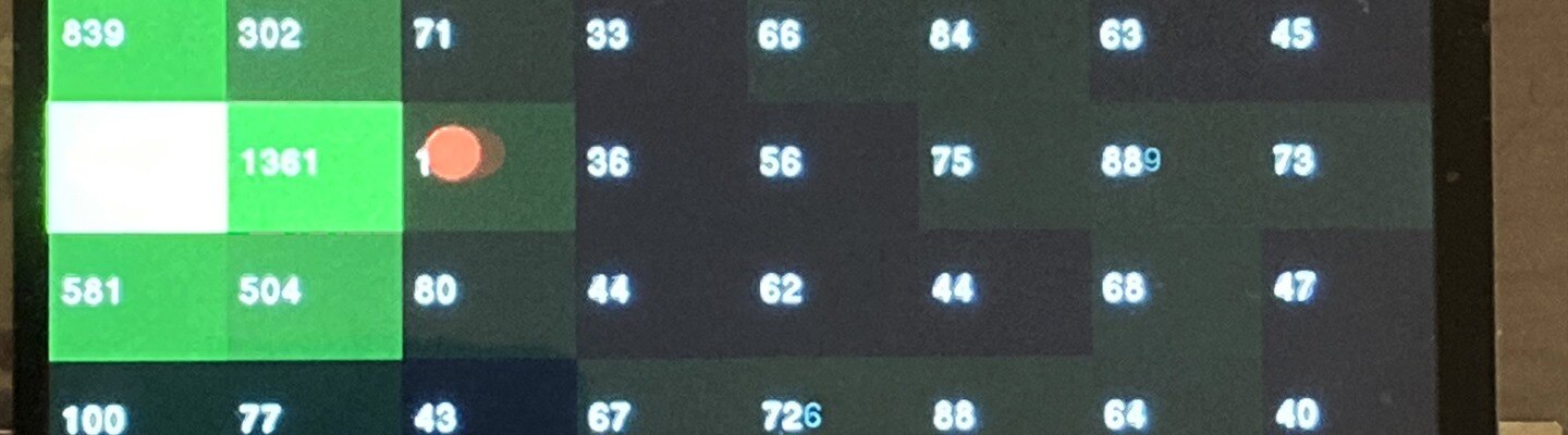

Caveats of canter of mass implementation
The algorithm is not optimal, I think. You maybe noticed it on the video, but when real center of mass is near edge, then red dot do not reflect its position and it is biased to the center of screen. It is highlighted for example in following situation:
Reason for this behaviour is that all pixels act when computing sum. Value 46 in the right top corner also act in this computation and because it is non-zero, it moves center of mass to the right. Because there are lot of pixels with non-zero value on right side, they move X location to the right direction. The similar apply on other side. If you place hand in right side, then non-zero but small left pixels will move it to the center also. And finally, the same apply for Y coordinate. In fact, the issue is significant for Y coordinate because there is less pixels in Y direction (6 vs 10 in horizontal direction).
For this reason, in my algorithm, I implemented improved center of mass algorithm. I added threshold and all values lower than threshold I interpreted as zero.
