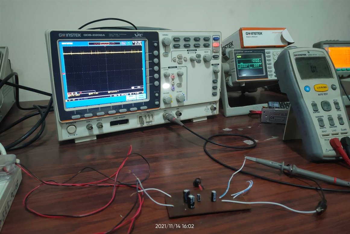

[Note: The following experiments used high voltage. Working with high voltage can be lethal.  I did those experiments very carefully. So, do it at your own risk. I recommend using your own protection and making sure you are not making any mistakes.]
First I measure the output voltage with a multimeter and then I observed the output in an oscilloscope to watch the quality of the DC and find some high-frequency noise in the DC output. No EMI or line filter was attached to the circuit.
Oscilloscope screenshot for the above connection.

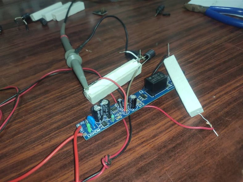

For easily connecting different inductors in the PCB I soldered two female jumper wires in the two pads on PCB. Then I measured the output voltage by adding a different inductor each time and recorded.
For measuring and observing the inductor current in an oscilloscope I added a 1ohm 5W resistor in series with the inductor. I added another 10ohm, 5W resistor as load. The following image shows the inductor current waveform when Bourns 1mH inductor was placed in the circuit.
The following image was taken when the 555uH inductor was connected to the circuit. It shows more switching ripple than the previous image where a 1mH inductor was used.
Oscilloscope screenshot of the inductor current for the above setup.
The following images are for 10uH and 4uH inductor respectively.
The following image shows the inductor current when the EMI filter is connected to the input side of the circuit.

  • michaelkellett
    michaelkellett over 5 years ago +1
    While the intention of the blog is fine, I must point out that your experiment, as described, is potentially lethal. In the pictures you show your test board connected to the standard 220V AC supply with…

    You should take the pictures down and add warnings to the text. It is not a good thing to promote the idea that it's OK for some people to ignore basic safetey issues because they take "care". Some poor…
  • michaelkellett
    In the pictures you show your test board connected to the standard 220V AC supply with wires joined by twisting the exposed bare ends together.
    Then some standard test gear is connected to the board.
    This set up it potentially lethal.
    If you make a mistake in the wire twisting then what you expect to be the “0V” side of your circuit will be connected to AC live - it may blow a fuse, or it may drive the exposed metal parts of the test equipment to 220V AC.
    Even if the connections are as intended, the exposed bare wires can easily be accidentally touched, which can cause injury or death.
    The danger of presenting these pictures is that some one else may be encouraged to follow your example.
    To test a circuit like yours, any connection to the AC mains should ALWAYS be made via an isolation transformer.
    Connections should be made using touch proof connectors.
    There should be an isolation switch (preferably a panic button type).

    taifur over 5 years ago in reply to michaelkellett
    You are right and thank you for your suggestions. I know the consequence and I did it with care.
  • michaelkellett
    michaelkellett over 5 years ago in reply to taifur
    Some poor innocent will end up injured or dead.
    MK
  • taifur
    I already added the warning text. Thanks again.
