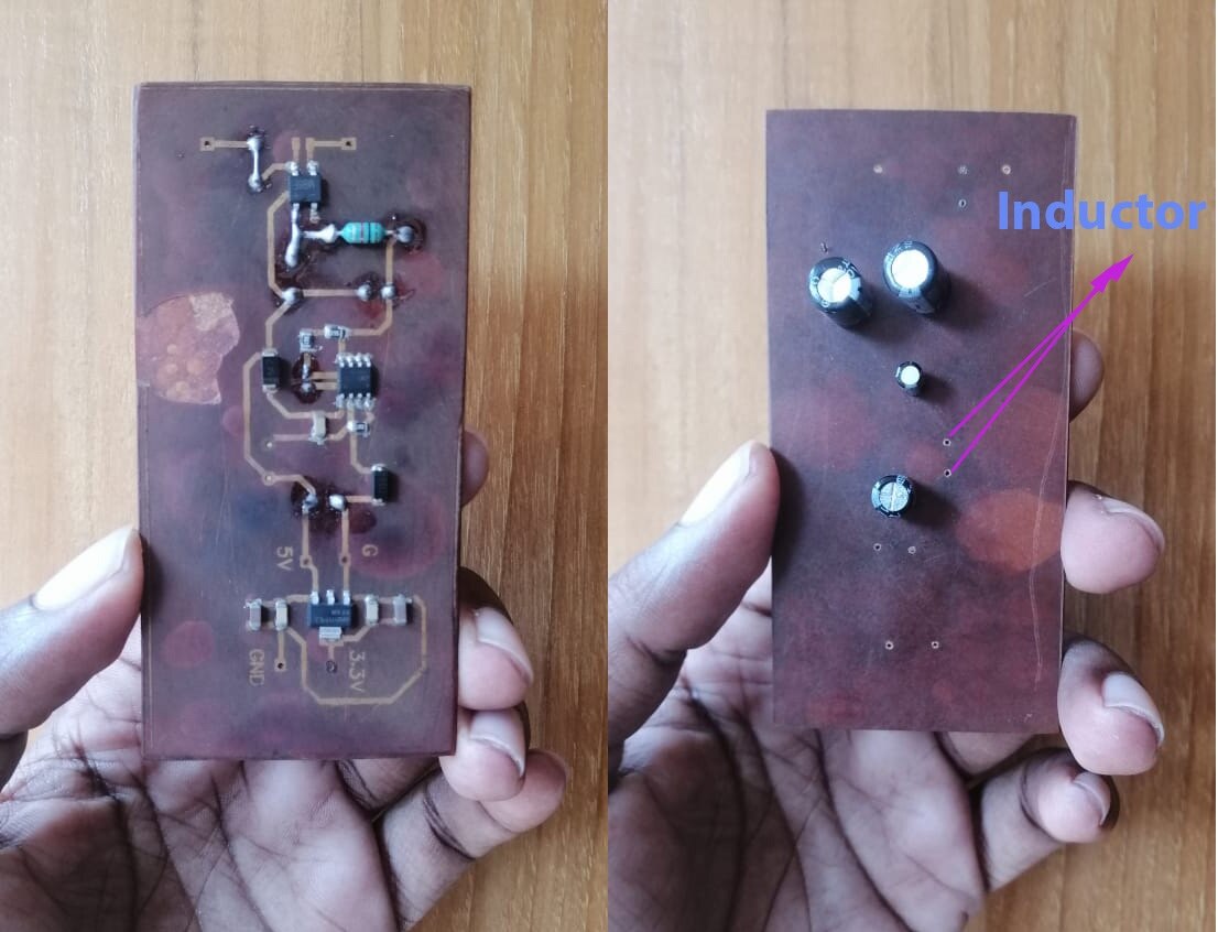

I made the first prototype with a handmade PCB for only the power supply unit. The circuit also contains the 3.3V regulation part.

I thought the noise is generated for bad PCB quality. So I decided to make a PCB from any professional PCB service provider.

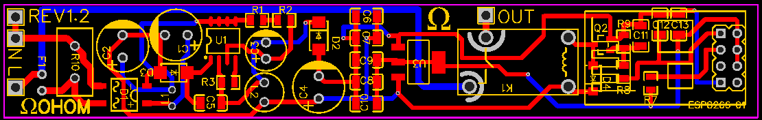

So, for getting a clean output from the above circuit I designed a PCB layout for professional PCB fabrication. The PCB layout is designed in EasyEDA. This is a double-sided PCB. I used a MOV on the input side to protect the circuit from high voltage surges.
The following image shows a 3D view of the PCB.
A printed PCB image is given below.
After placing and soldering all the components the circuit looks as follows. The Inductor L2 in the circuit is one of the most important components here. I tested the circuit for different inductor values and find that 1mH is the optimum value for the circuit in terms of output voltage, inductor current, and output current. So I soldered a 1mH inductor in my final circuit.

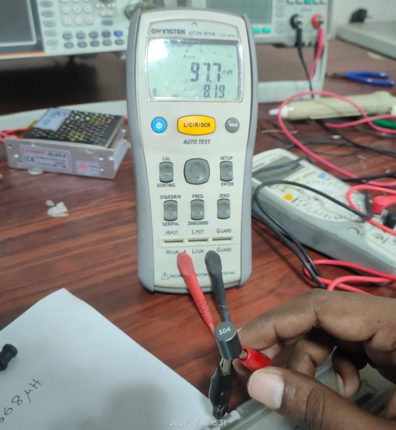

The first work is to measure the inductor's value using an inductance meter. I used an LCR meter to measure the inductance of all the inductors.
I note down all the inductor values on paper.
I used inductors from 100uH to 1100uH for testing the performance of the circuit.
Measuring the Bourns high current choke the biggest inductor I tested in the circuit. The Q of the inductor was measured as 5.11.
Measuring Bourns Shielded construction radial RF choke. This inductor has the highest Q (8.19) of all of the inductors I tested here.
All the inductor's values are recorded on paper.
