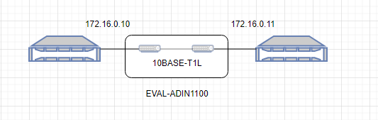

To further pinpoint the problem, setup like in my Broadcom optical transceiver was established, consisting of two Dell servers running Debian GNU/Linux, each equipped with Intel 82576 1000Base-T adapter.

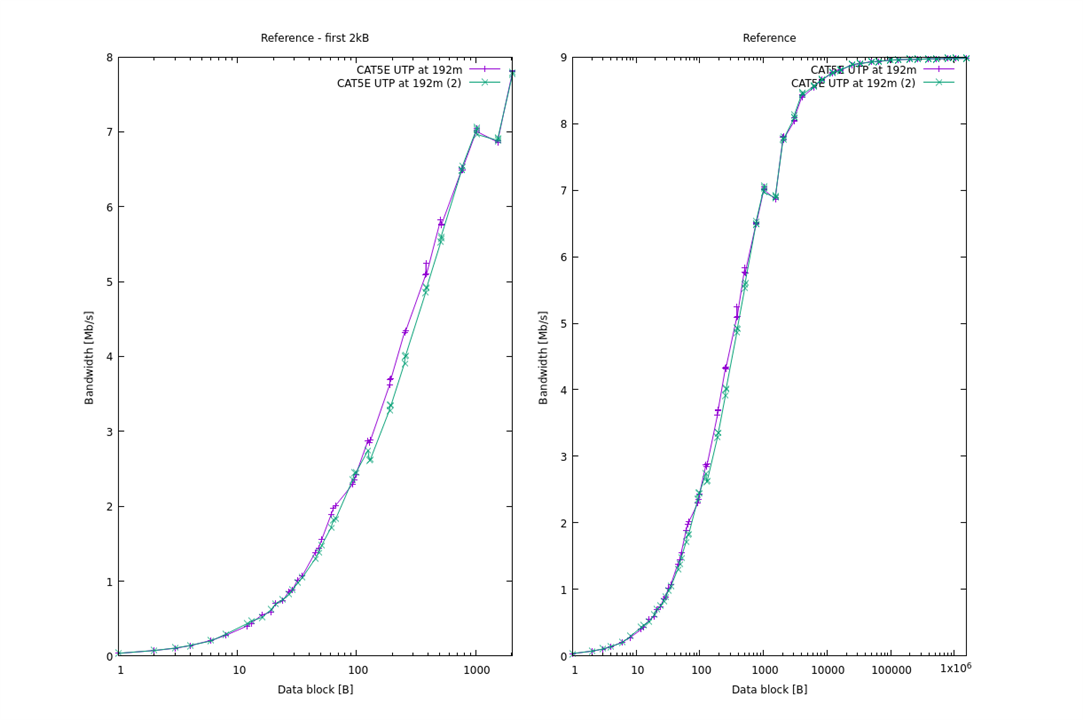

Netpipe test shows transfer curve as below, very good, no packet loss symptoms - observed slight drop of transfer near 1kB frame size was identified before as a behavior of the Intel network card used.

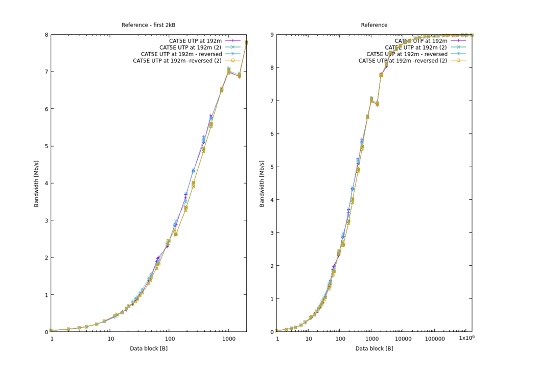

And Netpipe graph is as below (comparing direct and reversed connection)
As can be seen, when using ADIN1100 PHY, connector reversal in the pair is not affecting transfer rate.

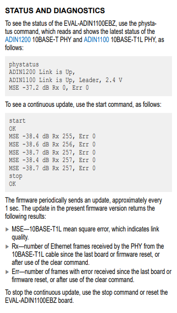

PHY monitoring also doesn't detect any errors:
MSE -37.2 dB Rx 3178421, Err 0
MSE -37.2 dB Rx 48231, Err 0
So frame loss that was observed during previous tests was definitely not connected to the cable used.

  • JWx
    JWx 8 months ago
    it seems that automatic polarity correction is even mandatory for 10BASE-T1L - must remember "read first, test later" Slight smile
    146.3.4.4 PCS Receive automatic polarity detection
    An automatic polarity detection and correction shall be implemented on the receive side of both master and
    slave PHY.

  • JWx
    JWx 8 months ago in reply to JWx
    and MSE is still the same:
    MSE -37.2 dB Rx 4693234, Err 0
    MSE -37.2 dB Rx 4693235, Err 0
    MSE -37.2 dB Rx 4693236, Err 0
    MSE -37.2 dB Rx 4693237, Err 0
    MSE -37.2 dB Rx 4693238, Err 0
    MSE -37.2 dB Rx 4693239, Err 0
    MSE -37.2 dB Rx 4693241, Err 0
    MSE -37.2 dB Rx 4693242, Err 0
    MSE -37.2 dB Rx 4693243, Err 0
    MSE -37.2 dB Rx 4693244, Err 0
    MSE -37.2 dB Rx 4693245, Err 0
    MSE -37.2 dB Rx 4693246, Err 0
    MSE -37.2 dB Rx 4693247, Err 0
    MSE -37.2 dB Rx 4693248, Err 0
    MSE -37.2 dB Rx 4693249, Err 0
    MSE -37.2 dB Rx 4693250, Err 0
    MSE -37.2 dB Rx 4693251, Err 0
    MSE -37.2 dB Rx 4693252, Err 0
    MSE -37.2 dB Rx 4693253, Err 0
    MSE -37.2 dB Rx 4693254, Err 0
    MSE -37.2 dB Rx 4693255, Err 0
    MSE -37.2 dB Rx 1563071, Err 0
    MSE -37.2 dB Rx 1563072, Err 0
    MSE -37.2 dB Rx 1563073, Err 0
    MSE -37.2 dB Rx 1563075, Err 0
    MSE -37.2 dB Rx 1563076, Err 0
    MSE -37.2 dB Rx 1563077, Err 0
    MSE -37.2 dB Rx 1563078, Err 0
    MSE -37.2 dB Rx 1563079, Err 0
    MSE -37.2 dB Rx 1563080, Err 0
    MSE -37.2 dB Rx 1563082, Err 0
    MSE -37.2 dB Rx 1563083, Err 0
    MSE -37.2 dB Rx 1563084, Err 0
    MSE -37.2 dB Rx 1563085, Err 0
    BTW - ADI support suggested that during laboratory testing noise level is so low that MSE couldn't drop even using long/worse quality cabling
  • veluv01
    veluv01 8 months ago in reply to JWx
    Well...the -38dB in their datasheet is too evil.
    -37.2 dB was all I could get, maybe it increases if we could go over a KM?
  • JWx
    JWx 8 months ago in reply to veluv01
    yes - this is strange, never have seen anything other than -37,2dB
  • JWx
    I have spool of CAT6 UTP which I could connect for > 1000m range but I don't know if I would have time before deadline
