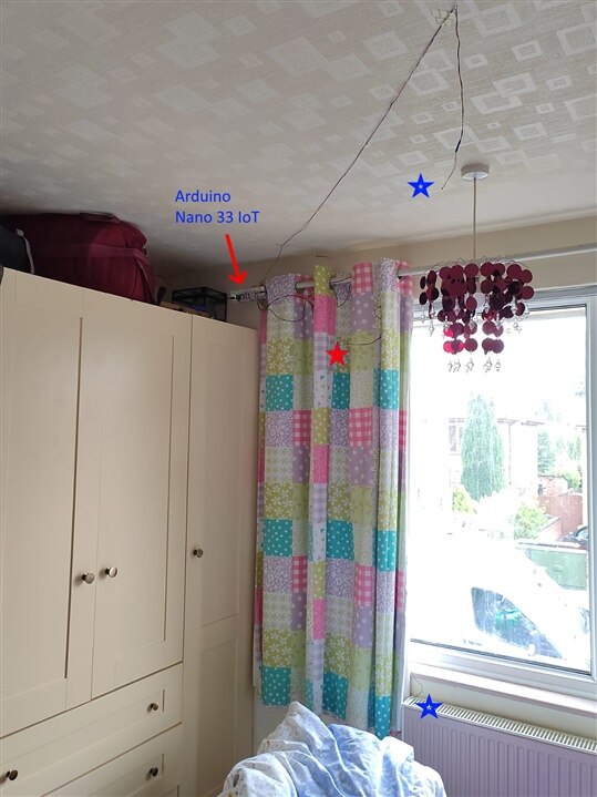

Let's measure some temperatures using Molex thermistors! But, where shall we begin?
A thermistor is basically a resistive element whose electrical resistance changes when it is subjected to heat. So, if we can sense this change in resistance, we can map it to the actual temperature accordingly. The easiest way to do it is perhaps using a potential/voltage divider as shown in sketch below.
Here, 5V is supplied to the resistors in series, R and Rt, and voltage is measured across Rt. Since, the resistors R + Rt are in series, the voltage acros R and Rt will be proportional to the ratio they both make. In the figure above, voltage across Rt will be 5V * Rt/(R+Rt) = 2.083V and across R will be 5V * R/(R+Rt) = 2.917V. Now, suppose the temperature increases to a certain value which makes the thermistor resistance to go down to about 8kOhm. In that case, the voltage across it will be seen as 5V * 8/(14+8) = 1.818V. Therefore, the change in voltage can be measured directly. If we know the relationship between change in voltage that corresponds to the change in temperature, we can calculate the temperature value by measuring this voltage drop. If the relationship is not known, we can measure the temperature using a trusted device and record voltage drop to obtain the relationship - this is known as calibration. Fortunately, in our case, the relationship is known - Steinhart-Hart equation - and thanks to Molex that we know the necessary parameters, too! So, we can simply measure the voltage, work out the thermistor resistance and then convert it to temperature using that equation.
Temperature measurement
I chose Arduino Nano 33 IoT for the data acquisition (essentially voltage measurement) for several reasons:
  1. It has WiFi module which helps be getting the data from room bound computers or laptop/raspberry pi without wired connection to the measurement board.
  2. It can do 16-bit resolution with oversampling.
  3. It has 8 analog input channels (although only 6 shall be used as inputs per the recommendation in their datasheet)
However, using Nano meant that I can input maximum of only 3.2V because its I/Os are not tolerant to 5V. This means that I have to choose the resistanct R such that the voltage across Rt does not exceed 3.2V. For this, I considered the temperature at which the resistance will be at its higher range, i.e. lower range of the temperature. This is because the thermistors are NTC, meaning Negative Temperature Coefficient and the resistance will increase with decreasing temperature. So, 5V being divided across constant (R) and variable resistor (Rt), voltage drop across Rt increases when Rt increases. Keeping this in mind and the expected lowest value of the temperature, I used the Steinhart-Hart model to work out what resistance value would a thermistor reach. Steinhart-Hart equation is
1T​=1T0​+1beta​lnRR0​.
which when rearranged, gives Rt as shown below.
Rt=R0×e(beta·(1T​−1T0​)).
Here, beta is the coefficient of the non-linear part of the equation, R0 is the electrical resistance of the thermistor at temperature T0 (25 degree C in this case), Rt is the electrical resistance of the thermistor at temperature T.
Using the parameters given by Molex, I calculated the max reistance that may be attained at the expected temperature for the thermistors I have used. These are tabulated below. The final value of the fixed resistors varied sightly - due to the availability of nearest value resistor.
Thermistor R0 (kOhm) Lowest considered temperature (degree C) Rt at lowest considered temperature (kOhm) R (kOhm) fixed [3.2/5 * Rt at lowest temperature] R (kOhm) that is used
Thermistor1-Heater 10 -10 47.65 28.5 27.15
Thermistor2-Ceiling 4.7 0 16 9.6 9.11
Thermistor3-Curtain 10 10 19.65 11.79 12.08
Thermistor4-Window 12 10 23.58 14 14.98

I followed the article that I bumped into, after finding it in someone's blog, perhaps referenced by ntewinkel - which mentions self-heating. To avoid that, I used a transistor to switch the 5V on only whilst measuring the temperature. So the measurement circuit looks like this.
For sanity, I have not connected some thermistors in the schematic. The corresponding real-life circuit on a breadboard looks like this. Thermistors are numbered from thermistor1 from arduino side towards the tea - last one being thermistor4.
You might be wondering Thinking what is the role of tea here? I will reveal it down below but you may have guessed it already! Wink
For the power, I got a battery pack and a booster to provide 5V to arduino so that a long USB/power cable can be avoided making it safer to operate without trip hazards around my room!

OK, so now - where is my tea?! I hope it's not gone cold Stuck out tongue winking eye
The first test
Yeah, I will admit that it wasn't the absolutely first test - I'm skipping ahead my grief with some initial debugging and incorrect temperature readings varying from -273 to 300 degree C because of broken transistor, etc. etc. In the end though, I was able to get it working reliably such that I could get a good set of data. Here is the snippet of what I recorded for a few minutes by touching the tea mug with the thermistors one by one.

With this being a success in getting the setup ready, I have installed them in my room and collecting the data as I write this blog!
Thermistor locations are indicated by stars - thermistor1 (ring thermistor) on the heater, thermistor2 hanging from the ceiling, thermistor3 on the inside of the curtain and thermistor4 on the outside of the curtain facing the window. The picture shows curtains open but obviously at the time of measurements, I will keep the curtains closed.
OK so that was a looooong blog on the setup but look out for my final blog with the data that I will gather!
