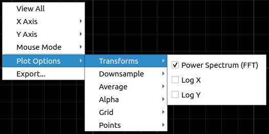

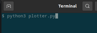

In PyQt graph library, the FFT algorithm is packaged together and can easily be enabled.
Connect the board and start up the plotter as per normal

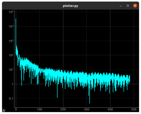

Right click on the plot to enable FFT. Now we can do a real time analysis of the frequencies.
Optionally, you may enable log scales. But I chose to leave it unchecked.
{gallery:width=600,height=500} Linear vs Log Graph
Linear Graph: This is an FFT plot with linear scale showing a 90 Hz signal
Log Graph: This is the same 90 Hz signal but shown on a log scale
Log scales may be better for higher frequencies. But in my experiment, the measurements around my home are probably a maximum of 200 Hz, so a log scale may not be useful.

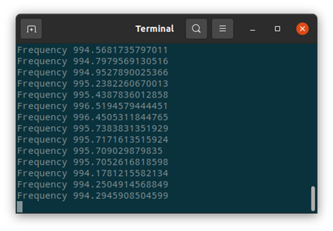

In my previous comments I was asked about the sampling frequency. And from this, I felt it is important to talk about it before we do FFT.

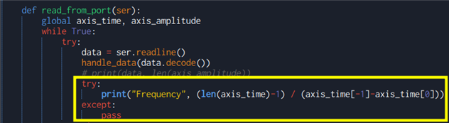

I modified the code in my plotter Python program to calculate the frequency for me in real time. I added this line inside the callback which receives data from the serial port.
print("Frequency", (len(axis_time)-1) / (axis_time[-1]-axis_time[0]))
What this code does is it gets the number of samples and the time span from the first sample to the last sample in the array. The formula is Frequency = Number of Samples / Time.

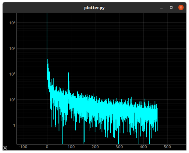

Here when running the program I am getting a stable sampling frequency of up to 995 Hz.
Due to the Nyquist frequency, the maximum frequency that FFT can produce is half of the sampling frequency or 497 Hz.
This is a screenshot of the FFT plot in PyQt, here we can confirm that the FFT plot is just shy of 500 Hz.
There are ways to improve the sampling frequency, however, my current setup is sufficient for me and I decided to focus on getting some results before further experimenting on it.

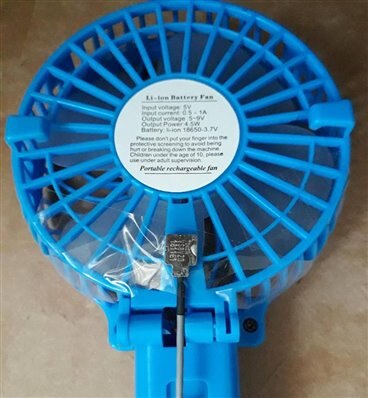

Here's the same fan from last time. Note that this time, I taped down the sensor near the stem of the fan. This placement produces more obvious vibrations results compared to the center.
I noticed that placing the sensor off-center, the vibrations will be more obvious compared to placing the sensor right in the center where the axis is spinning.

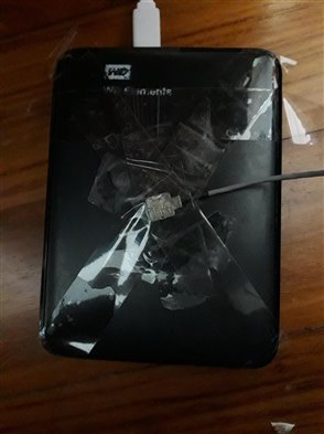

#1. WD Elements

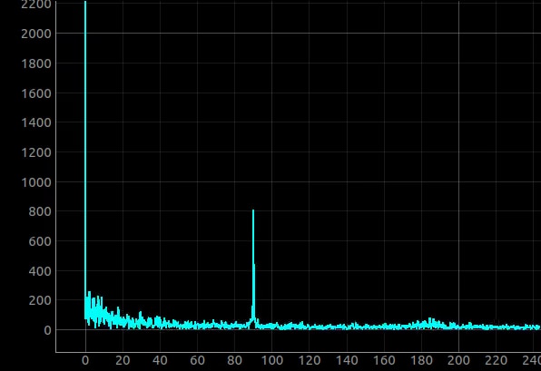

I bought this a few years back and if I’m not wrong, it should be 5400rpm. Many small portable hard disks are 5400rpm. I have taken good care of it and it is still in good condition.
I simply mounted it down firmly using clear tape.
Here is a video of it starting up (when I connect to the PC) and stopping (when I ejected it)
And true enough, one very clear peak is observed at 90Hz which equates to 5400rpm!

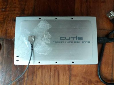

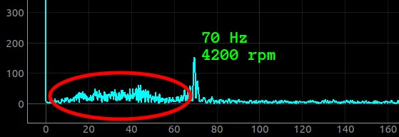

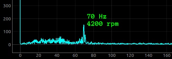

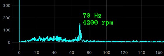

#2. Cutie Hard Disk Enclosure
This is actually an HDD taken from an old laptop and put into an enclosure. It is almost 20 years old and unreliable (data has been lost before!).
Here is a video of it starting up.
Strangely this time I observed that there is a peak at 70Hz which means the hard disk is spinning at 4200rpm.
Unlike the previous HDD, there's a lot of frequency components around the 40Hz mark. The dominant 70Hz (4200rpm) frequency is also weak and not as defined.
These could be indicative of its unreliability and I can infer that the hard disk spindle might be weakened — This could have caused the data loss from last time.

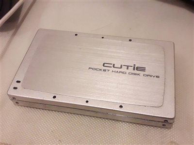

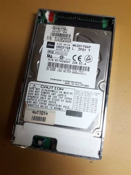

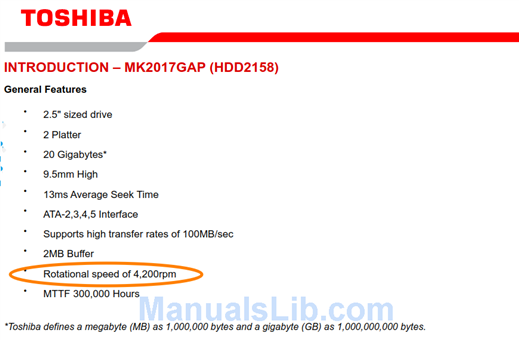

I got curious if the 4200rpm result was true... So I unscrewed and opened up the enclosure.
Inside is a Toshiba HDD2158. I searched online and found a manual of the model. Indeed it confirms that it is 4200rpm!
I was quite amazed to see a hard disk with this odd RPM rating, a very interesting discovery!

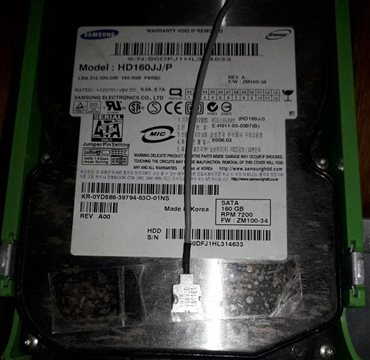

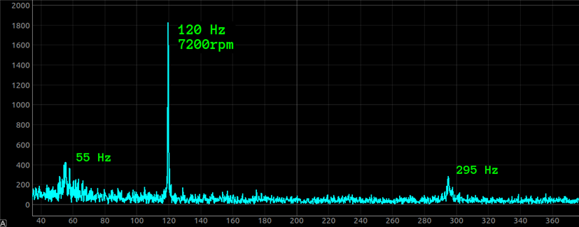

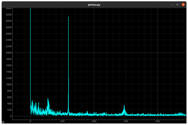

#3. Desktop PC Hard Disk

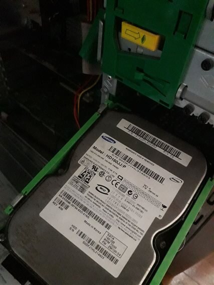

For the sake of completeness, I wanted to collect results from a 7200rpm HDD too.
It was tough to find because most of my external hard disks are 5400rpm, and my laptops are all using SSD now.
But eventually I found a 7200rpm HDD after cracking open my desktop PC.
I attached it like this and turned on the PC.
This is a screenshot of the 120 Hz peak which corresponds to 7200rpm. Due to the rigid metallic body of the hard disk, the amplitude of the 120Hz is also very prominent.

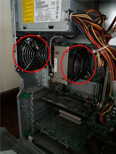

It is interesting to note that there are also a few frequency components at 55 Hz and another one at 295 Hz.
Looking around, I found out that these frequencies are coming from the other fans (there is the cooler fan for the CPU and chassis)

1. Vibrations can be coupled from within the chassis of a desktop PC. Be careful when making measurements near other vibrating sources!

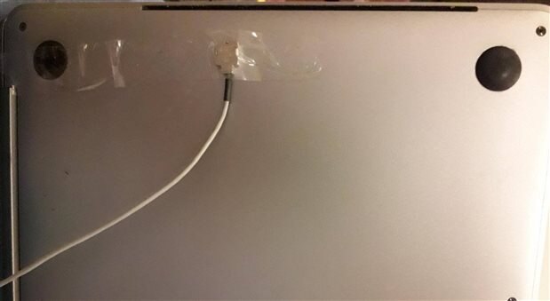

I am using this Macbook Pro 2017 and there are 2 fans inside (left and right).
{gallery:width=500,height=400} Macbook Pro 2017
Macbook Pro 2017 Internal: Picture from https://www.igorkromin.net/fp-content/images/mac/cleaning/IMG_1724.jpg
My initial plan was to attach the sensor to the middle of the laptop, and sense vibrations from both fans at the same time, however, I was not successful in receiving any vibrations at all. It is likely that the laptop was designed to dampen the vibrations and sound. After all, the Macbook’s fans are known to be quiet.
I decided to attach it to the left side of the laptop, directly under the left fan.

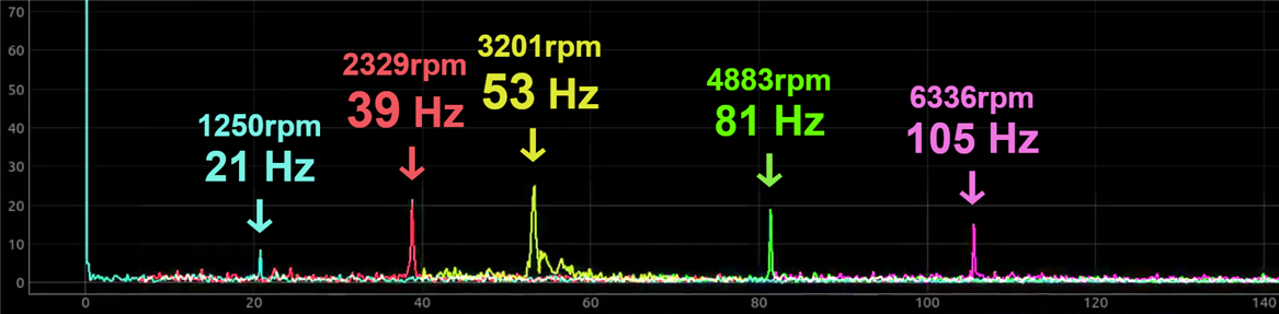

This is an overview of all the plots.

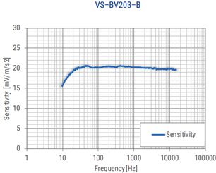

(Notice that the 21 Hz result has a significantly smaller amplitude. I mentioned in my earlier posts that the sensor is rated to detect vibrations above 30 Hz.
Be very careful when dealing with vibrations of low frequencies! Here we indeed see some attenuation at frequencies lower than 30 Hz.)
This is the sensitivity plot taken from the datasheet:
