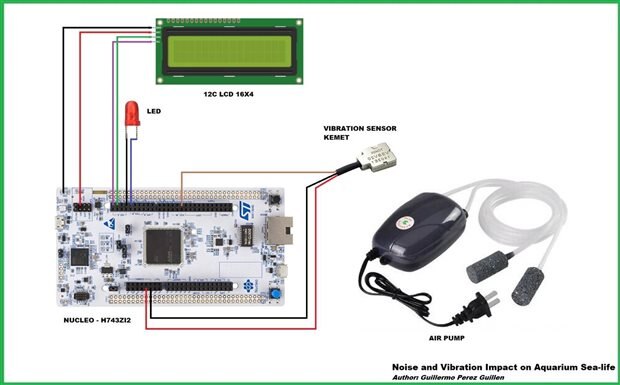

In the electronic diagram below I show the connections of the electronic components that I use:
List of parts:
  • NUCLEO-H743ZI
  • Vibration Sensor (KEMET)
  • 12C LCD 20x4
  • LED diode
  • Battery 5V
  • Micro USB to USB cable
  • Air pump

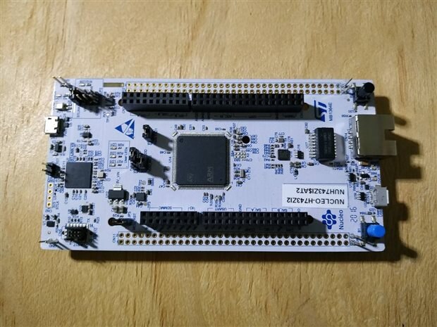

Step 1.- Unpack the NUCLEO-H743ZI2 board.
Features:
  • STM32 microcontroller in LQFP144 package
  • 3 user LEDs
  • 2 user and reset push-buttons
  • 32.768 kHz crystal oscillator
  • Board connectors:SWDST Zio expansion connector including ARDUINORegistered Uno V3ST morpho expansion connector
  • Flexible power-supply options: ST-LINK, USB VBUS or external sources
  • On-board ST-LINK debugger/programmer with USB re-enumeration capability: mass storage, Virtual COM port, and debug port
Step 2.- Identify the pins that we are going to use on the board and that we identify according to the figure below. In my case I'm going to use the included mapping for Arduino UNO V3.
Step 3.- Inserting the LED diode between pins D13 and ground.
Step 4.- Wiring 12C LCD display: SDA pin is connected to D14 and SCL pin to D15.of the NUCLEO board respectively. VCC is 5V.

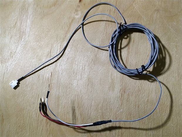

Step 5.- Cut the vibration sensor connector, and solder the straight pins as shown in the figure below:
Specifications:
  • Temperature Range: -25/+75°C
  • Power Supply Voltage: 3 - 5.5 VDC
  • Sensitivity: 20 mV/m/s²
  • Frequency Range: 10 - 15,000 Hz
  • Measuring Range: +/-50 m/s
Step 6.- Connect the KEMET vibration sensor. The white wire (Vout pin) connects to pin D2 on the NUCLEO board. VCC is 5V.

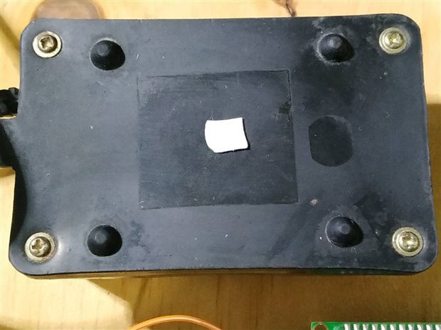

Step 7.- Stick double-sided tape on the bottom of the air pump.
Step 8.- The vibration sensor thinly spread on the adhesive surface.

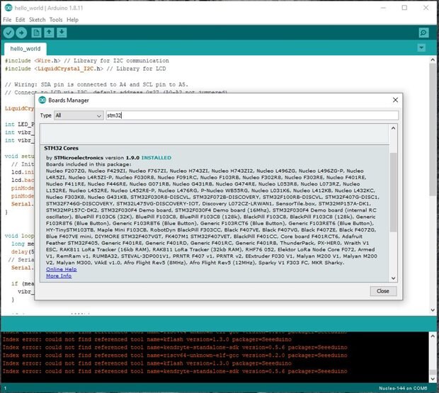

Step 1.- I'm going to use the Arduino IDE to make the code, so we have to download the most recent version from the official site: https://www.arduino.cc/en/software
Step 2.- Launch Arduino IDE.
Click on File menu and then Preferences
The Preferences dialog will open, then add the following link to the Additional Boards Managers URLs field:
https://github.com/stm32duino/BoardManagerFiles/raw/master/STM32/package_stm_index.json
Step3.- Click OK,. Now, click on Tools menu and then “Boards > Boards Manager”
Next in the box type: stm32
and install the boards: STM32 Cores
Step 4.- There're different types and versions of libraries to work with the LCD to I2C Adapter module, more complete information can be found at: http://playground.arduino.cc/Code/LCDi2c, we will use the LiquidCrystal_I2C library: https://github.com/johnrickman/LiquidCrystal_I2C
Step 5.- Select the NUCLEO board:
clicking on Tools> Board: "Nucleo-144"
Click on Tools> Board part number: "Nucleo H743ZI2"
and Click on Tools > Port
Step 6.- Upload the aquarium_vibration_sensor.ino code (comments guide us).
