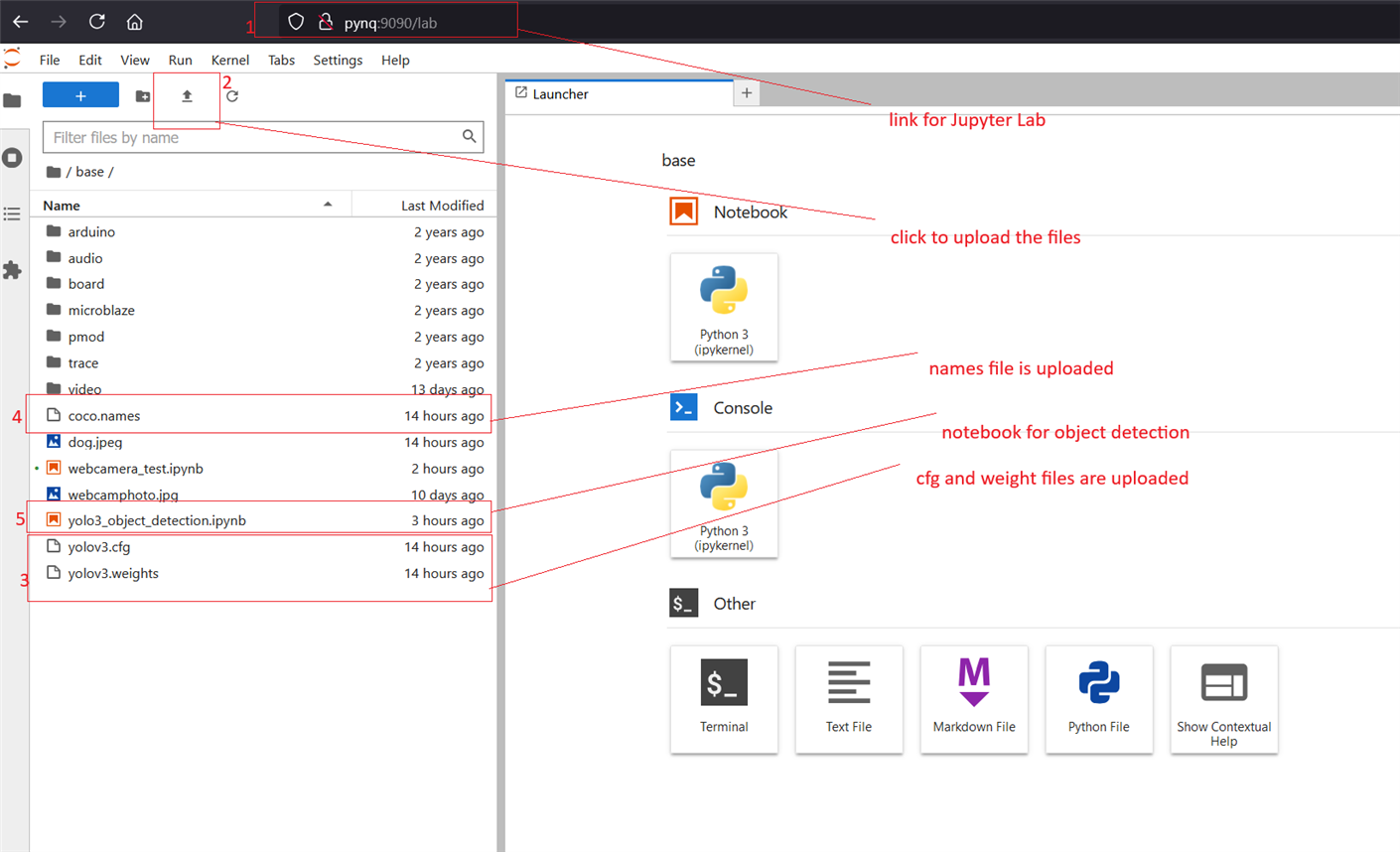

I downloaded weight and cfg (configuration) files from the following link: https://pjreddie.com/darknet/yolo. The model has been trained for different sizes of images: 320 x 320 (high speed, less accuracy), 416 x 416 (moderate speed, moderate accuracy) and 608 x 608 (less speed, high accuracy). We downloaded the weights and cfg files for YOLOv3–320 for now.

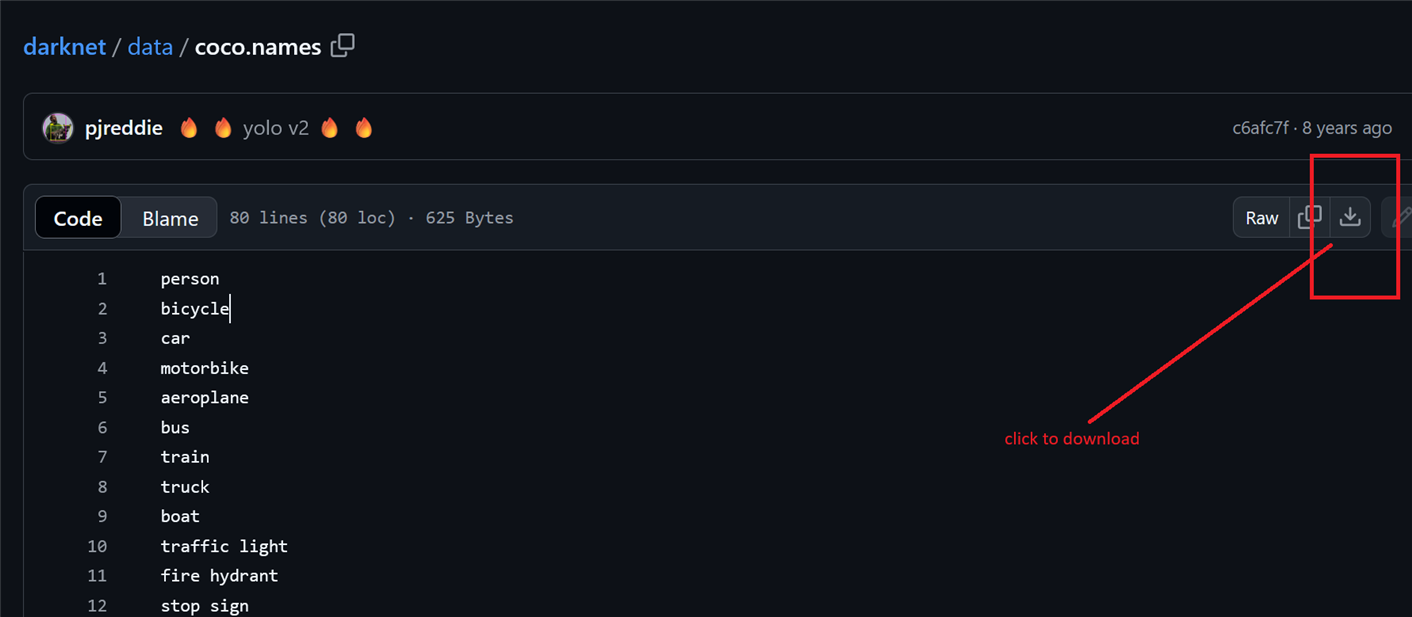

Names file was downloaded from https://github.com/pjreddie/darknet/blob/master/data/coco.names.
After downloading all the necessary files I opened the Jupyter Lab from ARTY Z7 board so that I can upload all the files to the board. For opening the Jupyter Lab use the link http://pynq:9090/lab. Then I created a new notebook file to write and run the code for object detection. The following screenshot illustrates all the steps I followed.

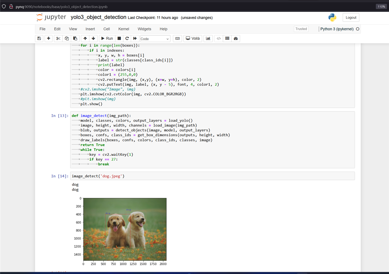

The next step is to write the code. I copied the code directly from the link: https://github.com/nandinib1999/object-detection-yolo-opencv/blob/master/yolo.py. I was able to run the code without any issues both for the image and the webcam.
The above screenshot shows object detection from an image. There are two dogs in the image and both are identified with the right-sized bounding boxs.

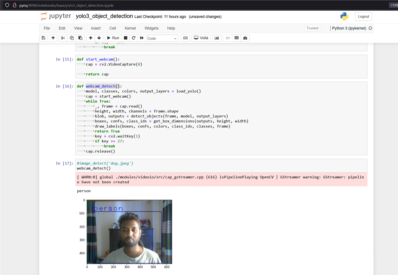

The following image shows the object detection from the camera image.
Though it was able to detect any object very accurately but the response was very slow because we are running the model from the processing part of the Zynq 7000 SoC. Utilizing the programming logic unit will improve the speed of the detection. For running the video detection we need to add an HDMI display to observe the result in real time.

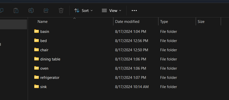

For preparing custom object detection model we need custom images for training and testing the model. For gathering the data we can download from the internet if the relevant dataset is already available or we can create the dataset using our own data. As I am going to create an image dataset for common indoor appliances and furniture I downloaded many images from internet and captured some images by myself. For the sample dataset, I created seven classes for the entire dataset. I took 50 photos for each class.
The images I took for the bed class are illustrated below. Images should be taken from different angles and different backgrounds.

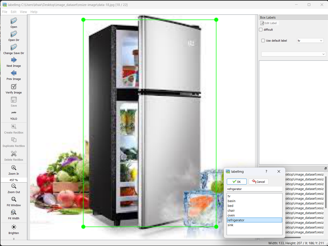

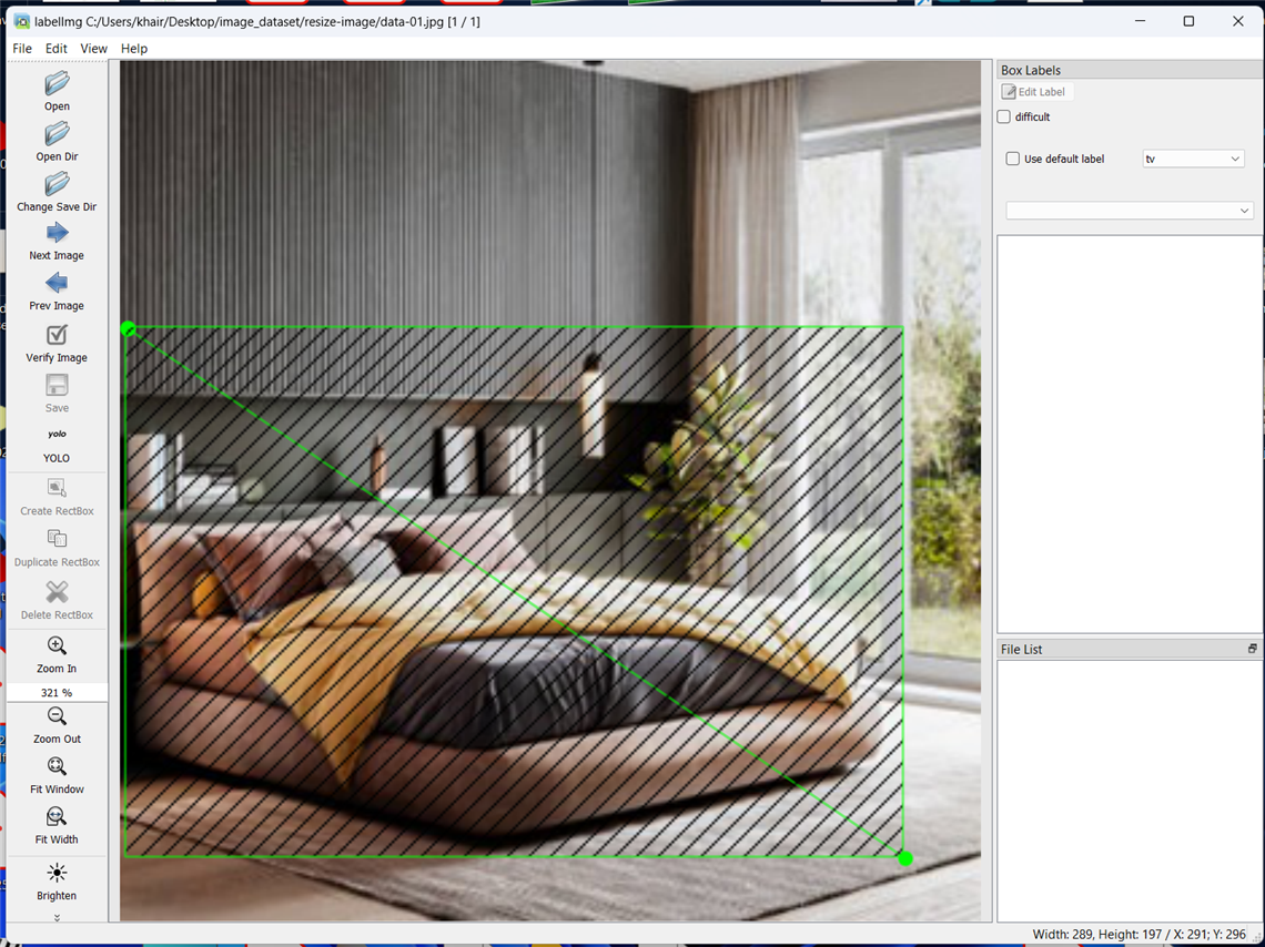

Next, we need to annotate these images. As we are going to use size 320 for training our model, all images should be of 320 size. For annotating there are many tools available. I used Labelimg for this purpose. For getting image annotations in YOLO format, https://github.com/tzutalin/labelImg is preferred as it is easy to install and use. For installing, check out https://github.com/tzutalin/labelImg. If you choose to use this tool for annotations, make sure to change the output format to YOLO.
Annotating YOLO Format

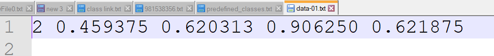

In YOLO labeling format, a .txt file with the same name is created for each image file in the same directory. Each .txt file contains the annotations for the corresponding image file, that is, object class, object coordinates, height, and width. For each object, a new line is created. Below is an example of annotation in YOLO format.

Here are some screenshots I captured while annotating my data using Labelimg.

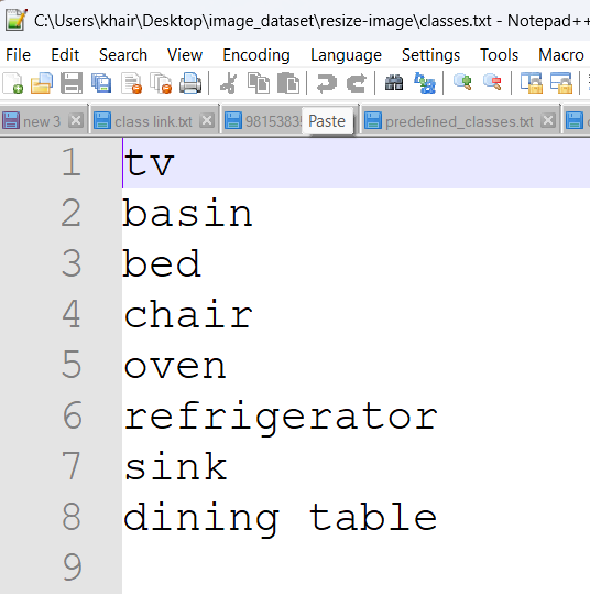

After YOLO labeling format, a .txt file with the same name is created for each image file in the same directory. Each .txt file contains the annotations for the corresponding image file, that is, object class, object coordinates, height, and width. A classes.txt file is also generated that includes the list of all classes I have annotated in the dataset.
Annotation of the dataset is completed.
