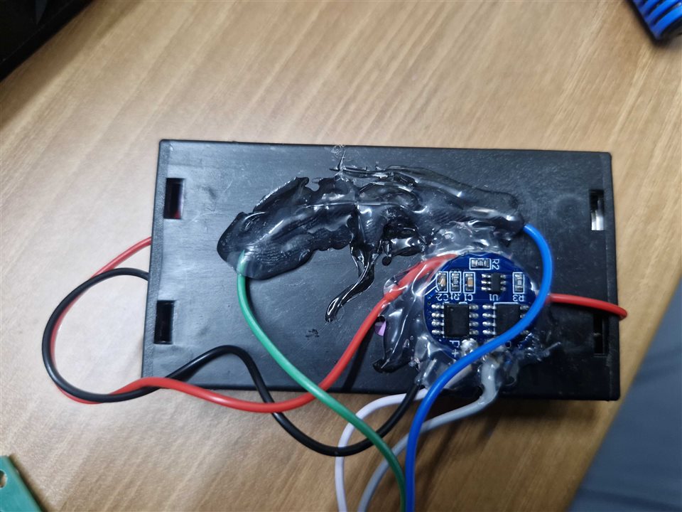

For this part of EVA Guardian, I started building the Battery Management and Battery Profiling Node.
The objective of this module is to continuously measure the battery's voltage, current and temperature, and use these parameters to derive meaningful battery information such as State of Charge (SoC), State of Health (SoH), energy usage and battery condition.
For the first prototype, I built the complete measurement circuitry on a veroboard and interfaced it directly with the Arduino UNO Q.

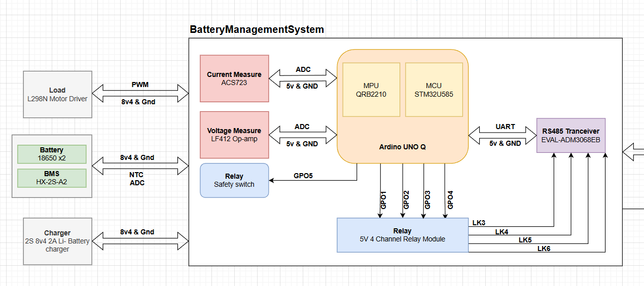

The Battery Management Approach

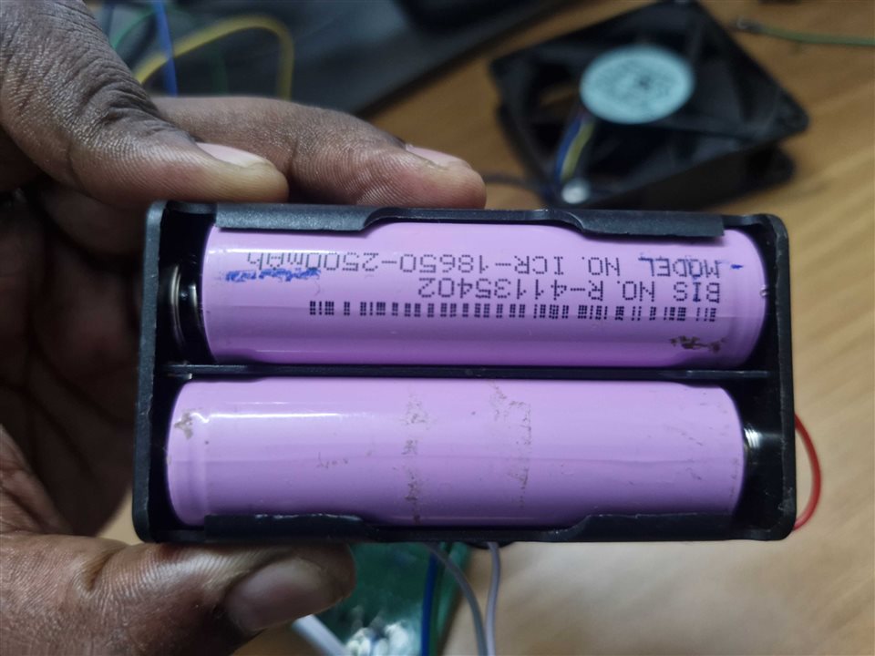

The battery used for this prototype is a 2-cell 18650 Li-ion battery pack connected in series. Each cell has a nominal voltage of approximately 4.2 V, giving a fully charged voltage of approximately 8.4 V. For the initial prototype, I am using an HX-2S-A2 2S BMS protection board to provide the basic battery protection functionality.The Arduino UNO Q is then used as the monitoring and intelligence layer above the protection circuit.
The basic architecture is:
Battery → BMS → Voltage / Current / Temperature Measurement → Arduino UNO Q → Battery Analytics
The three primary measurements are:
  • Battery voltage
  • Battery current
  • Battery temperature
These measurements form the foundation for the higher-level battery calculations that I plan to implement.

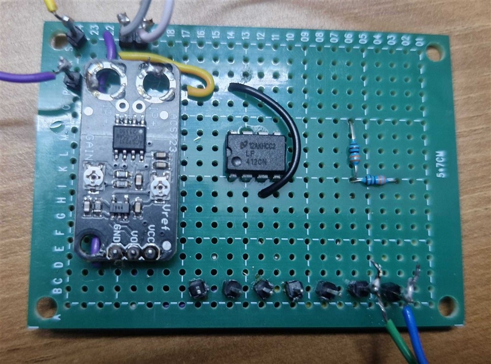

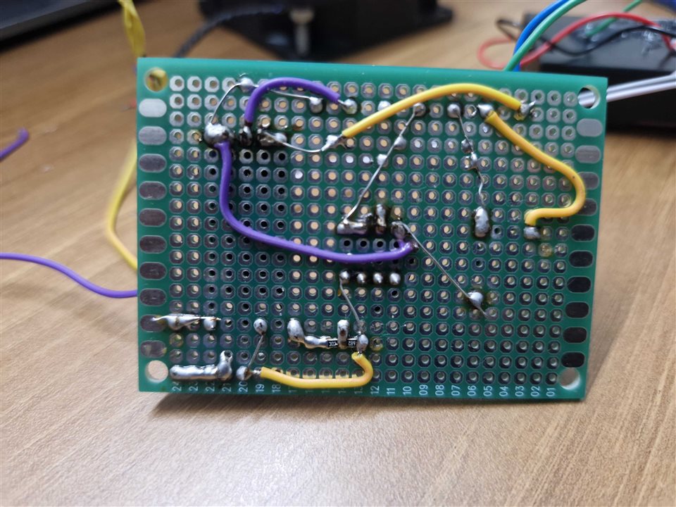

Building the Measurement Circuit
For the first hardware prototype, I assembled the voltage, current and temperature measurement circuits on a veroboard.
The three analogue measurements are connected to the Arduino UNO Q as follows:
Arduino UNO Q Measurement
A0 Battery Current
A1 Battery Voltage
A2 Battery Temperature
This keeps the measurement interface simple and gives me a clear separation between the three primary battery parameters.

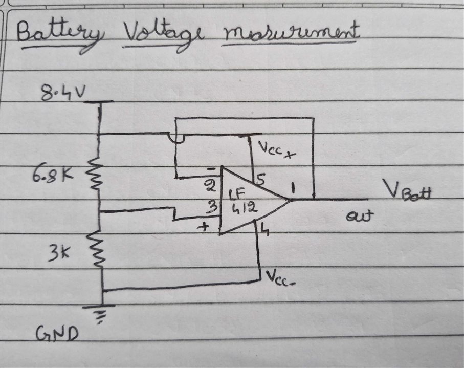

1. Battery Voltage Measurement
The battery pack can reach 8.4 V, which is higher than the Arduino UNO Q's analogue input range. Therefore, I cannot directly connect the battery voltage to the ADC. I used a 6.8 kΩ and 3 kΩ resistor voltage divider to scale the battery voltage down to a suitable level for measurement. The divided voltage is then passed through an LF412 op-amp configured as a buffer before being connected to the Arduino UNO Q. The buffer provides a high-impedance interface between the voltage divider and the ADC, helping prevent the ADC input from significantly loading the divider.
The scaled voltage is connected to:
Arduino UNO Q → A1
The software then converts the measured ADC voltage back into the actual battery voltage using the calibrated divider ratio. This gives me the first fundamental parameter required for battery profiling.

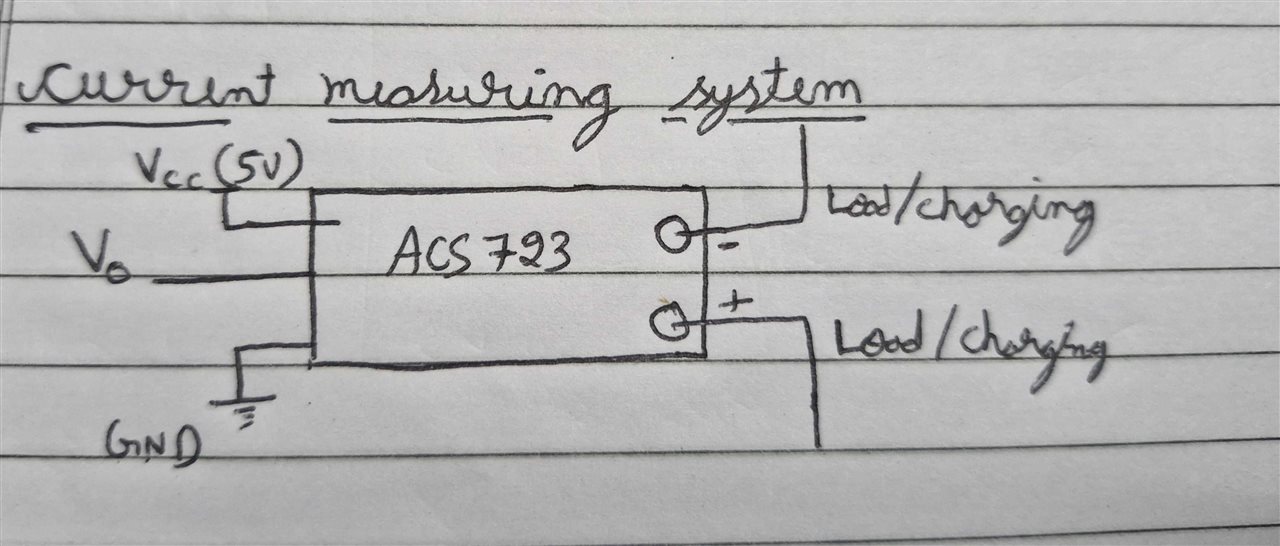

2. Current Measurement Using ACS723
The second important parameter is battery current. For this, I am using the ACS723 current sensor.The sensor provides an analogue output proportional to the current flowing through it. For my setup, the sensor output is approximately 1.70 V at zero current, which becomes the reference or zero-current point. The current sensitivity used in my implementation is approximately 1.336 V/A.
Therefore, the Arduino UNO Q measures the ACS723 output through:
A0 → ACS723 Current Sensor
The software then uses the calibrated zero-current offset and sensitivity to determine the actual battery current.
This allows the system to determine whether the battery is:
  • Charging
  • Discharging
  • Idle
and also provides the current value required for power and energy calculations.

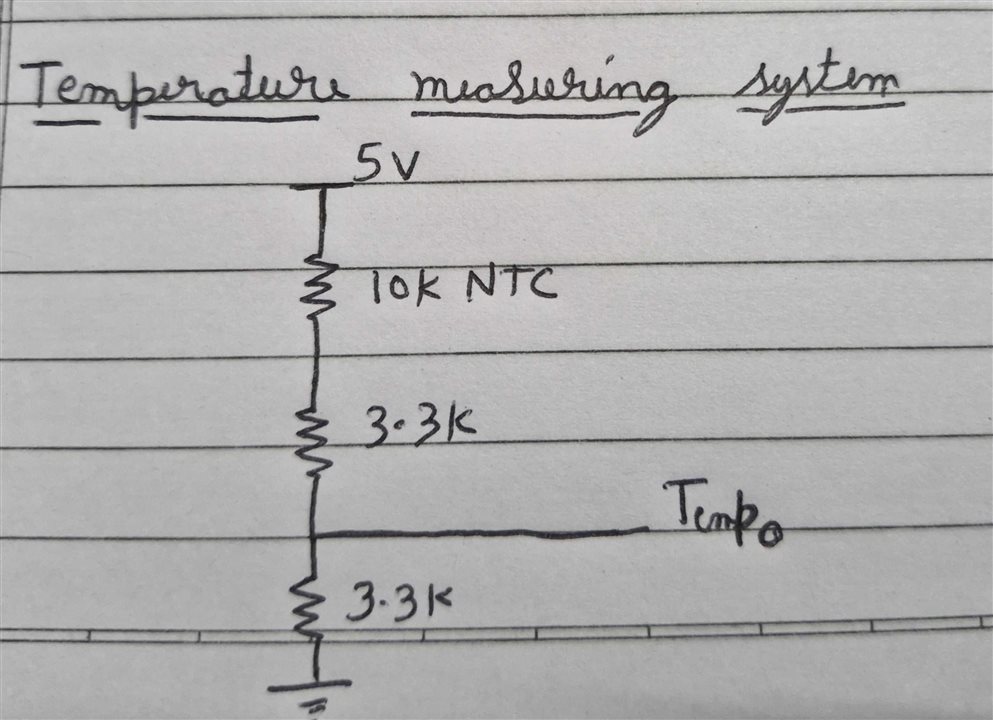

3. Battery Temperature Measurement
Temperature is another critical parameter for a Li-ion battery. For the prototype, I am using a 10 kΩ NTC thermistor attached to the battery module. The thermistor is combined with resistor networks to generate a temperature-dependent voltage that can be measured by the Arduino UNO Q.
The midpoint of the resistor network is connected to:
Arduino UNO Q → A2
As the battery temperature changes, the resistance of the NTC changes, which produces a corresponding change in the measured voltage. The software can then convert this ADC measurement into an estimated battery temperature. Monitoring temperature becomes particularly important when analysing high-current charging and discharging conditions.
Bringing Voltage, Current and Temperature Together
Individually, voltage, current and temperature provide useful information. But the real value comes from looking at all three together.
The Arduino UNO Q continuously acquires:
Voltage + Current + Temperature
From these measurements, I can calculate additional battery parameters such as:
  • Battery power
  • Charging/discharging state
  • Energy consumption
  • Open-circuit voltage
  • State of Charge
  • State of Health
  • Battery operating conditions
This is where the project begins moving from a simple battery monitoring system toward a battery profiling and intelligence system.

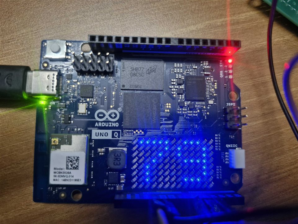

Using the Arduino UNO Q LED Matrix
I also wanted to make the battery information visible without requiring a laptop. The Arduino UNO Q provides an onboard LED matrix, so I decided to use it to display the current State of Charge percentage.
For example:
75%
can be displayed directly on the LED matrix. As the battery is discharged, the displayed value updates accordingly. This provides a simple visual indication of battery status and also makes the system much more engaging during a live demonstration.
