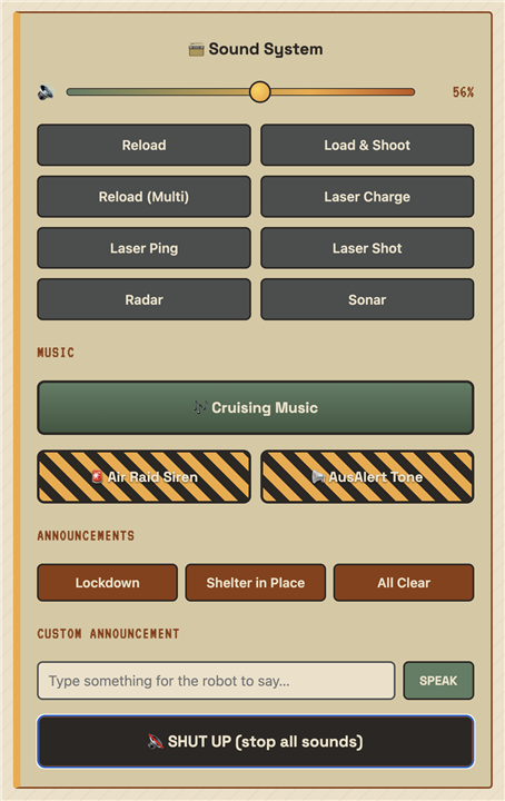

Hi again, it’s Hambreros and Tamadillo. Last post the robot learned to roll Post 1 - The wheels are turning (mostly). This post it learned to make noise — sound effects, an air raid siren, an announcement system, and it can even talk now. Getting there was way more of an adventure than the wheels were, mostly because the bug wasn’t actually a bug, it was a whole container we didn’t know existed.
What we’ve actually built
The control web page now has a “Sound System” panel underneath the wheel controls:
  • A grid of sound effects like laser blasts and guns reloading
  • An Air Raid Siren, and an AusAlert tone (853Hz and 960Hz played together) inspired by Australia’s emergency phone-alert system
  • Text-to-speech (TTS) announcements — inspired by “Giant Voice” systems we’ve seen in videos from Middle East conflict zones and school lockdown drills, telling you to “shelter in place”. Partly inspired by the new Arduino App Lab update, which mentions TTS bricks.
  • A volume slider, and a big SHUT UP button, because once you give a robot a siren you will absolutely need a way to make it stop
And most recently: cruising music, so it can play a track while it drives around. More on why that one was trickier than it sounds in a minute.

The Speaker class was the real win though. The simple way to use it plays a whole sound start-to-finish with no way to interrupt it — fine for a short laser blast, useless for “stop the siren right now.” So instead we feed it small chunks (a tenth of a second each) in a loop, and check “should I stop?” between every single chunk:
def _stream_pcm(speaker, sample_rate, channels, samples, stop_event):
    chunk_len = max(1, int(sample_rate * 0.1)) * channels
    for i in range(0, len(samples), chunk_len):
        if stop_event.is_set():
            break
        speaker.play(samples[i:i + chunk_len])
That’s the whole trick behind the SHUT UP button, and behind “press the siren again while it’s already going” restarting it cleanly instead of two sirens fighting each other.

the sound board controls
