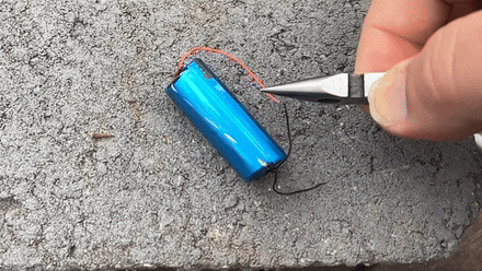

Interestingly in the vape cells, the over current protection is built into the vape cell wire - if you short the battery, the wire will immediately burn through and cut off any more current flow.
In above video you can see when I short out the cell (DO NOT TRY THIS AT HOME) the wire from the vape cell is so thin, it burns out and acts as a fuse to immediately stop current flow.

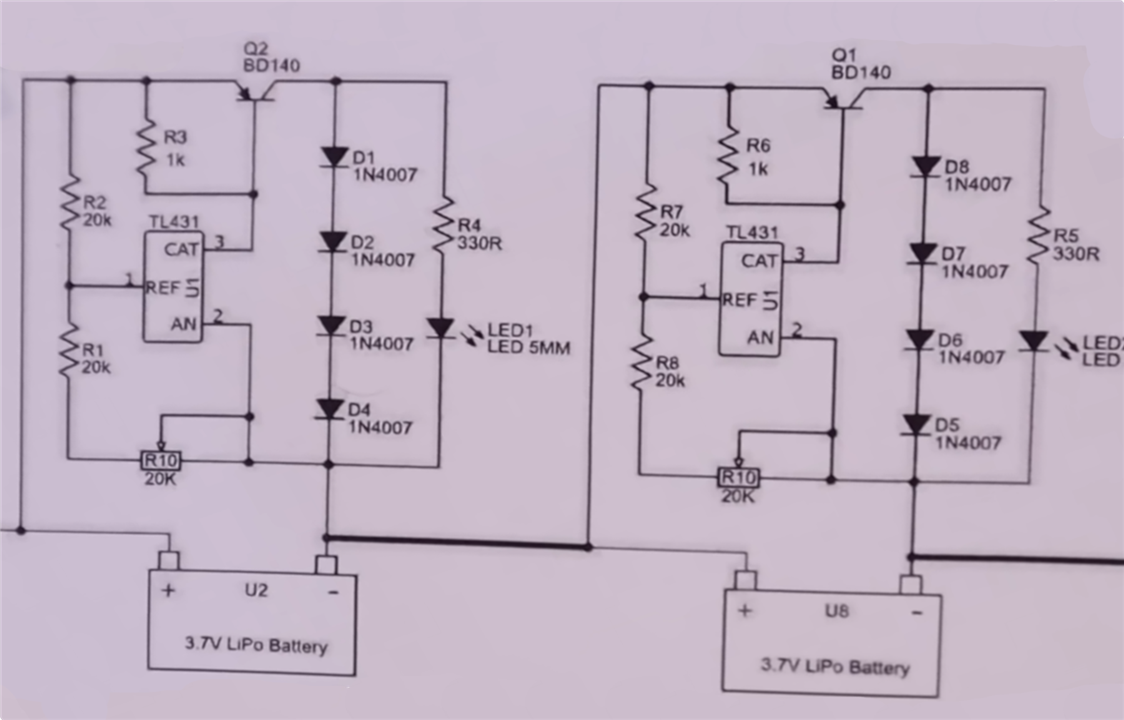

One of the online BMS circuits https://github.com/stuartpittaway/diyBMS allows you to monitor each cell via a web interface powered by ESP8266. Interestingly over charge protection seems not to turn off the charging of the battery but redirecting the extra current into a big 3Ω3 10W resistor, which seems OK for balancing batteries that have been overcharged but seems like overkill to have that per battery, a resistor the size of a battery just to charge it? an informative overview can be seen in Great Scott’s DIY or Buy segment
Electronoobs also has a hand built BMS. This circuit uses a zener diode to redirect extra current into a load of 4 diodes, again I am not fully sure of this but it does feel wasteful. More can be seen in the video below
Homemade BMS - Balanced LiPo Charger Multiple Cells and Current Limit - Electronoobs

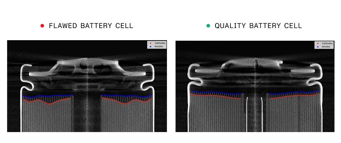

And Adam Savage’s overview of 18650 lithium-Ion batteries with a review from Lumafield’s Battery quality report which seems to sugges that anything other than a branded cell is a ticking time bomb. Their X-ray like technology showing build flaws in batteries
See the full video here:
The Surprising Flaws in 18650 Lithium-Ion Batteries - Adam Savage’s Tested
