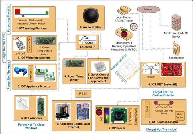

So I got to hear a podcast featuring Dr. C. Defeo and talking about the Challenge. For what I understand, the motivation is to bring out the ideas and creativity of at-home inventors and to bring out new ideas for solving different problems in our live. This really struck the right note and I started to wonder about what I was doing. In teaching, we usually try to assimilate a large amount of information, process it and pass on the correct amount to the students. This is what I do and the result is my student projects now have an IOT focus and one has the Raspberry Pi as a focus. But as a designer I have been spending less time trying to analyze the problem. Recently I have been obsessed with technology and things rather than solving a problem. Hence I decided to revisit my Project Design Problem with the focus of why I am doing what I am doing. Here is a very brief description of the design.
The technology aspect will always be there but I will discuss the function of each module in the given diagram.

I have faced this problem a lot of times that hot foods are left out to cool and then we forget about them. To remedy this, I have a waiting platform so that we leave food utensil on a waiting platform which has the EnOcean Contact sensor. As soon as something is placed on the platform, OpenHAB starts a timer of preset value. When the timer expires, we get an audio visual notification. We can "snooze" this alarm using the EnOcean Rocker Switch and when the utensil is taken off, the alarms are canceled.
The same can be done for other stuff like letting the dog out or medicines for the night or even the garbage to be taken out.

This problem is a bit unique to our country where cooking gas is supplied in cylinders. The gas is by weight which is roughly 30Kg when full and 12Kg when empty. The task is to make sense the weight and plot it for two functions.
1. Generate alerts if we are about to run out- It takes a week to get a refill.
2. See how long it lasts and find trends and see if we can optimize usage.

We dry our clothes outside and sudden winds or rain will cause a lot of problems- use your imagination. The solution is to automate the retrieval of clothes by means of a mechanical pulley system. (I have put this as a part of the Backyard challenge as well but this is the most delayed part throughout). There are actually two parts to this module.
1. The first is the MET which measures the rain and wind speeds.

When raining, we need to close the windows. The above mentioned met system tell us about wind and rain and OpenHAB generates alerts on the basis of whether the windows are open or not. Not much to do here. I used enOcean contacts and works out of the box

So we already left the house and our system is telling us that we left the AC on. Now what? The simple thing would be to use RF based power sockets but for something that draws upto 8Amps this is not a good option. The alternative solution is to use the IR remote and connect it to openhab and make it an IOT device. An IOT IR Remote

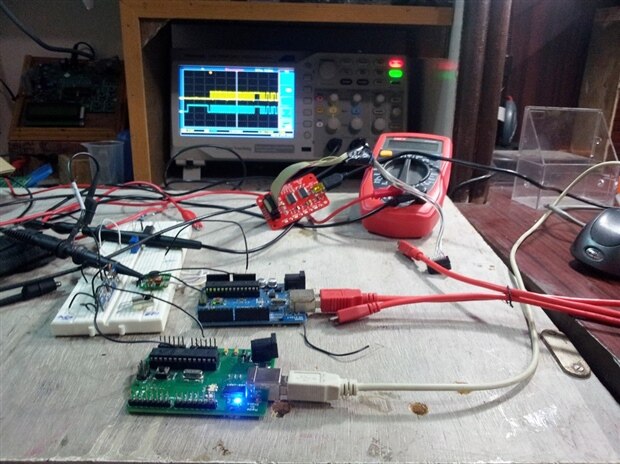

I already posted about this last week. I used Arduino with an ethernet shield that I got from E14 and connected it to OpenHAB via MQTT. I also used the Tek Scope to capture the IR signal and convert it into a lookup table via Excel sheets. I am now able to replay the signals via OpenHAB. The casing remains.

There are times when sensors won't do and we need to 'look' at whats going on. My grandpa is a 92 yr old man with no memory who does not sleep much so I need to have a way to peek into his room at night without disturbing him. I may also feel like looking around to see if his water and other things are in place or not. I use the RPi and an RPi CAm as a remote camera but thought it would be nice to convert that into a rover so it can move around. The robot will be able to charge wireless - ly using the kit I already have.
