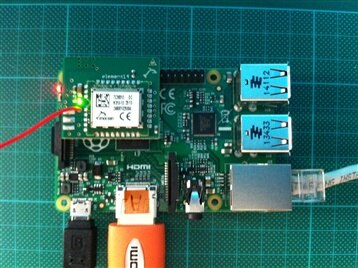

Once that was done, I powered off the Pi and connected the EnOceanPi module before powering on again.

malakai's EnOcean review provided a few simple commands to set everything up:

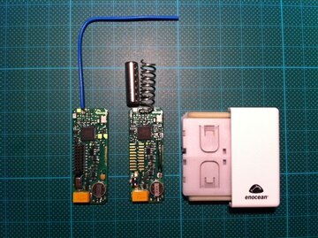

Sensor IDs
To be able to use the sensors in openHAB, their unique ID is required.
To do this, I've installed FHEM, which auto-detects the IDs, wrote them down and disabled FHEM again.
Installing and using FHEM is also covered in the Road Test review linked earlier.
I haven't found an easier way to do this (yet).

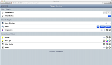

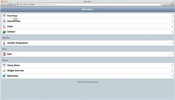

With the demo installed and started, I crossed my fingers and accessed the OpenHAB interface: http://192.168.0.205:8080/openhab.app?sitemap=demo
It works! The demo is up and running and there are various examples of widgets, multimedia, etc ... to browse:

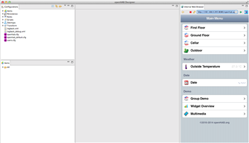

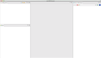

Designer
Next I decided to install the designer on my Mac.
After launching the Designer, the program would just get stuck on the splash screen and nothing would happen.
I Googled a bit a came across this thread: https://code.google.com/p/openhab/issues/detail?id=439
As mentioned in one of the comments, I added a line to my openHAB-Designer.ini file:
-Djava.awt.headless=true
The designer now launches properly.

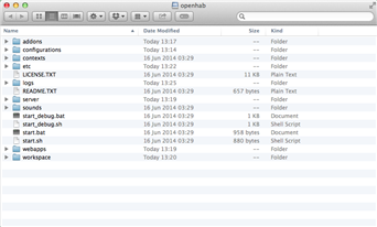

With the designer running on my Mac and the Core running on the Pi, I wanted an easy way to develop and deploy new OpenHAB configurations.
To do that, I defined a password for user "root", installed samba and shared the OpenHAB folder.

pi@webserver /opt/openhab $ sudo smbpasswd -a root
On my Mac, I mounted the shared folder and got access to the OpenHAB installation on the Pi:
From the designer, I could now load the OpenHAB config and access the demo:

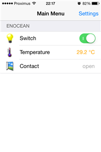

Finally, I installed the OpenHAB app on my smartphone and pointed it to the Raspberry Pi, by:
  • specifying the remote url: http://192.168.0.205:8080/openhab.app
  • setting demo mode to off

With all parts individually set up, I tried combining everything to a working solution.
Following the documentation found at https://github.com/openhab/openhab/wiki/EnOcean-Binding, I configured the serial port of my EnOceanPi in the openhab.cfg:
################################# EnOcean Binding #####################################
# EnOcean USB adapter serial port
enocean:serialPort=/dev/ttyAMA0
After the modification, I restarted OpenHAB and started modifying the demo example to have my EnOcean switch and temperature sensor available.
First, I edited the "demo.items" file to contain the following:
Switch EnOcean_switch_00298B1A {enocean="{id=00:29:8B:1A, eep=F6:02:01, channel=B}"}
Number EnOcean_sensor_01809DC1 "Temperature [%.1f °C]" <temperature> (enocean) {enocean="{id=01:80:9D:C1, eep=A5:02:05, parameter=TEMPERATURE}"}
Contact EnOcean_sensor_0180878B "Contact [MAP(en.map):%s]" <contact> (enocean) {enocean="{id=01:80:87:8B, eep=D5:00:01, parameter=CONTACT_STATE"}
I continued by updating the "demo.sitemap" to only visualise those three items:
sitemap demo label="Main Menu"
 Frame label="EnOcean" {
  Switch item=EnOcean_switch_00298B1A label="Switch"
  Text item=EnOcean_sensor_01809DC1 valuecolor=[>25="orange",>15="green",>5="orange",<=5="blue"]
  Text item=EnOcean_sensor_0180878B
With everything configured, I started clicking my EnOcean switch like a madman. Nothing happened.
After searching for quite some time, I found I needed to make a modification to the OpenHAB "start.sh" script in order to recognise the serial port.
I edited "start.sh" as mentioned in this thread: https://groups.google.com/forum/#!searchin/openhab/enocean/openhab/8GtLqJAffcI/zJ1DGF95XOsJ
-Dgnu.io.rxtx.SerialPorts=/dev/ttyAMA0
Restarted OpenHAB and guess what? It worked!
