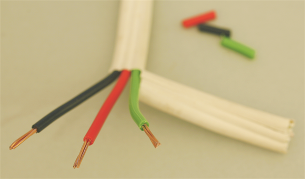

The basic premise of electrical safety is to prevent unintentional contact with voltages exceeding 50V ac or 120V DC.
In order to achieve that, cables that are exposed to contact must have double insulation.
          Photo source Wikipedia  Thermoplastic-sheathed cable - Wikipedia, the free encyclopedia
The picture above shows 2 core  + earth TPS where the wires contain the first layer of insulation and the TPS Sheath the second.
This cable is generally used for fixed wiring (ie inside the wall cavities and in the roof space, etc), and may have a single strand if the size is smaller.

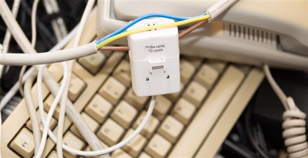

For this challenge some may be wanting to measure the current used by an appliance, and some practices are NOT SAFE.
Generally the outer insulation is removed, and a measuring device is fitted around the cable, which might be rated (or not) for mains voltages.
This was done by a professional for the purposes of testing AND SHOULD NOT BE USED as a normal practice.
Photo source http://goughlui.com/?p=5184image

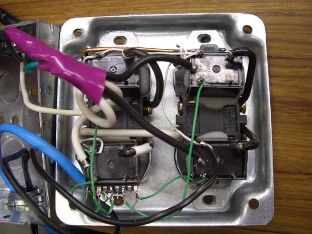

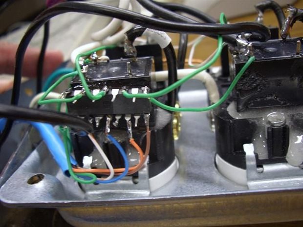

Placing this arrangement inside an enclosure is marginally better, but the cable leaving the Current Transformer is unlikely to be mains rated and therefore should be 50mm away from cables carrying mains voltages.
Something this person clearly didn't understand when wiring this Death Trap.
  Photo credit ...someone with a death wish

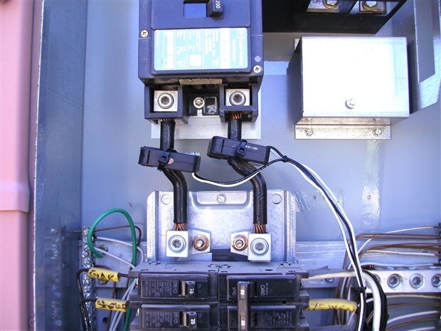

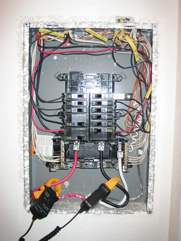

Switchboards
There is also a requirement that cabling within a switchboard is suitably rated and because of the 50mm distance, these are not safe.
The photo source is american and the laws may allow this in a domestic situation, but it isn't legal here or Australia.
While the CT may be rated, the cables aren't double insulated BUT could have been sleeved to make this 100% safe.
These clamps may be rated (and of good quality), the cables aren't and the 50mm spacing is compromised, .... especially when you read that he shoves them in to put the cover on.
The exposure on the outside is plain wrong and because of this I'm not crediting the source.

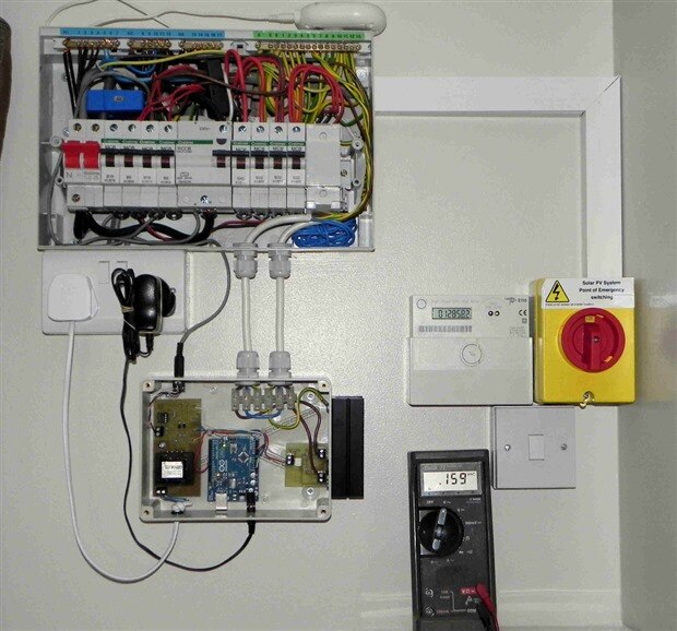

This project is on the OpenEnergyMonitor website and was copied by one of our local members, until we pointed out that the CT cable needed sleeving as it exited the switchboard.
This is a good example where most of the bits are right, but a little more makes it 100% safe.
Photo source http://openenergymonitor.org/
A cable clamp (rather than a knot) on the mains cable on the bottom left wouldn't hurt either, but top marks for putting it inside a plastic case to prevent contact by others.

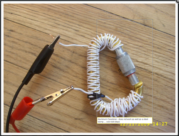

Really DUMB
This person deserves entry into the Darwin awards.
Not only has he put together something that is dangerous, his comments about why it doesn't work so well shows he has little understanding of what he's doing.
He did have this warning, BUT he should have wrapped the metal bit FIRST then added wire that was mains rated.

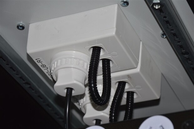

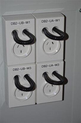

Show me a SAFE way
The only safe way to measure mains currents is by observing the double insulation requirements.

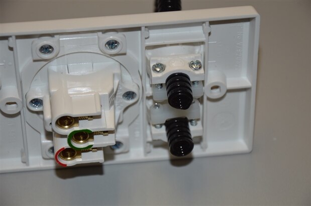

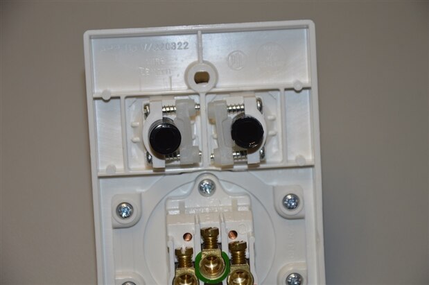

At work we had a need to easily measure the currents in our racks, and one of our electricians put together this.
This consists of a normal socket outlet (we use the screw retainer) with two cord clamp modules.
A piece of 10mm mains rated sleeving is clamped and forms a U shape that allows any size clamp meter to be applied.
The neutral wire to the outlet is fed through the loop, before terminating on the socket.
This provides a safe means to measure the current (since the phase and neutral currents SHOULD be the same) and therefore any current meter or CT could be used.
The use of the neutral wire also means if something went horribly wrong, the voltage potential above earth is minimal/zero.

    Show me a SAFE way The only safe way to measure mains currents is by observing the double insulation requirements. I like the simplicity of your professional solution a real neat and relatively safe way…
    mcb1 over 9 years ago in reply to pmh +1
    pmh While not disagreeing with the broken neutral, the device would also fail to work, so there will be no neutral or phase current. Hopefully someone would be establishing the lack of power, rather than…
    pmh
    Hopefully someone would be establishing the lack of power, rather than trying to measure the current.
    You do raise a point but I think you need to view it in the context of the whole section about "Show me a safer way".
    The use of the mains rated sleeve provided the secondary insulation, so any contact would need a double failure.
    Thanks for viewing and your comment.
    Mains safety is important.
  • pmh
    pmh over 9 years ago
    Show me a SAFE way
    I like the simplicity of your professional solution a real neat and relatively safe way of doing it.
    However your concluding comment of The use of the neutral wire also means if something went horribly wrong, the voltage potential above earth is minimal/zero.
    is not strictly correct and could lull some people  into a false sense of security. If the neutral is broken on the feed side that loop becomes live - albeit  fed through the load.
    I do not doubt that you and many other others understand that, but perhaps an edit would be advisable.  You only have to look at the bad practices shown above to understand how Darwinian some people are!
