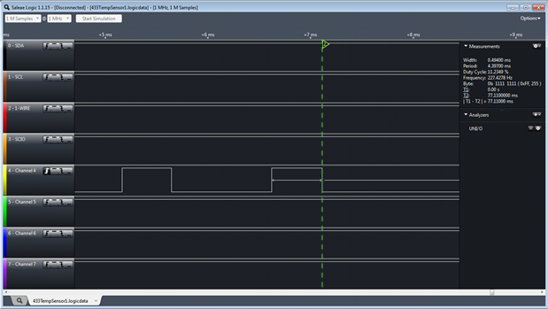

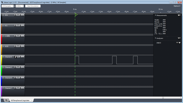

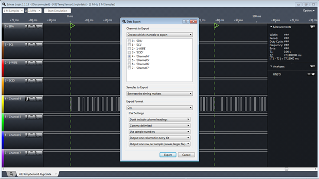

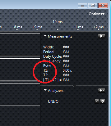

The page talks about exporting a single packet using the T1 and T2 markers.
The idea is to pick the start point and expand the window by scrolling the mouse.
Click on T1
and then drag the green broken line across to the first transition.
If you bring the mouse down to the transition it will snap to it.
repeat for the T2 set point
     The images above don't show the mouse pointer, but you can see the time measurement comes up when you are over the transition
Finally you need to export each of the packets
I used Packet1.csv through to Packet7.csv

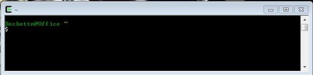

After trolling through various suggestions about using this script or these multiline commands, I discovered Cygwin.
An Installation later and I now had the abilty to use a Linux type shell.
Some of you may be thinking "Why didn't he use the Raspberry Pi", and its a good question.
I wanted something that I could use wherever and with whatever, since it looks like this will be useful for other things along with GNUplot.
Cygwin
This opens as a dos style window, but the cut and paste from other windows doesn't work, which means typing in full.
While its designed for windows, it seems to dislike the absolute pathing style C:/abc/xyz and resorting to the linux style of ./abc/xyz didn't work either.
A few other attempts to find where you were didn't help either so for anyone following it is under the install/home/user directory.

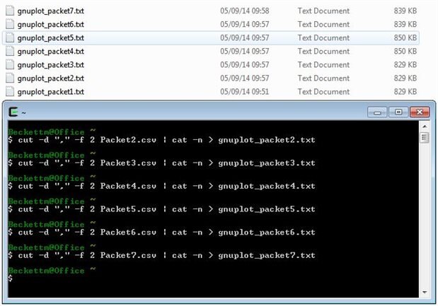

I copied the data files into the directory and then executed the command
cut -d "," -f 2 Packet1.csv | cat -n gnuplot_packet1.txt
where the Packet1.csv is the fileneame for the csv export from Saleae and gnuplot_packet1.txt is the file it will create.
One advantage of naming files with a number on the end is you press the up arrow and then change the number and press enter.
The resulting files are shown above, and as you can see they aren't exactly small considering the are basically two numbers.

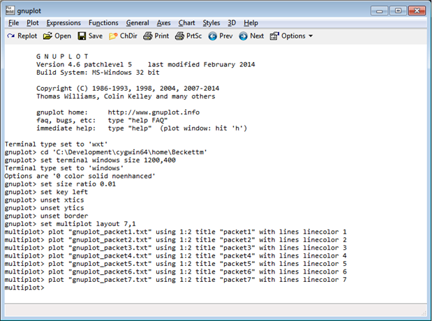

The next step is plotting the data, and there are few minor differences when you are using windows.
You need to set the directory, and you can use the icon at the top ChDir, which opens as a normal window style dialogue to select your data directory.
(In my case its the cygwin home directory)

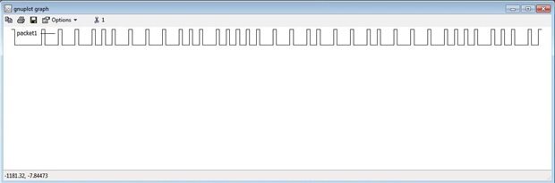

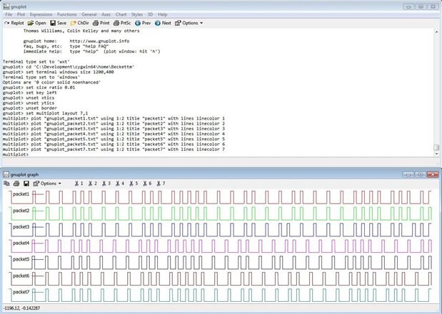

You need to set the terminal to "windows" with the command
set terminal windows size 1200,400
The rest of the commands work and set various things that are probably documented ... but hey this works so why read it.
I had 7 packets so you need to set this correctly
set multiplot layout 7,1
Once you enter the multiplot command a second window pops up, and after you enter the plot xxxx it populates with the data.
The result of all 7 data files.

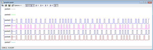

What I was interested in was some comparisons

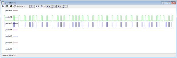

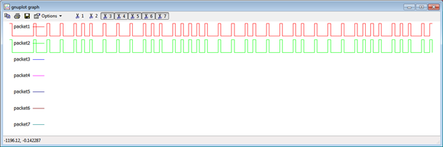

You can turn off the various plot lines using the little sissor icons
(sorry they don't rearrange), but this alone helps remove the clutter.
This shows packet 1 and 2 are the same
However packet 2 and packet 3 have differences
Packet 3 byte 24 is extra while the one between 34 and 35 is missing.
Packet 4 has a slight timing change, but you can start seeing differences in each packet.
