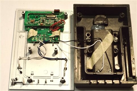

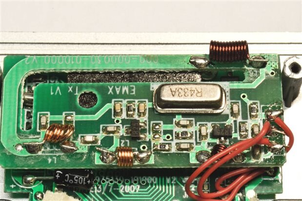

I recall that this was in the bargain bin, but there were no markings or note saying why (or I'd lost it years ago).
When I opened it up, I was pleasantly surprised how much effort had been made to prevent moisture ingress, and that it included a Humidity sensor.
As the picture shows the RF unit was a separate device, and features a pcb aerial and some matching to ensure the reduced length is correctly tuned.
That looked promising, so time to see if there was data.

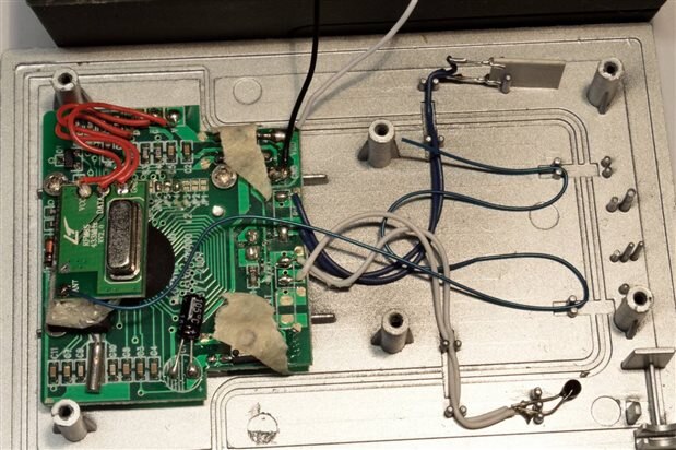

          Always nice to see the manufacturer label the connections.

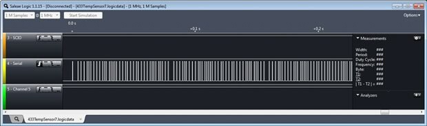

Since I had a few spare minutes at work I captured it with the logic analyser.
The above picture shows there is data going out to the transmitter.image

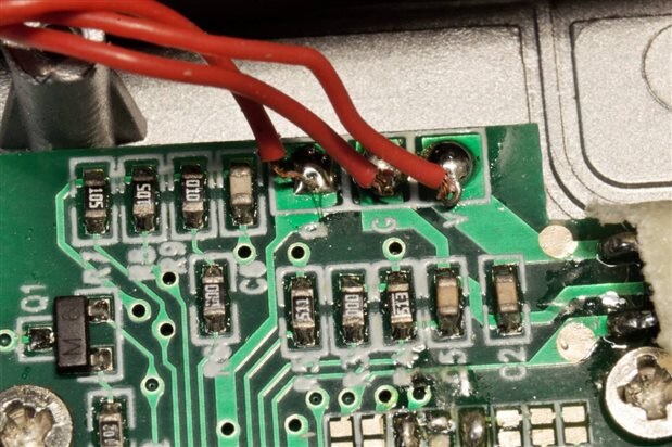

It will require some working out the protocol, but in the meantime it needs to be sent out so it can be used.

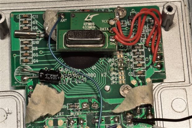

The picture shows one of the loading coils damaged and various soldering on other parts.
Luckily my order of 10 x RFM85 transmitters arrived this morning from Anarduino
A quick replacement and tidy of the wires had the transmitter replaced.
The last one was held on with some double sided tape and foam, so that would do for now.
These Tx units don't have a aerial, and the required length is 170mm for a 1/4 wave whip.
A length of wire was added but it needed to be carefully placed around the inside, to ensure the seal was not comprimised.
Ideally this should be a straight wire, since the RF standing wave generated along the antenna interacts with the magnetic field .. but that's another subject and another blog. image

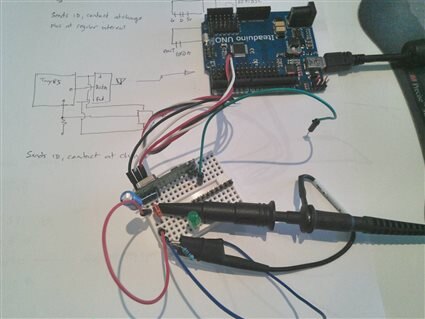

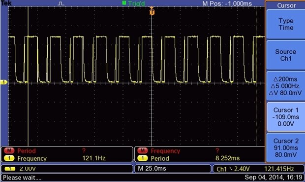

I connected the receiver up, connected the logic analyser to the receiver output and was surprised that it was capturing rubbish.
It was so bad and random I didn't bother capturing it.
It seems that something was either sending 433MHz data or some other frequency was being picked up.
Shorting out the antenna made no difference, and since there is no other pins to trigger the analyser off, it was end game until I got home.

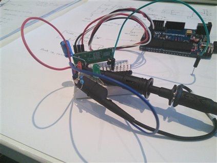

     images from Nexus 7  ... despite the 5MP you can't control the ISO so the images get grainy ...
When the scope was added, it became clearer what was causing the trigger seen on the logic analyser.
A regular pattern showed.
The cursor is looking at 10 cycles (the second cursor seems to have become a dotted line) and there is 200mS between Cursor 1 and Cursor 2 as indicated by the Δ200ms and the Δ5Hz.
200mS/10 = 20mS
Freq (Hz) = 1/ time  therefore  freq = 1/20mS or 1/ 0.020  = 50Hz which is our mains frequency.
Despite isolating the computer by running the receiver on battery, and adding a capacitor in the scope earth, it still remained.

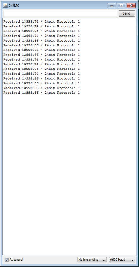

  Simple example for receiving
  http://code.google.com/p/rc-switch/
#include <RCSwitch.h>
RCSwitch mySwitch = RCSwitch();
void setup() {
  Serial.begin(9600);
  mySwitch.enableReceive(0);  // Receiver on inerrupt 0 => that is pin #2
void loop() {
  if (mySwitch.available()) {
    int value = mySwitch.getReceivedValue();
    if (value == 0) {
      Serial.print("Unknown encoding");
    } else {
      Serial.print("Received ");
      Serial.print( mySwitch.getReceivedValue() );
      Serial.print(" / ");
      Serial.print( mySwitch.getReceivedBitlength() );
      Serial.print("bit ");
      Serial.print("Protocol: ");
      Serial.println( mySwitch.getReceivedProtocol() );
    mySwitch.resetAvailable();
The data pulses showed up as I expected, and the Arduino quite happily decoded it.
So for now this is how it will be, and I'll use the raw data sent out to the transmitter to do the decoding.
