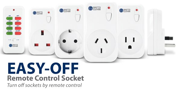

RF Controlled Outlets
I have used these RF controlled outlets before.
photo source www.wattsclever.com (showing the later version)
They feature a programmable code, come in a variety of styles to suit different countries .... and they have very good instructions.
When I first ran across them, I thought I was going to have to hack the remote (the magazine publisher commented ...'finally some real hacking' ... or words to that effect), but a little digging and I found these guys already had the code sorted, and produced a library to use with Arduino and now Raspberry Pi.

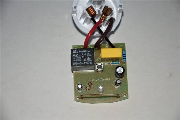

So I spent some time checking the internals.
This is the inside of the simple version.
This shows that pesky IC with no markings. image
So not really a lot of room to add extra hardware.

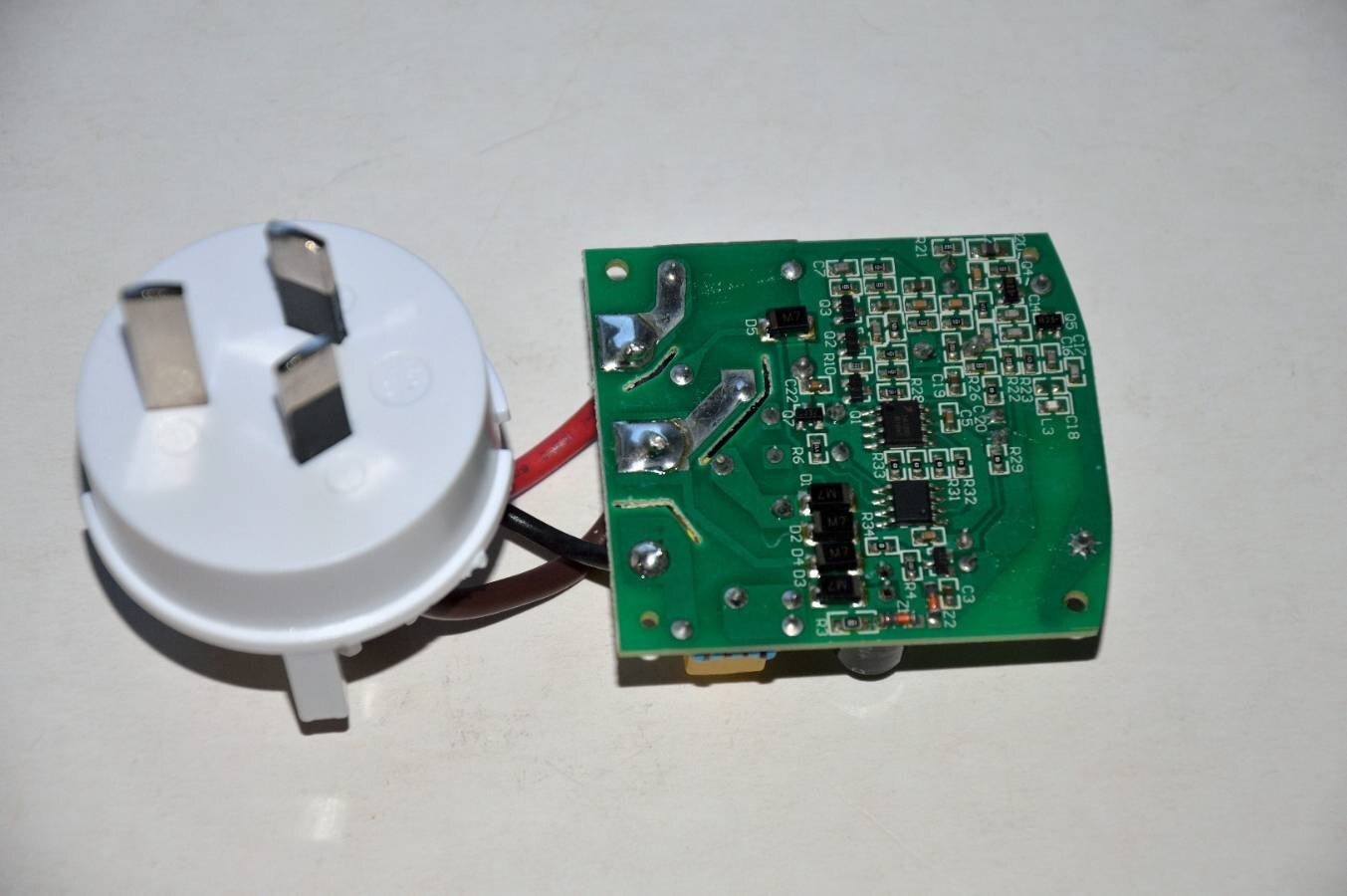

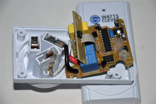

The antenna seems to dominate the upper area, but much more space.
The underside shows a few more parts, but of more importance is the cut in the board to ensure the mains voltage can't track across the surface to the low voltage side.
The device is double insulated so no-one can come in contact with anything, but its nice to see they have gone the extra mile with safety.
I couldn't get this one to work with the RCswitch code ... however the nice Tektronix Oscilloscope coming will probably help resolve that. image

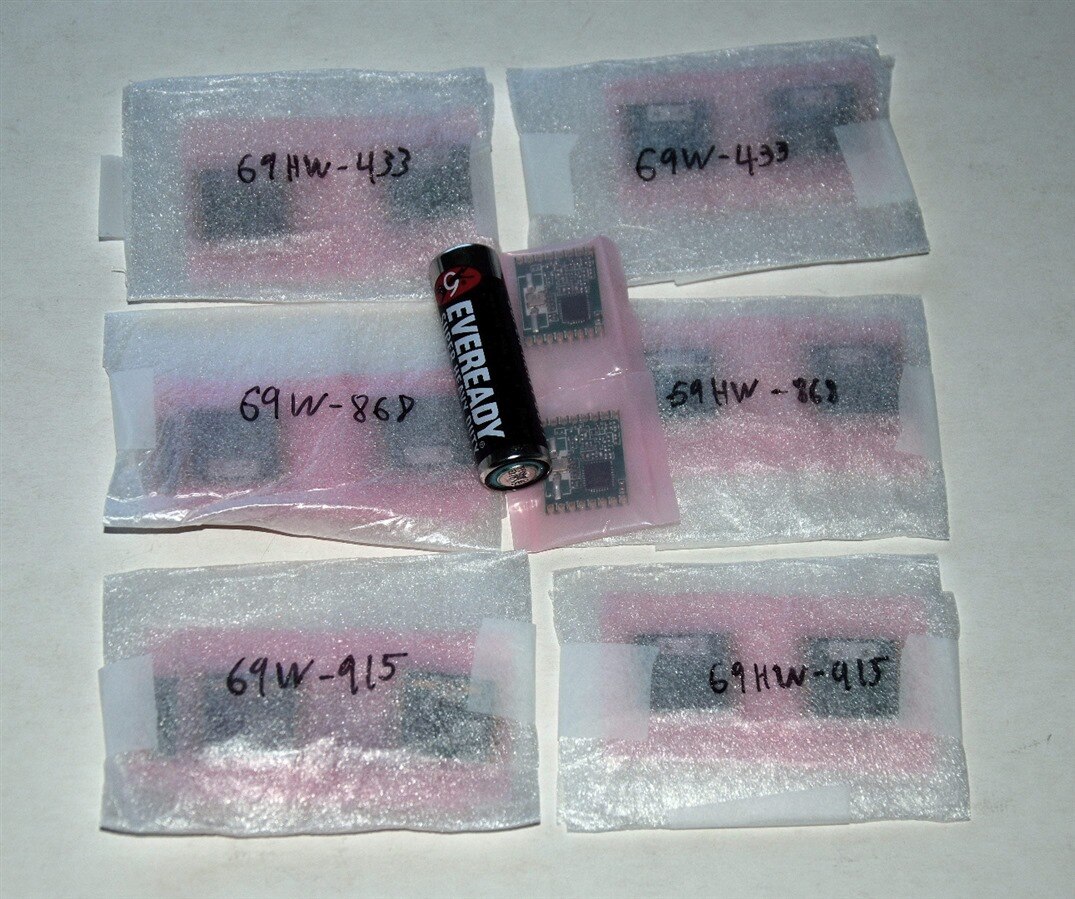

RF Transceivers
Thanks to EricTsai   electronichamsters
( Inexpensive & Flexible Home Automation / Wireless Sensors )
I ordered a few (well 18 actually) RFM69xx modules, in varying frequencies.
As you can see by the picture below they are very small.
RFM69xx next to a AA battery.
Shortly my Rural delivery driver is going to get sick of coming up the drive for a signature, but unlike Xmas I can order what I want.

    Nice pics.
    Either the LED or the pin driving the transistor that switches the relay should work.
    The biggest thing might be to ensure the receiver doesn't end up throwing its toys out when you send the reply.
    I'd be leaving an output that goes high when its transmitting to allow another transistor across the data input pin.
    These should be able to run on 24v DC (and lower without the relay), so NEVER be tempted to work on them live.!

    Here are some pictures of the guts of my Elros:
    There seems to be enough room to cram an additional circuit in there. I'm thinking of an ATtiny with 433MHz transmitter.
    And to probe whether the socket is on or off, the LED pin could be used (LED is on when socket is on and off when socket is off).
