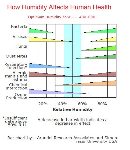

WHY
Many New Zealand homes are not double glazed having been built when a fireplace was standard, along with wooden windows, they didn't really figure in a build.
Many homes have had the wooden window frames replaced with Aluminium (because you don't need to paint them says the salesman), but the single glazing remained.
When fireplaces became a dirty word, drafts seemed to matter so reducing them results in more moisture being trapped, hence condensation on the coldest surface (the window) shows up.
The older radiant heaters with the glowing wire were great for drying the air, but these tend to present other problems and eventually got phased out.
There are energy savings and health benefits to be gained by keeping the house dry.
This website this chart came from is promoting a commercial solution, but does detail some alternative or passive methods.
          graph source Humidity and Human Health

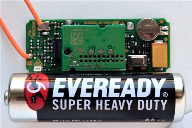

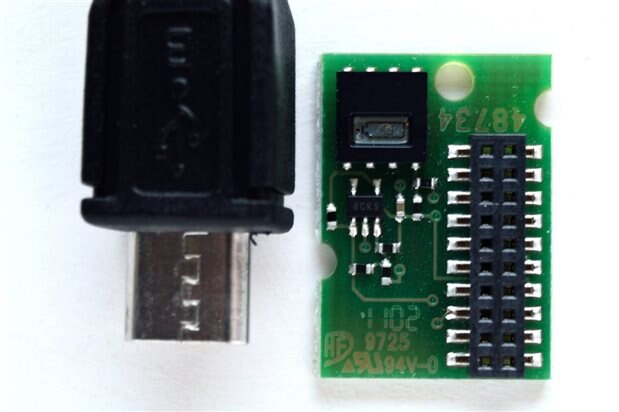

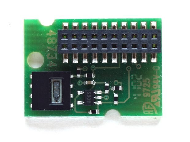

Hardware
I have seen the brochure and the picture. I even downloaded the mechanical drawings, but I wasn't ready for the size.
          photo source me, myself and I
The business end is on the lower left and the second photo shows it against a Micro USB  (yes the same one that fits the Raspberry Pi)
I did have to consult the mechanical drawings to find which way around these should go.
There is no markings, and the STM3xx manuals say consult the HSM100 documents which don't say either (note to Enocean to include in the next version)
So for this who don't read manuals ..here it is mounted, next to my favourite universal sizer ...an AA battery.
Of course I had left it charging while I went and did other things, so when you press the button it flashes the led but with nothing to receive it ...
So until some more bits turn up.
PS the rural delivery this morning left a big package ...scope, Programmer and RPi    ...its like Xmas.

    mcb1 over 12 years ago in reply to shabaz
    The issue of asthma triggers is a large subject.
    I get it with dust (not windblown soil) but the household variety, so I presume it's the dust mites.
    My daughter can get it as well, and when we moved into our new house 11 years ago we didn't have wall to wall carpet, and despite the varying weather it never showed up.
    After a couple of years of having carpet it started presenting itself.
    The solution was to remove the head from the vacuum cleaner and using the hose pipe, vacuum around the outer edges of the carpet and other places where the dust accumulates, but is not adequately removed with the vacuum cleaner.
    This resolved the problem.
    Now whether high humidity encourages these to multiply or there is another reason, I'm not sure.
    I wouldn't think the high humidity results in more skin particles, but the saving in energy costs is the bigger winner by reducing the humidity.
    The opposite end of the scale is where we have trouble at work, below 40% and static starts becoming a nuisance.
    shabaz over 12 years ago
    It's an interesting chart!
    So there is a fine line between dodging respiratory infection versus dust mites. A dilemma image
    What is really interesting is seeing that the effects of asthma are least at a certain humidity level on the chart. A different website mentions an interaction with temperature and humidity combined (but has no charts of data), so I can imagine it is tricky for people to know where they are on the humidity-temperature combination scale on different days. So your project can be extremely useful for asthma sufferers too.
