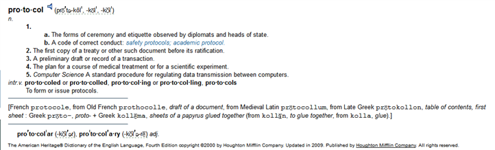

This post I want to discuss what a protocol is and decide on what I will use.
What is a Protocol
The simple explanation is a defined method of communicating.
