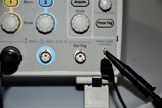

Probes
The first thing anyone should do is check the probes are calibrated and showing a nice square wave.
You can press the "Probe check button" which states "The feature of probe check is not ready" ... well I was what do you mean.?
You'll need to press "Do Self Cal" which asks you to remove the probes  .. so that's strange.
Once you've let it do its thing connect the probe to the probe comp connection on the bottom right, and check for a nice square wave.
One thing that really surprises me is the noise that is present on the waveform.
I was expecting a 5v calibration signal to be clean, and noise free.
It doesn't get worse as you change the range, so I guess that its the quantising noise of the front end.
I have to admit I'm used to analogue scopes, so knobs and buttons that are slow to respond are new to me.
Sure this has lots of features my very old Hitachi 50Mhz scope doesn't, but it will take a while to get used to it.
