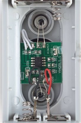

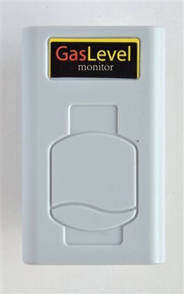

While I was purchasing some products in a local electronics retailer, I spotted this.
http://www.jaycar.co.nz/productView.asp?ID=QM1662&CATID=97&form=CAT2&SUBCATID=946#1
I knew Inderpreet  ipv1  was looking at measuring his LPG tank, and because this was so cheap, I had to buy it.
I've done nothing more than opened it and take the photos. (click on them for full size)

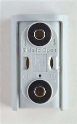

The unit takes AA batteries , and the metallic portion on the rear is magnetic.

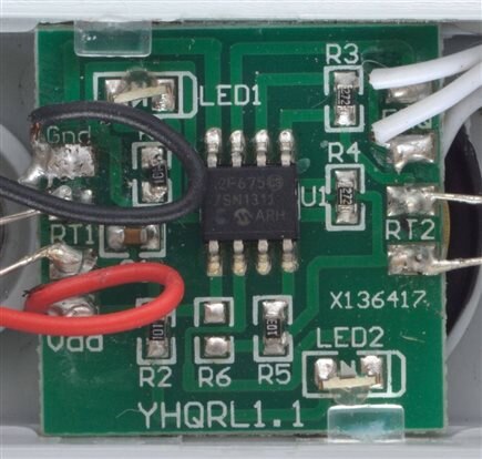

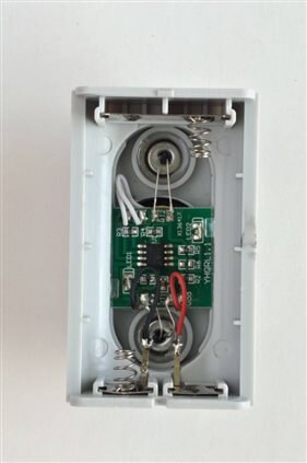

A closer look inside
It appears to have a PIC 12F675 chip which drive the two ultrasonic transducers and then the LED's and speaker when the level is low.
Just what R6 does is anyone's guess.
