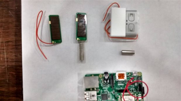

I am very excited, as I have received Enocean-Pi and sensors on starting of this week.. and Android application is now possible because I have bought new Android cellphone that supports openHAB android app .image

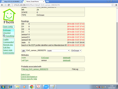

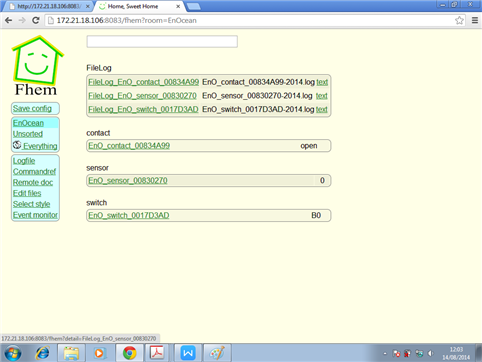

I have done with installing FHEM on my Pi by help of post http://www.element14.com/community/roadTestReviews/1795...thanks to malakai2112 for finding sensor’s ID.
I have all my sensors working out of the box .. PTM210 switch works fine, But temperature sensor and reed contact sensor not working properly.. Once it works and then stops working after say half hour again they work once or twice but then stops working.
sensor starts working properly after keeping them in normal room light for a two days.
here is My Initial thoughts on Enocean Sensors..

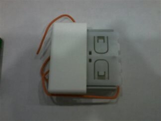

PTM210: in this Push button sensor there are two switch A and B both works fine, but I don’t know why Enocean provided only one rocker.
Here is video of my working PTM210 Push button sensor...

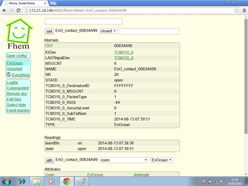

STM320 : Reed Contact switch works just fine and I am trying to hack this for allow to work it with other circuit.

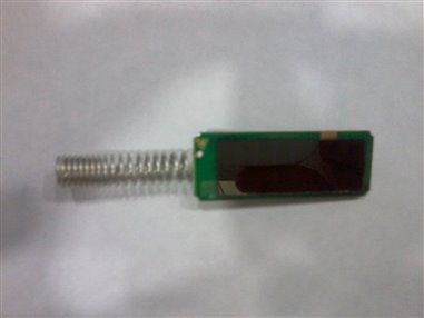

STM330 : Temperature sensor also works but temperature is not accurate and I am working on this. on FHEM it shows D0,D1,D2,D3 digital signal and
Sensor 1, Sensor2, Sensor3 analog signals. If I will be able to use this signals without any firmware changes on STM330 it will be great and I am exploring this possibility.

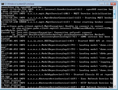

Mean while, Here are the Steps for creating Home WiFi Network without router (openHAB running on my Windows laptop)
  • Start Hotspot from your android phone (settings ---> Wireless and Network Setting ---> Tethering and Portable hotspots ----> Portable WiFi HotSpot -- > check)
  • Currently, I am not using any security but you can set it by (settings ---> Wireless and Network Setting ---> Tethering and Portable hotspots ----> Portable WiFi HotSpot setting-- > configure wifi hot spot ---> security ---> set password )
  • Now you will be able to see this hotspot on your windows network and sharing options, name for my hotspot is “my router”.
  • Connect to your hotspot and set it as home network.
  • On command prompt fire “ipconfig” command to know IP address assigned to your PC/laptop.In my case it is “192.168.43.8” it is your localhost now for openHAB server.
  • Run start.bat from openHAB installation folder.
  • Now setup done image connect any laptop/tablet/cellphone to this hotspot you will be able to access openHAB server running on Windows using this url http://192.168.43.8:8080/openhab.app?sitemap=demo
