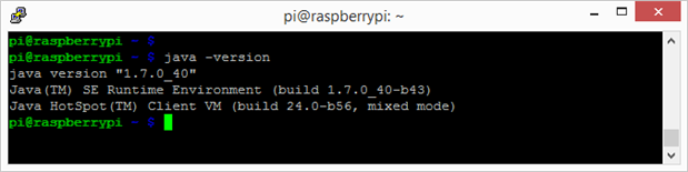

Java Check
If you are running Raspbian, java is already pre-installed.
Check this by running java -version
