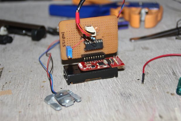

Step 2: Prototype and test
The next step is to put it on a PCB. I used a general purpose PCB for now. The reason for not making a dedicated PCB is that I don't have the time right now. I will be sending one to Oshpark soon though. Another thing is that I will be adding onboard controller and a different rf module. A major reason for using the cc2500 is because I have the kit. The base station has USB to serial converter which works out of the box for the RPI... I tested that first. I got FTDIs which I will interface to the custom rf module but much later.
So the first part is the amplifier circuit. The next part is switching it on and off. I will be using the irf530 MOSFET because that's what I have lying around. I did a spice simulation to test it. The threshold voltage is around 2.2v which is less than the 3v power supply.  I have some more breadboard testing to do on this so I wont put it on my first prototype. The pins are brought out for the loadcell and battery. The last part is the microcontroller. Since I am using the kit module I have a female row connector right now. For my final solution I will have the msp430 onboard.
The final circuit looks like this.
I did spend 2 days or I should wasted two days on the analog part with a stupid problem which caused my output to jump around a lot. But I did get it to stabilize and got the system setup. It worked!

The final PCB and the mount.
I am a bit behind on the fabrication part and the way to hang the cylinder is bit of a challenge. The LPG cylinder is potentially explosive and I don't want to rush it. I have an idea but will have to try it before I show it on the blog.
