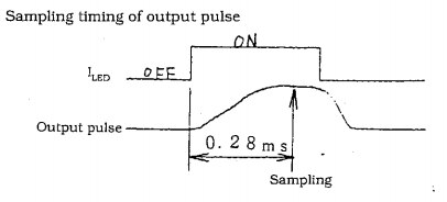

Based on the datasheet information on sampling timing, I made a quick Arduino sketch i order to test the sensor and the circuit.
The resulting sketch is as follows:
int sensorPin = A0;
int sensorValue = 0;
int ledPin = 2;
int delaySampling = 280; // wait 280 us before sampling after turning on LED
int delayLed = 40; // wait 40 us after sampling before turning off LED
int delayCycle = 10000 - delaySampling - delayLed; // 10ms cycle

void loop() {
  digitalWrite(ledPin, LOW); // turn LED on
  delayMicroseconds(delaySampling); // wait before sampling
  sensorValue = analogRead(sensorPin); // sample
  delayMicroseconds(delayLed); // wait before turning LED off
  digitalWrite(ledPin, HIGH); // turn LED off
  delayMicroseconds(delayCycle); // wait for end of cycle
