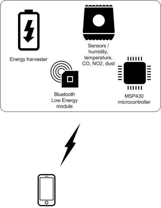

Architecture overview
Figure 1 - System architecture
Sensor

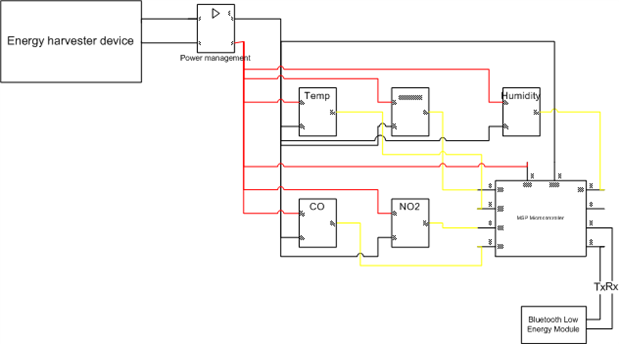

The air quality sensor is made of the following main components
  1. 1.      a low-power microcontroller, like the Texas Instruments MSP430 series microcontroller
  2. 2.      a Bluetooth Low Energy module, like the Texas Instruments LMX5252 module
  3. 3.      a dust sensor module, like the Sharp GP2Y1010AU0F, which features a low power consumption
  4. 4.      a N02 sensor, like the MiCS 2710 NO2 gas Sensor
  5. 5.      a C0 sensor, like the Figaro TGS 2442 CO gas sensor
  6. 6.      a humidity sensor
  7. 7.      a temperature sensor
  8. 8.      a Peltier element for energy harvesting. The use of energy harvesting makes the sensor installation absolutely unobstrusive
Figure 2 - Sensor schematic
Figure 3- Sensor electrical components and connections

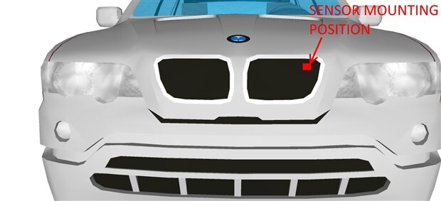

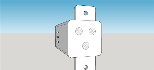

Sensor will be enclose in a box designed to be easily fixed to the radiator grid
Figure 4 - Sensor case rendering
Figure 5 - Mounting position
