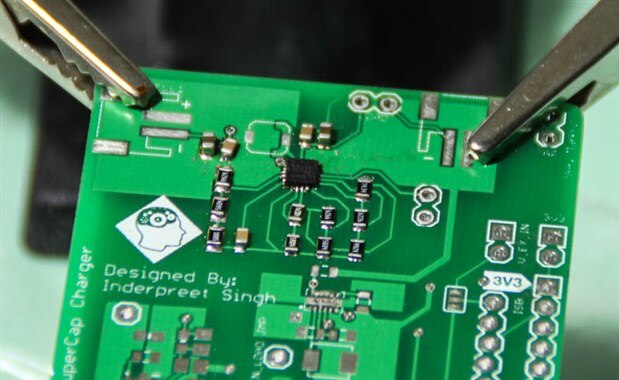

Not a very complicated post just a few pics of the assembly.
I use some flux and copper wire strands and used it to sweep the extra solder out... The above is the result and I check with the DMM to see if any pins were bridged. They weren't image.
I then moved on to solder the rest of the parts and...
Viola! All I need to do is mount the coil and connect the inputs and outputs. This should be fun...

    Your board looks great! Well done. Can you share the resistor values that you used to configure BQ25504?

    I just wanted to make sure I'm using the correct values.
    I was using the provided Excel spreadsheet for calculating resistor values. I'm not using the same values but they are close - I obviously have different voltage levels set.
    Dragan

    ipv1 over 11 years ago in reply to tomaja
    Thanks sir. I did a post and shared the entire schematic
    http://www.element14.com/community/community/design-challenges/in-the-air-design-challenge/blog/2014/12/11/firecracker-analyzer-making-the-power-pcb-with-eagle-ti-bq25504-tps62740-and-tps61200
    Hope this helps...
