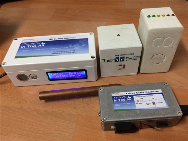

Multisensor box
I have built a box that included many cheap sensors: temperature, humidity, light, sound, air pressure, dust sensor from Sharp and electrochemical CO2 sensor. It was assembled for test of air quality in school during classes and showed that it is important to open the window  during breaks. Probably graphing data is not so essential and it would be enough to just indicate with LEDs if air is good, normal or poor. Two school students wrote their scientific report in physics about air quality sensing and presented it at school. They got promoted to a regional contest.

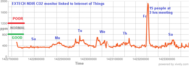

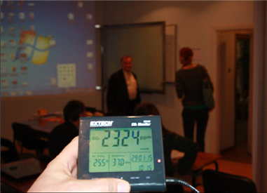

CO2, infrared
Large part of roadtest budget was spent to acquire infrared CO2 detector. That is more precise than electrochemical. I interfaced it to the IoT and measured air quality at office and during meetings. As IoT provider I used Xively, the one that I had learned to use previously. AirVantage seems to be more complicated to get started with.

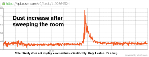

Dust detector, laser based

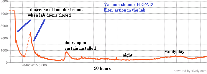

In one blog post  I demonstrated how to set-up Wi-Fi and webcamera on a Beagle Bone Black and it could be used to take pictures of dust flying through a laser beam. Such pictures could be sent to a server for image processing using for example LabVIEW. It appears that we swim in an ocean of dust of up to 50 particles/cm3 beig equivalent to 50 Million in a m3. For humans most dangerous are particles in the 1...10 um size that get stucked in the capillaries of lungs. Only HEPA rated filters can stop small dust. HEPA filter gets visually dark after a month. It is also nice to be able to measure particulate matter content outside the window in the city and not to depend on data from govermental agencies reporting in the newspaper just the average situation.

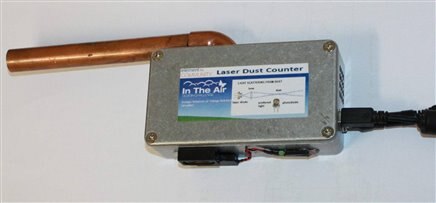

Laser-based dust counter that I constructed using recently available high-power blue diode laser makes it more sensitive for detection of smaller dust. This dust counter helps also my university carier as we got presentation about laser particle counter accepted in EuroNanoForum conference that wiill take place in Riga in June 2015. I was contacted by a nanosensor-on-a-chip company Applied Nanodetectors with offer to collaborate in interfacing their sensors to the IoT.

My former Swedish boss Prof. Sune Svanberg, a great expert in optical atmospheridc pollution measurements, was complaining that the sad thing is that one could only measure pollution, but not actually improve the air. So I am happy that this time could improve the air using HEPA filters. I have now an Electrolux anti-alergy-bag on the air inlet of the lab and sliced plastic film sheets covering the door isle and preventing dusty air to come in. Result is 10-fold decrease of dust content in the room.
In summary, here are all the devices built.
